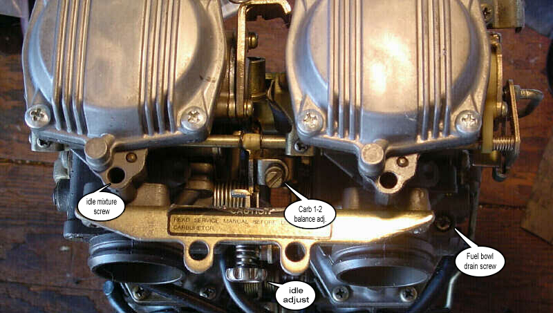

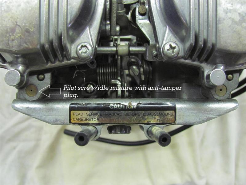

ruff running cutting out
Prairiehammer replied to thunder1295's topic in Venture and Venture Royale Tech Talk ('83 - '93)
The pilot (idle mixture) screws (not to be confused with the pilot jets) are accessible without removing the carbs. -
