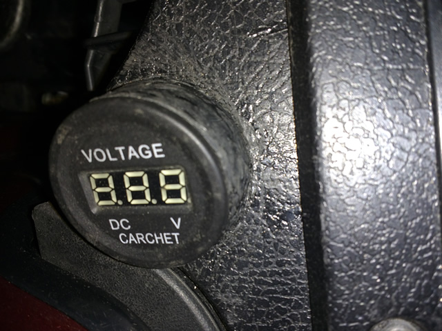

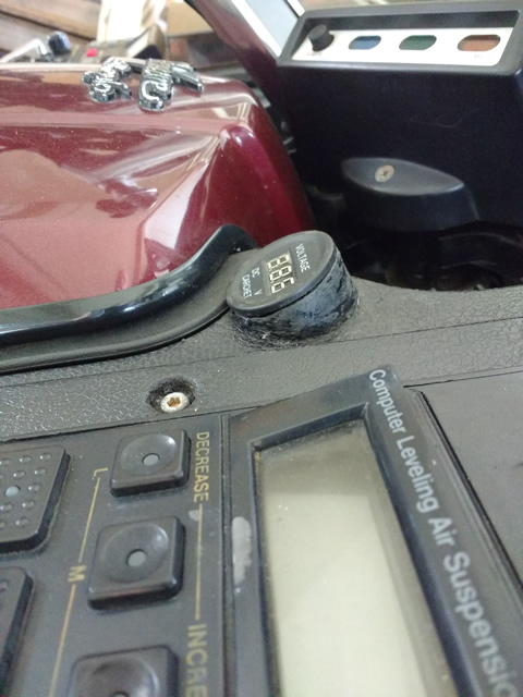

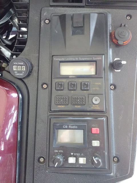

Made a new modification to the layout of the rt dash panel that works much better by switching the power point and the volt meter positions. I'm at a loss as to why this did not leap out at me in the beginning but anyway.... Due to the nature of the LED in the volt meter, it was difficult to see in the sun particularly due to reflection on the white LED lens and also due to the angle of the meter. The first part of the solution was to create a new mount that positioned the meter with a more direct viewing angle. Doing that was quite simple. First thing to do was mask the meter threads and face edge using a cellophane tape such as clear Scotch tape. The translucent type may also work but I'm not certain it is actually cellophane. Also mask the dash panel around the mount hole leaving about 3/16" clear around the hole. It is a good idea to mask any of the surrounding area where an inadvertent slip might gob up other parts. Once masked the meter was placed in the original hole at an angle. Give the perimeter of the hole a dribble of MEK from the needle applicator to soften. Then using a gob of ABS/MEK putty, form it around the exposed meter threads and let it set for a few hours, overnight or for a few days depending on how soft the putty mix is. When the putty has firmed up the meter can be popped out and the masking tape can be removed. Put the meter back in the hole and squirt a little MEK around the base and apply some pressure by hand, holding for 5-10 minutes just to make sure the new bezel is firmly attached to the dash panel. A utility knife and a file can now be used to shape and clean up the new volt meter bezel. The bezel still needs to be polished up a bit but I'm not sure how to go about doing that yet. This is the new panel layout. It's much more useful than before. I have talked quite a bit about the method I use to do plastic repairs so I won't repeat it again here but if anyone has any questions I would be happy to answer them.
