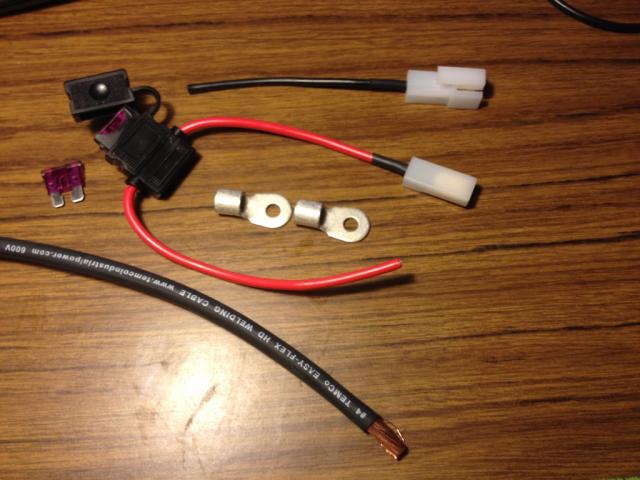

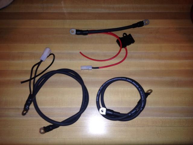

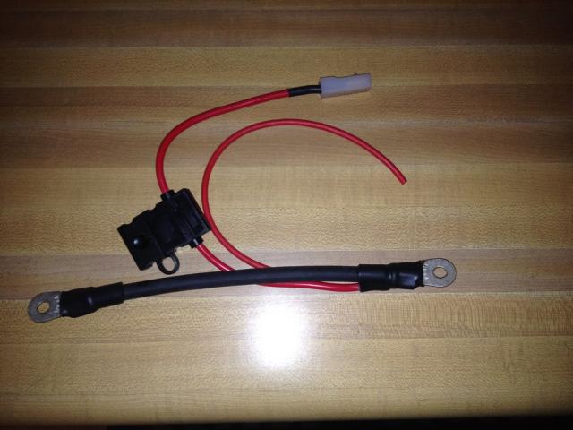

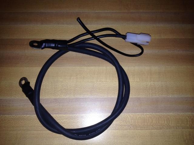

I am making heavy duty 4 gauge sets of 1st gen (83-93) battery cables. Included are three cables, positive battery to solenoid, solenoid to starter and negative battery to ground. 40 amp main fuse, ATC style with 2 fuses furnished (1 spare). Harness leads are 12 gauge wire. The harness terminals have the mating housing that will plug into the existing connectors on the harness. No soldering or cutting required. #4 gauge welding cable, 364 strand copper, EPDM insulation oil & flame resistant, black. -50 deg C to +105 deg C. Silver brazed barrel terminals, tinned electrolytic copper, 1/4" hole on main cables. All connections are crimped and soldered. Main cables are hydraulic crimped. Main cable connections are covered with flame retardant dual wall polyolefin heat shrink, mil spec rated. I could not locate boots for the 6 ring terminal ends. $50 a set includes priority shipping to US address. Other locations will be whatever postage increase costs. (Probably 1st class outside US.) I can add an extra un-fused 14 gauge 12 inch wire if desired to both battery terminals for $2 a set additional. Pictures of completed set attached. Pictures show additional 12 inch lead (optional). Last person that was going to do this was Snaggletooth last year. I have talked to him several times and he is no longer pursuing this. Gary
