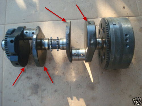

Came across a picture of a crank for a Venture on Ebay, I put some arrows at the points on the crank that I mentioned there could be an interference point. Picture the rods attached, piston is at the bottom of its travel, the piston skirts will be in close proximity to the points I highlighted on crank. Gary
I am not saying the ends of the crank that the rods are attached to are different, it could be that the central part of the crank has been made larger. The possible reason to do this is to increase low end torque of motor. I think this might be a low probability, because I know Yamaha reduced the mass of the rotor (flywheel). I don't see a valid reason to reduce mass at one point of the assembly, then increase it at another. I have an RSV rotor here which I am putting on the Hybrid/RSV/VMax/1st gen project. I know the rotor will fit on the crank of a 1st gen 1300 motor properly. This is tells me that part of the crank machining did not change. (Picture of motor attached for no particular reason). The reason Yamaha would want the crank to have a higher mass on the crank assembly is that higher mass increase low end torque. Lower mass helps the ability of the motor to increase RPM's faster, it's one or the other. The RSV was a heavy touring bike, it needed the low end torque to get it moving smoothly, not the fast ramp up in RPM's. This is just a worst case scenario. You asked if they would fit, I'm not going to say "He!! yes". My day job is a mechanical design engineer, so I am very use to looking at what can go wrong and not standing back and saying "Ship it" Gary
I am not sure if they could be swapped. The rings, wrist pin, circlip & rod's are all same P/N's. The possible issue I see is that the crank is different P/N#, Where this might be an issue is the counterweight throws on the crank "MAY" have been made larger, and the piston skirts reduced in size to clear the counterweights when the piston is at the bottom of the stroke. Other than that, they will fit. Another thing that I just thought of is the top of the piston to the C/L of the wrist pin could be different. If it is shorter, compression would be low. If it is higher, valves will crash into piston. Gary
