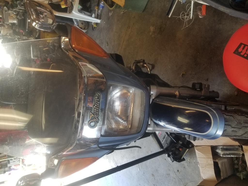

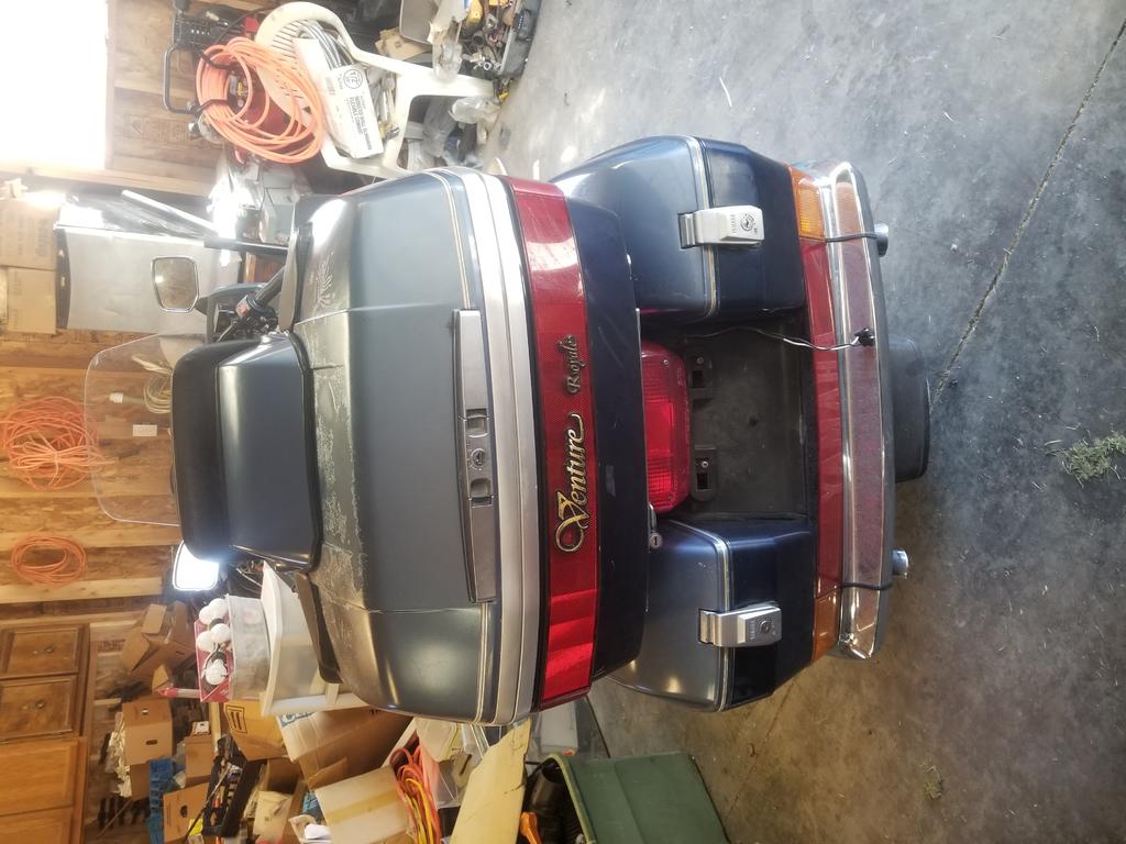

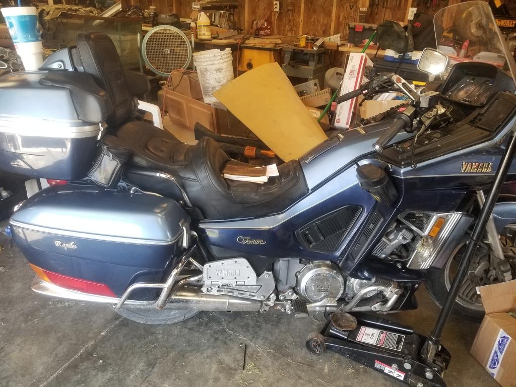

This is the bike katoomer gave away. new parts and all. Thank you Mark this should be a great project. Was surprised no one had beat me to the pucnh Have not decided to leave her a dresser or if she'll become a Rat Bike. I have been wanting something to tinker with for a while. Working on getting all the lights for my '06 TD converted to LED. Then my time devoted to this. Its in awful good shape to strip her down to a bobber but the old head is a reelin.. BTW, dont pay any attention to the remnants of my fathers passing..Im still going thru that mess..lol .
