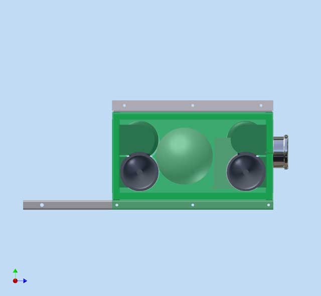

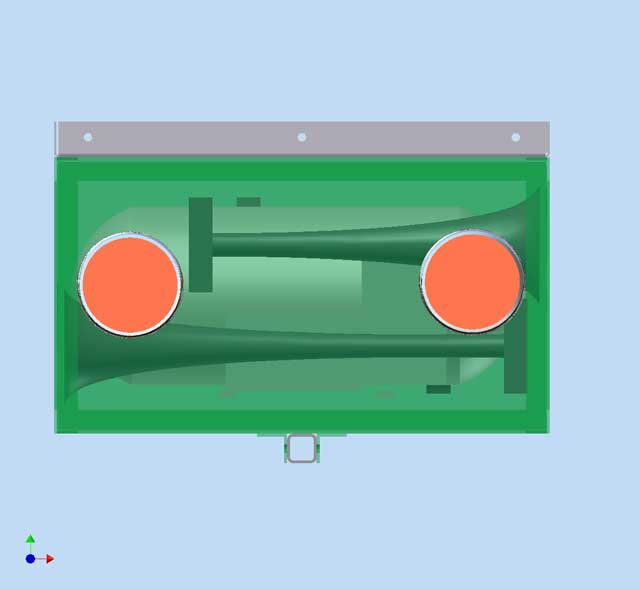

	I was working on a system to add a train horn to my first gen. It would mount into a 1 - 1/4 receiver hitch. I do not know if anyone makes a receiver hitch for the SVTC. This plug in also doubles as a cooler rack for day trips. Since the stinger part bolts on it would be easy to adapt the design to match any receiver hitch
