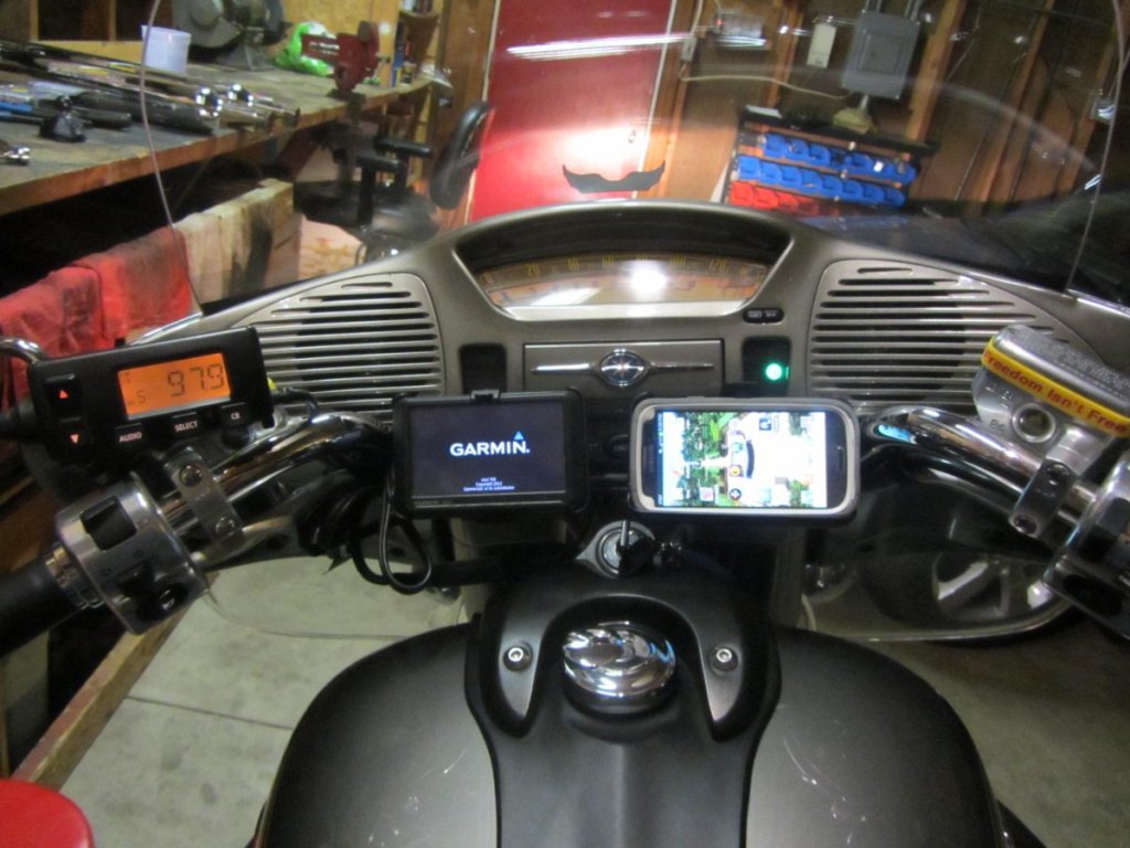

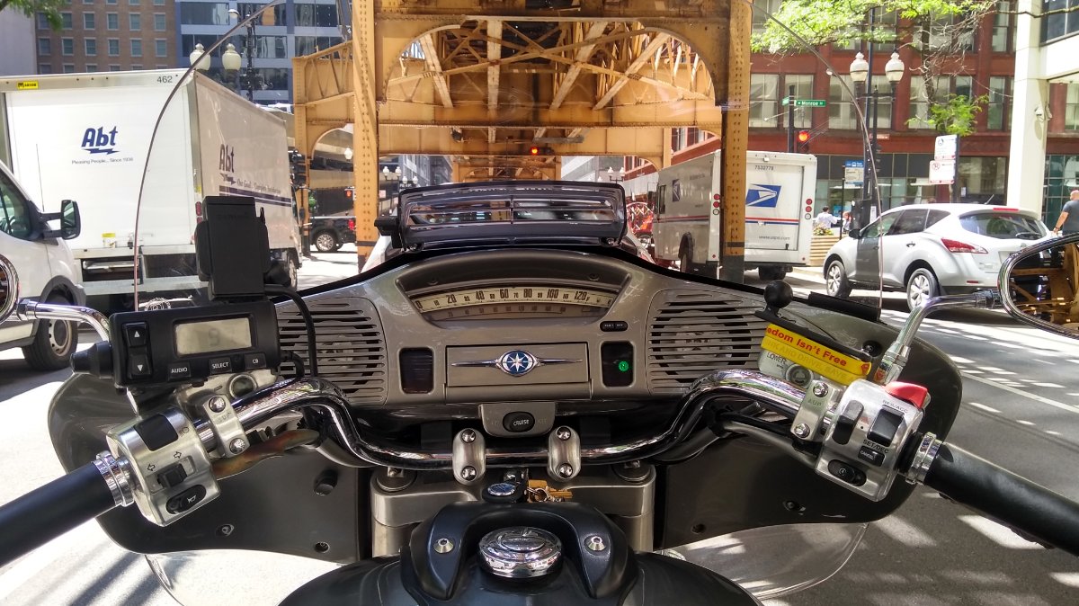

  17. I originally had the u-bolt style mounts down at the bottom of the handlebars next to the risers, but it was awkward to access the ignition switch. I later replaced them with Ram clutch top mounts. The right brake-master typically has a Ram X-Mount to hold my phone and the right clutch-master has the Garmin Zumo 660 Mount that is permanently tied into the bike. https://www.amazon.com/dp/B003CMNXIO/ref=cm_sw_em_r_mt_dp_065GV8G554SE5MFV607D
