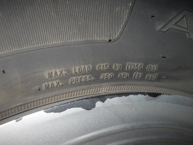

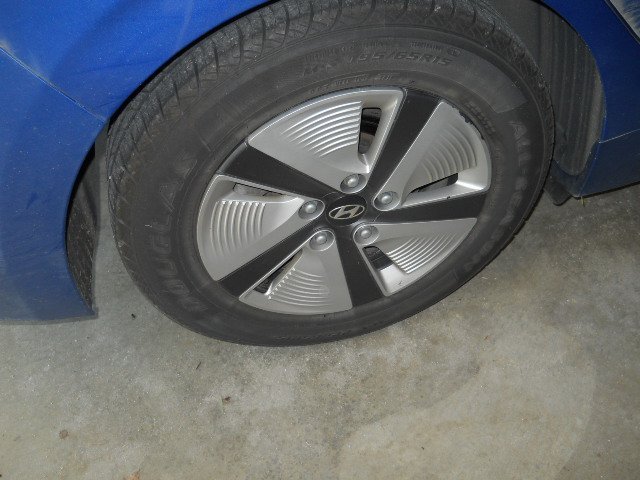

  13. the tires I have on my Hybrid car are cheapies from Walmart, Douglas tires that cost $42 instead of the OEM "Green" greenie tires that cost $175 each. I run those cheap Douglas tires at 45 psi instead of OEM spec of 36 psi to save on fuel and it works awesome with no sign of odd wear. The sidewall on the Douglas states 51 psi max (see pic). I cant imagine that $42 douglas tires have ANYTHING over any other car tire BUT I would check the sidewall for max psi 1st anyway when adjusting to regain control of the bike running dark side .. I know for fact the one I increased to regain control on my friends Valkarie was rated to 50 psi so it definitly was no where near above designed max. Please note @saddlebum,, car/bike factory spec for tire psi is NOT max psi on tires. Also note folks, when checking/adjusting tire pressures do so with tire cold and do not worry about where the tire psi will rise to when hot.. Tire manufacture max psi's are designed with heat increase in mind, its normal and perfectly safe psi max and inflated to 50 psi when cold to go over 50 psi when hot. ALWAYS CHECK YOUR TIRE STAMP WHEN INFLATING THOUGH! way it works. Puc for a tire rated at 50
  14. Worked on a buddies Valkerie with a car tire on back. It was NOT rideable running "normal" car tire 32 psi. I just kept raising psi in car tire until it became rideable and raised it an extra 5 psi. ended up at 46 psi and rode like a bike tire. it was DANGEROUS at 32 psi!
