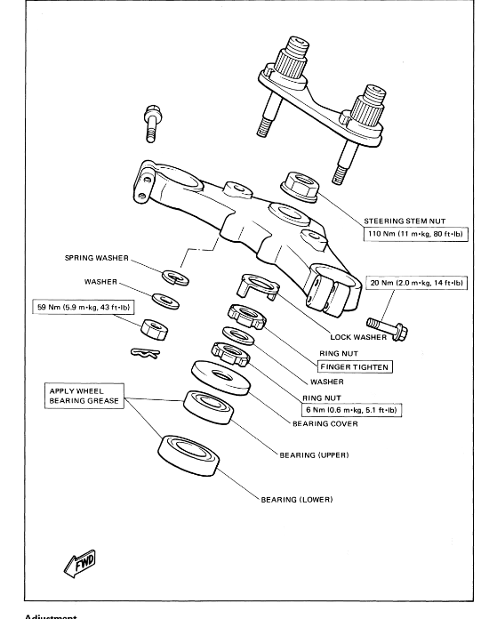

FaceDeAce Posted July 15 Share #14 Posted July 15 Update …. And any troubleshooting tips are much appreciated. The bike is smooth and rock solid up to 60-65 mph. At about 75 mph it starts to shimmy/wobble up front. I am uncertain where to start with this. It could be that where were fair winds acting on the windshield and fairing bucking me around or that I am a light 180lbs all sweaty and not heavy enough to hold the bike down. what else could cause this that I should look at? It is super stable until 70-75 mph, then it shimmy’s around. Scared to go any faster to see if it smooths out or gets worse beyond 75. Link to comment Share on other sites More sharing options...

FaceDeAce Posted July 15 Share #16 Posted July 15 (edited) I did not spend much time attempting to balance the tires. In my experience mc tires rarely need balancing. When I suspended using the shafts (off the bike) for quick check there was little to no movement. What I am referring to is the feeling that the front tire is squireling around a bit at the higher speeds. There is no vibration or bouncing that would lead me to think a balance problem. Thanks. I will have a look at the neck bearing tightness and any other pivot points. If those check out, what else could it be? Tire pressure maybe, or just a crappy fairing windstream design? It does have quite a tall windshield on it. I may try taking that off and go for a speed run to see if it makes any difference. Edited July 15 by FaceDeAce Link to comment Share on other sites More sharing options...

FaceDeAce Posted July 17 Share #20 Posted July 17 Front tire is at 40 psi. Rear tire was at 34ish, I set it to sidewall max 40psi. Haven’t run up the speed yet to see if this made any difference. This evening I looked at and tried to tighten the steering stem nut(s). Boy. They sure didn’t make some parts simple to get to to adjust did they. It seems like it could be fine. There is just a teeny weeny tin amount of play. Barely visible when tugging and pushing on front tire with it off the ground. How much is too much? Link to comment Share on other sites More sharing options...
luvmy40 Posted July 17 Share #21 Posted July 17 There is a "swing test". Someone correct me if I am remembering this wrong. With the front tire off the ground, nudge the front wheel left or right from center. Moderate push. It should swing to the stop and bounce back slightly. There should be no visible play at the neck when lifting the wheel. There is a torque spec for the center nut, but I do not recall what it is. Link to comment Share on other sites More sharing options...
Marcarl Posted July 17 Share #22 Posted July 17 6 hours ago, FaceDeAce said: Front tire is at 40 psi. Rear tire was at 34ish, I set it to sidewall max 40psi. Haven’t run up the speed yet to see if this made any difference. This evening I looked at and tried to tighten the steering stem nut(s). Boy. They sure didn’t make some parts simple to get to to adjust did they. It seems like it could be fine. There is just a teeny weeny tin amount of play. Barely visible when tugging and pushing on front tire with it off the ground. How much is too much? No play is wanted, none! The steering head acts as a steering damper. Link to comment Share on other sites More sharing options...
FaceDeAce Posted July 17 Share #23 Posted July 17 Ok thanks for the tips folks. So far I have checked and adjusted tire pressures to the max sidewall rating of 40 psi. the steering post bearing was tough to get to but with a long punch and some contortionisms I managed to tighten it. Got about a 1/4 turn on it. There is no play and the steering is now a bit stiff but not so much so to be worried about wrecking the bearing. I have not looked at rear linkage bushing yet. Though doubt I’ll find anything there. The bike has only 42,000 Km on it. Was abandoned in the shrubs for a long time. I’ll try some test runs this evening with the pumped up tires and tighter post. Link to comment Share on other sites More sharing options...
Marcarl Posted July 18 Share #24 Posted July 18 If the bearings feel stiff I would suggest they will be too tight and you will find the bike constantly wanted and going it's own way. There should be barely any noticeable drag as you move the bars, but there needs to be some. So the book calls for 5.1 foot lbs on the lower nut, but only finger tight on the next nut. Then when you torque the top nut down it will give just the right amount of pressure to the whole assembly including the nuts. When this procedure is done it's also said to loosen off the pinch bolts for the forks, that way any fork pressure or resistances are minimized. Link to comment Share on other sites More sharing options...
