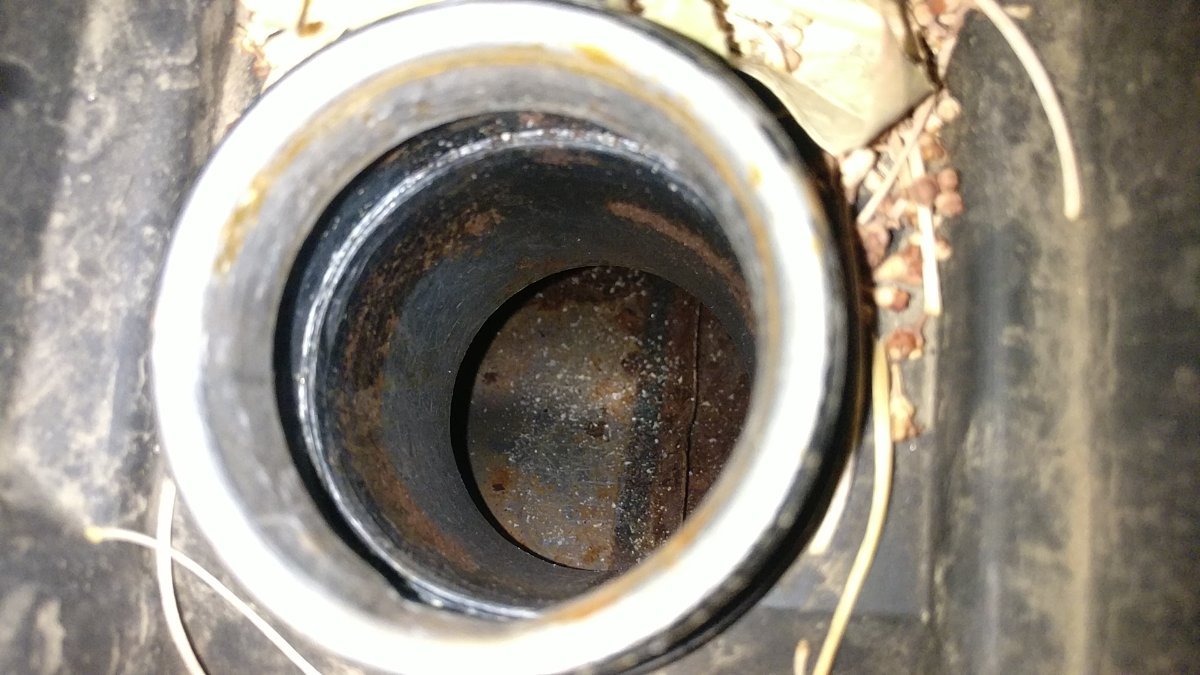

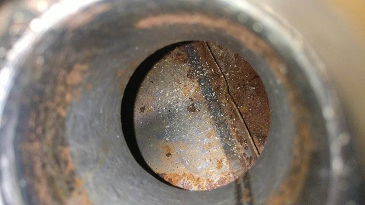

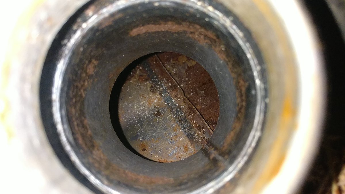

YoungWayne Posted October 24, 2021 Author Posted October 24, 2021 Is my tank shot? To my untrained eye it seems to be pretty rusted. I haven't drained the tank yet, but it was barely has any gas in it. Is this fixable and would I have to take the tank off? I might just buy another tank if I'm going to be taking it off, but I would prefer to save some $$$ and clean it if possible.
Marcarl Posted October 24, 2021 Posted October 24, 2021 I will be very interested in the opinion of others, I'm not very savvy when it come to rusty tanks and what to look for,,, but,,,, Yah you knew that was coming,,,, but,,,, looking at what I can see my thoughts are, there is rust there that is just waiting to plug a fuel filter, and if what I see is only a sampling then there is a great possibility that there could be just one little spot somewhere that is almost rusted through, which in short time will become a leak. Now how to fix that? well some have tried and been successful for a time, others have tried and had no success, but I will leave that up to them to tell the tales. 1
Woody Posted October 24, 2021 Posted October 24, 2021 I will start off with the same disclaimer as Marcarl, I will be very interested in the opinion of others, I'm not very savvy when it come to rusty tanks and what to look for,,, but,,,, I would be sure it is disconnected from the system making sure the petcock is open and wipe it out and then blow it out with compressed air, flush it out with water until it runs clear and watch for any sign of the tank leaking while it is full of water. Then wipe it out and use air to help dry it best you can, connect the line with the old filter in it up fill it with gas and double dose of sea foam and drain that tank through the filter into something you can see the gas in to check it's condition then replace the filter connect everything up and refill the tank after running out that first tank change the filter and monitor the new filter and change as needed. Just my two cents 1
