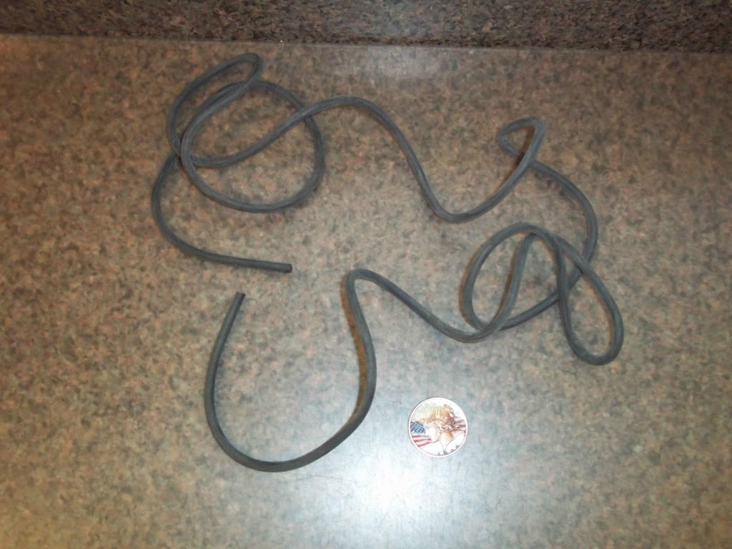

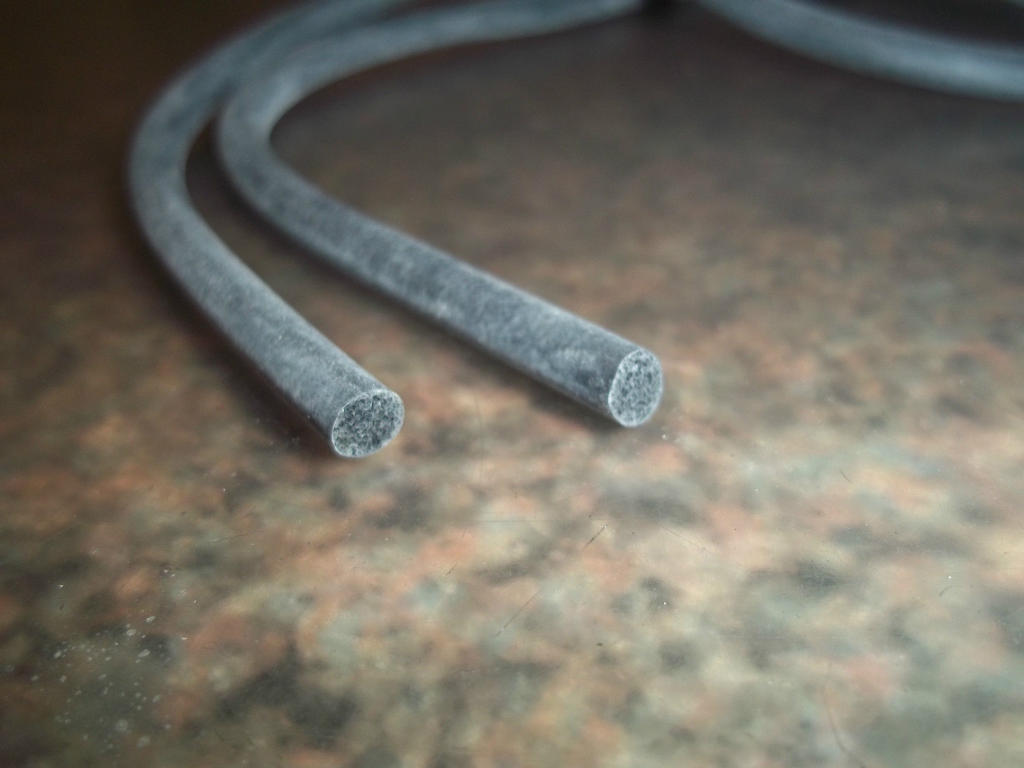

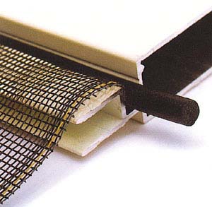

The MKI saddlebags and trunk each should have a seal in the groove. It is part number 26H-2847F-00-00, superseded to 54K-2847F-00-00. This seal is also used on the trunk of the MKII Venture. Of course it is no longer available from Yamaha. I have seen a seal offered on eBay once, but never again.
Some have inserted the proper sized window screen spline as a satisfactory substitute. You can find screen spline at home centers.
