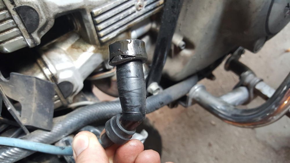

Air Ready Auto Posted July 11, 2018 Posted July 11, 2018 Have been having cylinder 2 problems. All of the normal checks seamed normal. Then I got zapped today. Left cylinder 2 unplugged and she ran like she always does. Hooked my inline spark tester up and she ran like a dream and the exhaust pipe heated up like the rest. I'm guessing it is shorting out when plugged in. Cylinder 1 is wrapped the same but I'm guessing is not shorting because the pipe is heating quick like the rear 2. So, where can I get a new set of wires? And wow do these things run good on 3 cylinders. I'm guessing this has been a problem since I got her and never noticed. Lucy is also my first Venture so I had nothing to compare to.

Flyinfool Posted July 11, 2018 Posted July 11, 2018 It looks like you have blue spark wires, this would indicate that the wires have been changed. It is very easy to replace just the caps with new ones. I bought this spark plug cap. You would not be the first person to ride a LONG time on 3 cyl just because you did not know the true potential. These Ventures do run quite well on 3, some people only notice a dip in MPG when one cylinder drops out. But hang on when you get all 4 running, it will feel like you added a turbo.........
Air Ready Auto Posted July 12, 2018 Author Posted July 12, 2018 Thanks @Flyinfool , I have 4 comming. Anybody have a write up on how to replace them or even a video @cowpuc ? I have seen stuff about how they just screw on and off but for the life of me I can't figure out how that would work. This one absolutely does not want to come apart.
videoarizona Posted July 12, 2018 Posted July 12, 2018 Let me try to set this up for you without visuals... The coil has a screw type nut that screws onto the coil. There is an O ring as well. You push the screw type nut onto the spark plug wire, then push an O ring onto the wire. Visualize the end of the spark plug wire with a nut then an O ring on it. In this order...the end of the wire, the O ring, then the nut. Nut threads facing toward the end of the wire. To assemble: You push the end of the wire into the coil. Push hard as its going to be pushing against a pin inside the coil. This pin gets pushed into the middle of the wire, making contact with the center conductor. Then you push the O ring up to the coil, then push the nut up to the coil as well. Now, by pushing and turning the nut onto the end of the coil, once you get the threads engaged, then nut will pull in and seat the O ring...compressing the O ring which now will hold the wire snug in the coil. It's a simple but effective system. Nice part is, if you live in an area where wire corrosion is a given, you just loosen the nut, pullo the wire out of the coil, snip off about 1/2 inch of wire...or enough to where the wire is clean and not green colored....then push the wire back in, the O ring in and the nut in...tighten nut and done again for another year! I wonder if a little dialetric grease on the outside of the cable would help slip the cable in and at the same time provide corrosion resistance...I don't know..just thinking out loud.
Marcarl Posted July 13, 2018 Posted July 13, 2018 Just some clarification I think. -The o-ring has 2 sides, so ot's not a normal rounded o-ring. Check to make sure you have it placed rightly. -I wouldn't use any lube of any sort, just makes everything slippery and hard to handle. - It you want you could put a wee bit of DE on the inside of the plug boot, but it shouldn't be necessary. - Install new plug boots. you can go resistor type or not, your choice. If you don't new sounds might show up on your radio is all. - Put new plugs in while you are at it. - Pull the front wires first, then the rear wires. Install the rear wires the the front wires. Can all be done without faring removal if you don't have meat fists. - To route the new wires, tape the new wires to the old to slide in the new ones as you pull out the old ones.
Flyinfool Posted July 13, 2018 Posted July 13, 2018 Those are both great explanations for replacing a spark wire in the coil. But he already has aftermarket spark wire and is just replacing his damaged caps. If your caps were replaced at the same time as the wires then it is very possible that you do not have stock caps and we can not guess how they might come off, but the new caps should just screw onto the end of the wire. After you trim it back 1/4 to 1/2 inch to get to fresh center conductor.
Air Ready Auto Posted July 14, 2018 Author Posted July 14, 2018 In guessing that the existing caps do not screw on/off or easily come off the wires as I can find no way to remove them without cutting the wire. The new caps are due to arrive tomorrow. The plan is to trim off the old caps and install the new ones.

Air Ready Auto Posted July 18, 2018 Author Posted July 18, 2018 (edited) Got the caps and installed them. Cylinder number two exhaust (left front) is still heating up slower than the others but significantly faster than before I installed the caps. There is also no performance difference between riding with all four plugged in and cylinder number 2 unplugged. Any ideas oh masterful ones? Edited July 26, 2018 by Air Ready Auto
