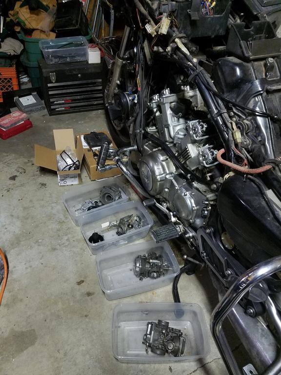

luvmy40 Posted February 22, 2018 Posted February 22, 2018 Just a pic, for no real reason of the old girl as she sits right now.
Flyinfool Posted February 22, 2018 Posted February 22, 2018 She is still sitting out in the garage NEKID.......

luvmy40 Posted March 2, 2018 Author Posted March 2, 2018 (edited) Made a little headway today. Not as much as I'd liked to have gotten done but a start. I spent most of the day on a wild goose chase looking for some 2" flexible aluminum duct to make an exhaust vent for the shop. Nada, nunca! So I'll have to order it from the interwebz. I did pick up new fuel line and got that and the head covers with the new OEM Gen 2 gaskets installed. Now to get started on dinner. Chicken Tandoori tonight, with fresh ginger and cilantro served with lemon/chicken rice and yogurt sauce. YUMMMMMM! Edited March 2, 2018 by luvmy40
luvmy40 Posted March 4, 2018 Author Posted March 4, 2018 Got two carbs cleaned up, re shimmed and back together with the new SS screws. I have to track down a lost screw for the enricher block on one of them. Not sure where it could have gone as everything was disassembled in a Rubbermaid container and hasn't been touched since tearing them down. The third is in the carb dunk and the fourth is waiting in line. I'd hoped to get them all back together, check the float levels and reassemble the rack tonight but without that pesky screw, it'll have to wait till Tuesday!
luvmy40 Posted March 7, 2018 Author Posted March 7, 2018 I got the carbs all cleaned up and put back together. Remounted the carb bank, air box and TCI. Started her up and I'm getting no love from the #3 cylinder. Good spark and the colortune shows fire with the enricher circuit on and at 1/3 throttle or so, just no fire on idle. I must have a blocked passage in the #3 carb pilot circuit. I guess I'm pulling the carbs again tomorrow!

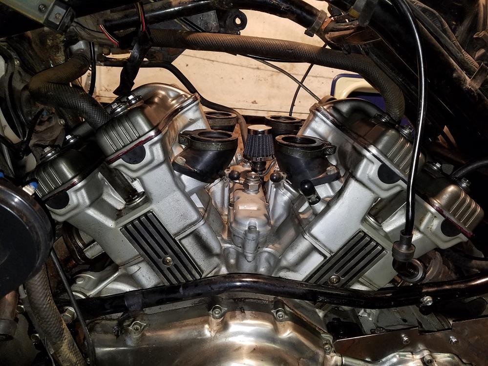

luvmy40 Posted March 8, 2018 Author Posted March 8, 2018 I pulled the carb bank and double checked #3 . All passages are clear and everything looks good. I put new o-rings on all 4 drain plugs and reinstalled everything. Still no fire at idle on cyl. #3 . I pulled the plug and low an behold, it's fuel fouled. Cleaned her up and...still no luck. I colortuned the other 3 carbs and synched 'em all up at about 3k rpm. Dropped the idle back down to 1Krpm and I can hear 3# firing intermittently. I'm leaning toward a bad TCI but I'll ohm out all the coils caps and wires later just to be sure. Anybody know off hand what the Ignitech modules are going for now? The orange box from RegulatorRectifier.com is $329.00
