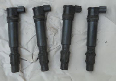

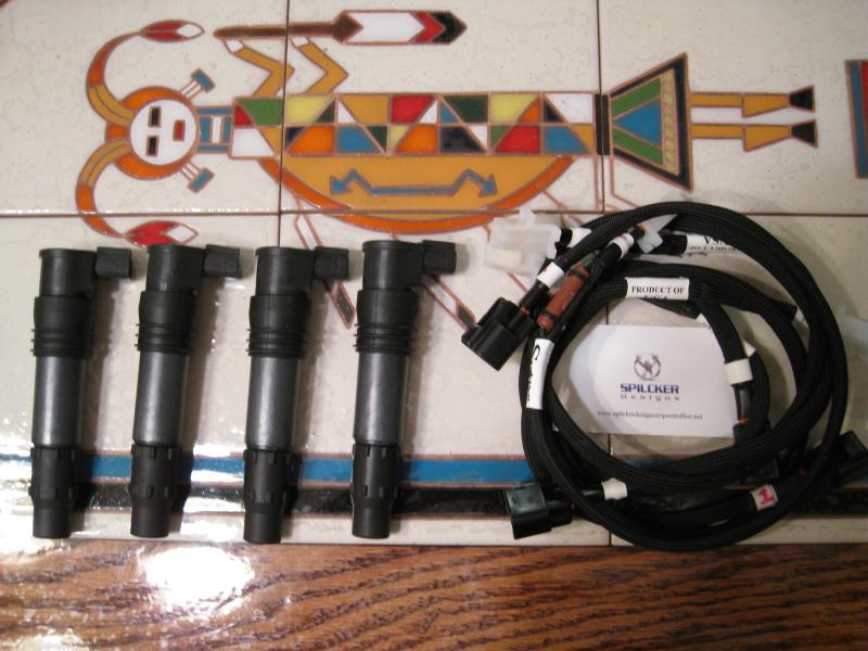

flyday58 Posted May 4, 2015 #1 Posted May 4, 2015 (edited) Got my new COPs and harnesses today from the guy over on the V-Max forums that makes the harnesses. Install will have to wait as the Venture will be on a trailer tomorrow headed to New Mexico and our new home. But I'm excited to get them. Also sending my seat to Rich's Custom Seats for a recover job. Should be a fun summer! Edited May 4, 2015 by flyday58 forgot the pic!

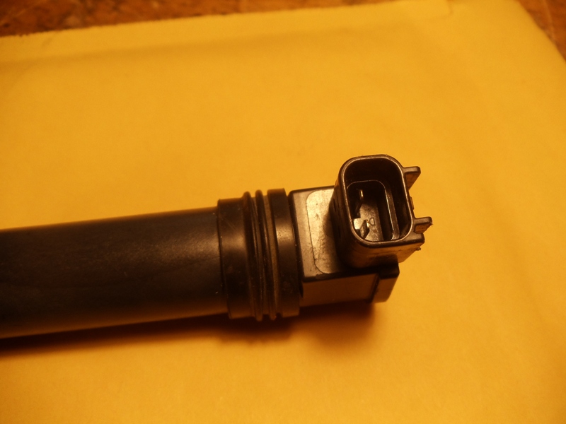

flyday58 Posted May 4, 2015 Author #3 Posted May 4, 2015 Coil over plug ignition coils. They will replace my OEM coils which have cracks, corrosion, and ugly leads and plug caps. Dingy I know has done this mod, and I think it's popular on the V-Maxs, too.

flyday58 Posted May 5, 2015 Author #10 Posted May 5, 2015 Great info, Gary. I am working with our Vmax friend to come up with an installation manual with plenty of pics for Venturers who want to do this mod. He includes his own new harnesses so that will be part of the deal, making sure lengths and polarity are correct. I purchased the Ignitech from someone here on the site, no idea who , so I don't have to worry about the resistor part of it. Once I have everything like he wants on the manual he plans to offer the kits here on the Venture forum to interested members. He's sending me his Vmax manual to help me get the Venture manual like he wants it. So I guess that makes me the Venture beta guy on this upgrade. Bike left today for New Mexico:bawling:, so it will be a little bit before I can get around to the installation. I will update when I do. Stay tuned.

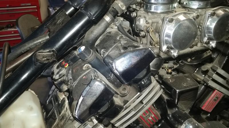

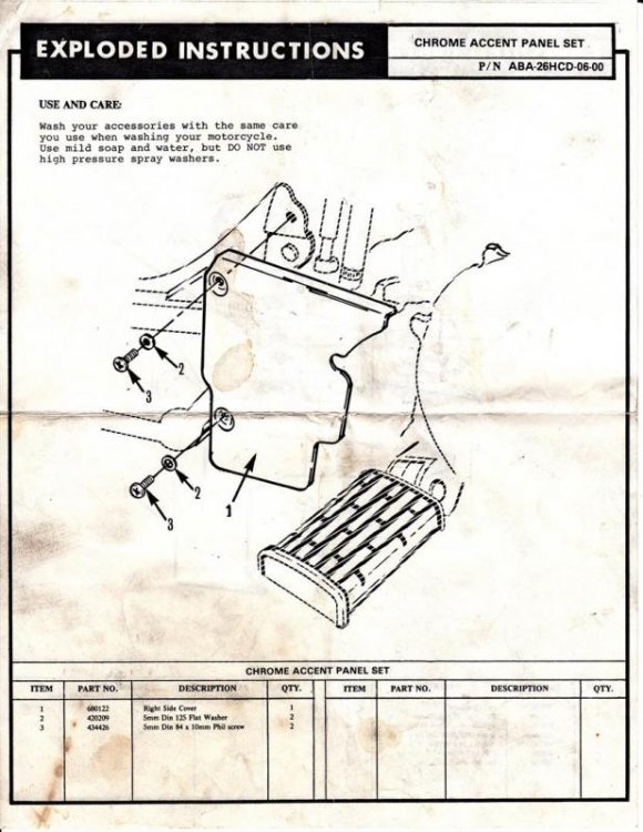

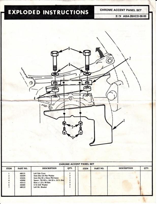

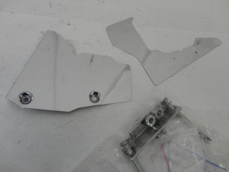

syscrusher Posted May 6, 2015 #15 Posted May 6, 2015 dingy said: I have been running COP's on Tweety for 2 or 3 years now. Gary That plate around the right side cover in photo 4, izzit something you bought or did you make it? I want one.
dingy Posted May 6, 2015 #16 Posted May 6, 2015 syscrusher said: That plate around the right side cover in photo 4, izzit something you bought or did you make it? I want one. That's an aftermarket cover. One on both sides. MarCarl had made some up a couple of years ago. Gary
Prairiehammer Posted May 6, 2015 #17 Posted May 6, 2015 syscrusher said: That plate around the right side cover in photo 4, izzit something you bought or did you make it? I want one. Yamaha offered these "Accent Panels, crankcase" in the VentureLine accessories catalog. I've noted that they sell on eBay from $5 up to $80. There is currently a pair (two separate auctions) where the seller is wanting $20 each. They are not in good condition nor are they complete. If you buy any accent panels, make sure they are complete. The left side panel requires a bracket with spacers and longer bolts to be installed onto the middle gear.
syscrusher Posted May 11, 2015 #18 Posted May 11, 2015 Thanks for the info both of you. It looks like I missed out on the glory days of the Gen 1.
cimmer Posted May 12, 2015 #19 Posted May 12, 2015 The accent panels are the same between the MKI and MKII expect that the MKII has a notch cut out for the band on the bottom of the side panel. So a set off of a MKI will work on a MKII, just makes it hard to get the side cover off at times. Rick F.

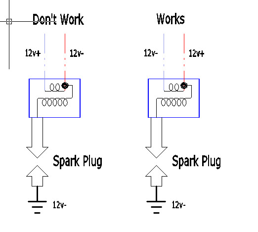

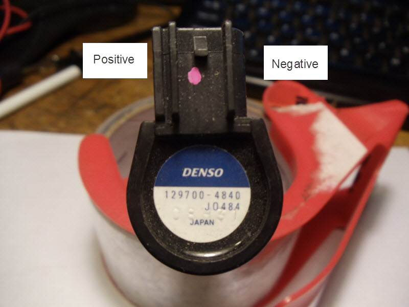

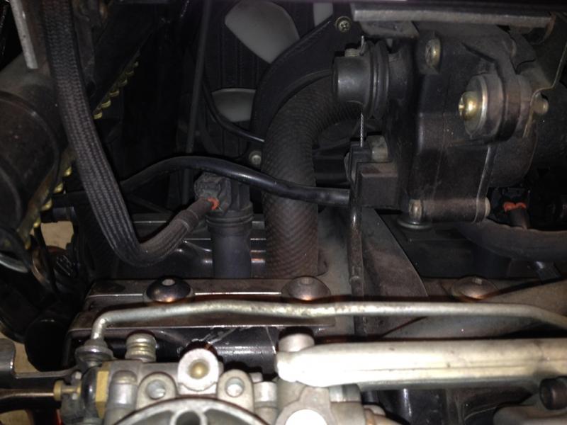

jdross440 Posted June 5, 2015 #20 Posted June 5, 2015 I did the COP conversion on my 90 Wednesday. I used the connectors listed in post 13. Nice connectors. I crimped the wires in the terminals and then soldered them to make sure of a good connection. For wiring, I had some spare trailer light wiring (which is 18 ga 4 different colors) to use for the negatives. I used 18 ga black for the positives since they are common. On my COP's the positive and negative are opposite of that shown in the photo. When I started the bike cold, it seemed to fire off much quicker and ran smoother. Also it got rid of the spark pop in the headset. I still have hash that sounds like it's coming from the charging system. You can push down on eithr radio or intercom knob and turn it and it will go away and come back as you rotate. curing that will be my next project.
