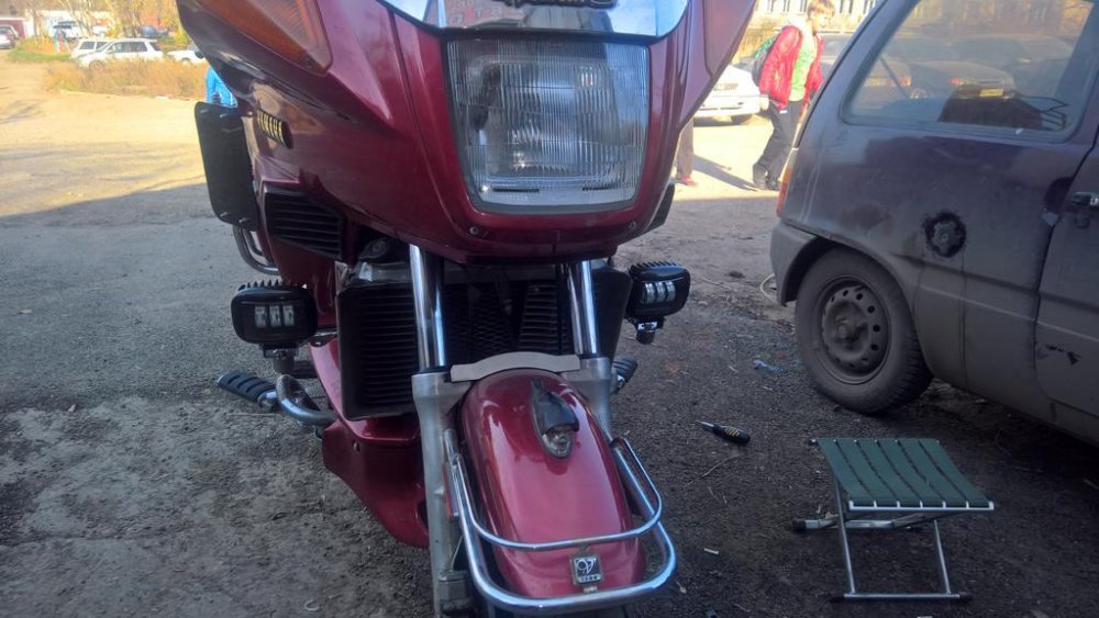

  3. Protection of feathers of a fork. A leg from a table and arms of turns.

  11. Does not approach!!! The head disturbs. It is necessary here such!

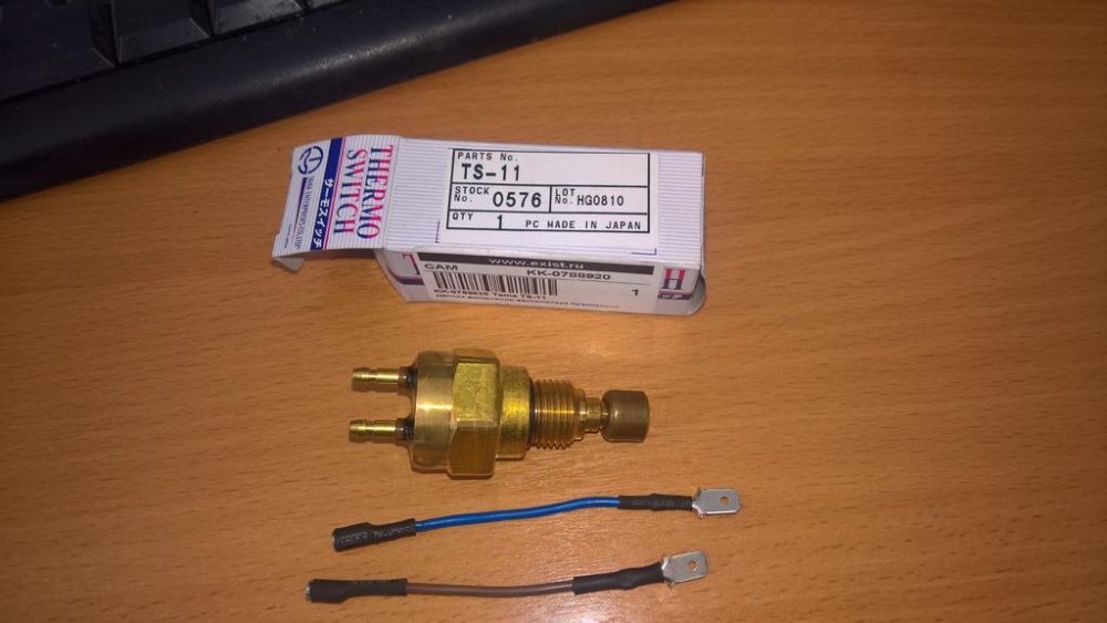

  12. https://gho.co.za/index.php/new-products/3396/111/electrical/fan-switches/P-hella-thermal-switch-fs7920 and Fae 37450
  13. Tell me, from which car can I install the fan sensor (termoswitch)? https://www.ebay.com/itm/Yamaha-V-Max-VMax-Royal-Star-YZF1000-YZF600-FZR600-Fan-Switch-NEW/333176253524?_trkparms=aid%3D111001%26algo%3DREC.SEED%26ao%3D1%26asc%3D20160908105057%26meid%3D27d5b09db8c747a49b1405d7bff5b326%26pid%3D100675%26rk%3D1%26rkt%3D15%26sd%3D333176253524%26itm%3D333176253524&_trksid=p2481888.c100675.m4236&_trkparms=pageci%3Ab3140d05-76b3-11e9-9ca6-74dbd18058af%7Cparentrq%3Ab92e45dc16a0ab4573d407e3ffe8750f%7Ciid%3A1 This termoswitch is clearly from the car.
  14. 1. To bring closer a light-emitting diode to a lens on 10 mm 2. To cut off a rubber ring between a lens and the case 3. To establish a restrictive curtain from a foil on the top part of a lens.
