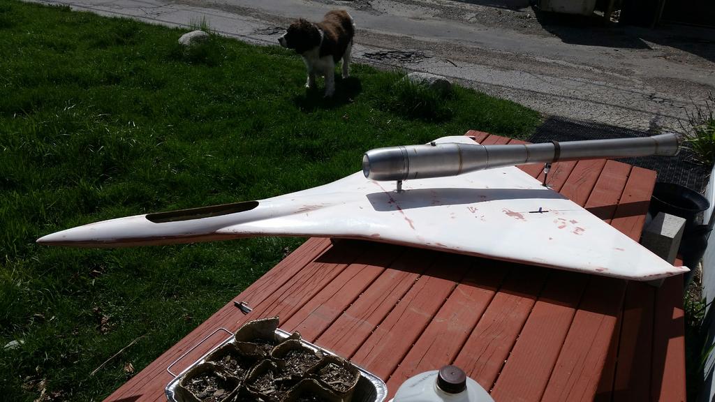

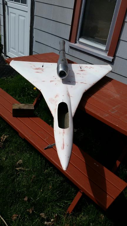

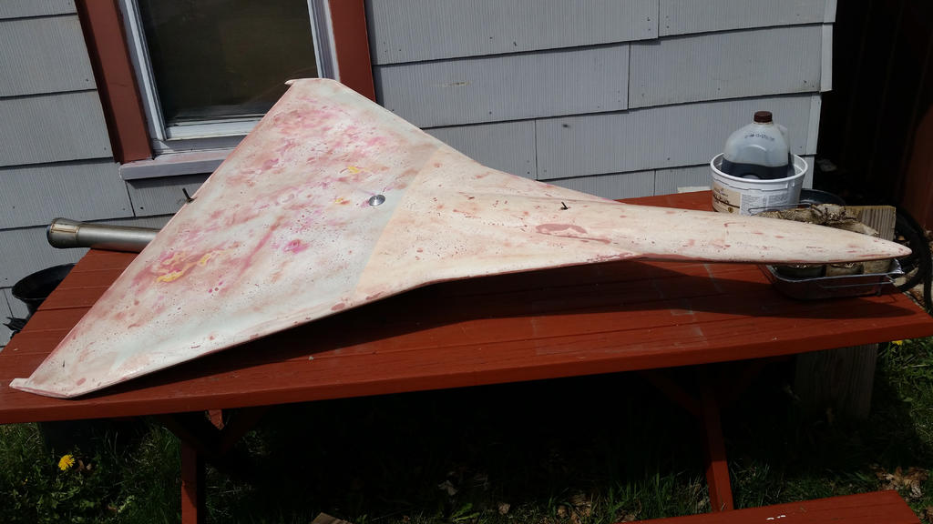

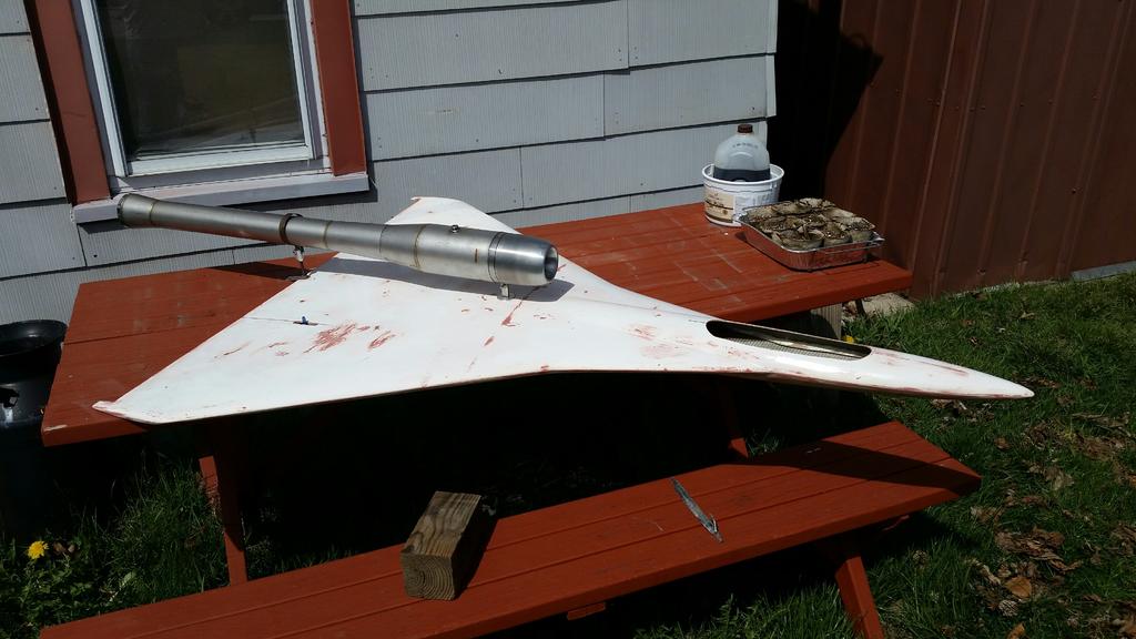

Flyinfool Posted April 23, 2017 Author Share #37 Posted April 23, 2017 (edited) Well here are a few pics to wet your appetite. It sure does not look a lot different from when I started, but there is a lot of time wrapped up in it already, most was filling and sanding and the early parts of paint prep. The pulse jet is just temporarily mounted to get a rough idea on where the CG is headed. It looks like everything needs to be as far forward as it can go and I will still need a lot of lead in the nose. This also means that there is no reason to skimp on any structure up front. @cowpuc Edited April 25, 2017 by Flyinfool Link to comment Share on other sites More sharing options...

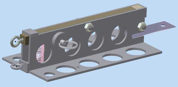

uhfradarwill Posted November 3, 2018 Share #45 Posted November 3, 2018 SSSHHHHHhhhhhhh............ Don't tell cowpuc all of my secrets........... I had him believing that this was just a really cool toy. This will allow deliveries at 250 MPH....... Is that a Solidworks output Mr. Fool?? Link to comment Share on other sites More sharing options...
Flyinfool Posted November 4, 2018 Author Share #46 Posted November 4, 2018 That was drawn using Inventor. I now have it all built, just painted it this morning. Tomorrow I will final assemble it and post a pic. I did come to the realization that it did not need the lightening holes. This is an anchor, weight is not a bad thing. The big holes would look cool but are a lot of extra work to make. Link to comment Share on other sites More sharing options...

Flyinfool Posted November 6, 2018 Author Share #50 Posted November 6, 2018 As promised here is a pic of the Release mechanism. Of course it took longer and was more work than I expected. Link to comment Share on other sites More sharing options...
