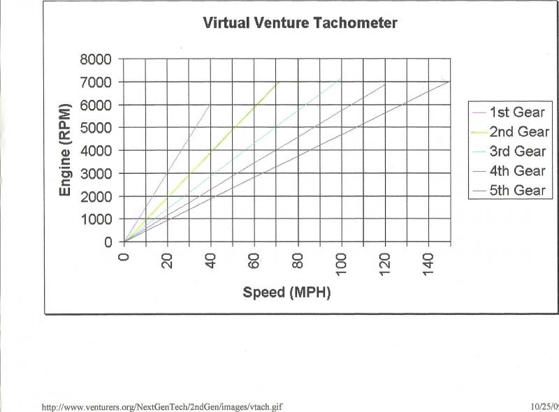

CaptainJoe Posted January 20, 2015 #13 Posted January 20, 2015 (edited) From what I've read you need a voltmeter and a tach. The tach will allow you to keep within a certain RPM range. The higher the RPM's the more output from the stator. If your in a town/city and doing a lot of stops you might have to turn your heat controls down.(low RPM's) I'm going to disconnect/unplug my carb heaters and gain an additional 60 watts.(15 watts per carb)as they're not used below 68deg anyway... will plug reconnect in the Spring. I got this and chart from another site: "The RSV is equipped with 4 electric carb heaters, one in each carb. These heaters draw 15 watts of power each, for a total of 60 watts. They are operated by a thermostatic switch located behind the right side cover. The thermostat is calibrated to turn the heaters on at 68�F and off at 78�F. The purpose of the carb heaters is to eliminate the possibility of carb icing and to ensure proper performance under certain weather conditions. Due to the limited charging system output of the bike, some riders have disconnected the heaters to be able to use that 60 watts of power for other accessories such as heated clothing and gloves or additional lighting. After many miles of running with the heaters disconnected, they have reported no drivability or performance problems. Although it is theoretically possible for carb icing to occur, it is believed to be very unlikely due to the number of miles travelled in all weather conditions by those who have done this mod. For those reluctant to totally disable this system, it is possible to connect a switch inline at the thermostat wiring so that the system could be reactivated with the flip of a switch." Need to find minimum volts required and optimum volts to maintain battery... some meter show this... Max output for a stock Second Gen stator is: 14V 30A @ 5000RPM Edited January 20, 2015 by CaptainJoe
