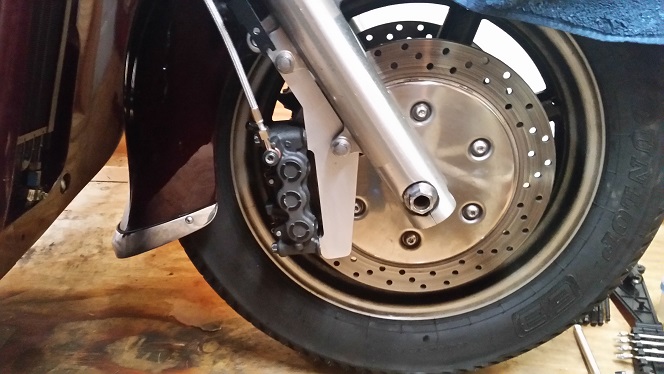

PGunn Posted October 26, 2015 Share #4 Posted October 26, 2015 Which set of the R1/R6 brakes is better? The Gold dots or the Blue dots? Which donor bike is better R1, R6, FJR? I have seen some six piston calipers. Will these fit a 1st gen MKII? The Blue dots appear to have different size pistons, the Gold dots appear the same size. Anyone know the piston diameters? Do they make plastic pad covers for these? I didn't see them in the parts fiche. I might put a set of these on while I am in there. Probably need to be able to slow this puppy down once I get it going. Gary http://i1007.photobucket.com/albums/af193/gdingy101/golddots.jpg http://i1007.photobucket.com/albums/af193/gdingy101/bluedots.jpg Here is the adapter I came up with for the Gen 2 using 6 pot Yamaha R1 Link to comment Share on other sites More sharing options...
