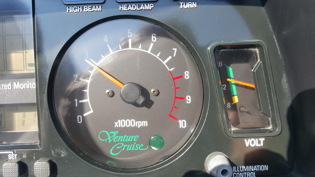

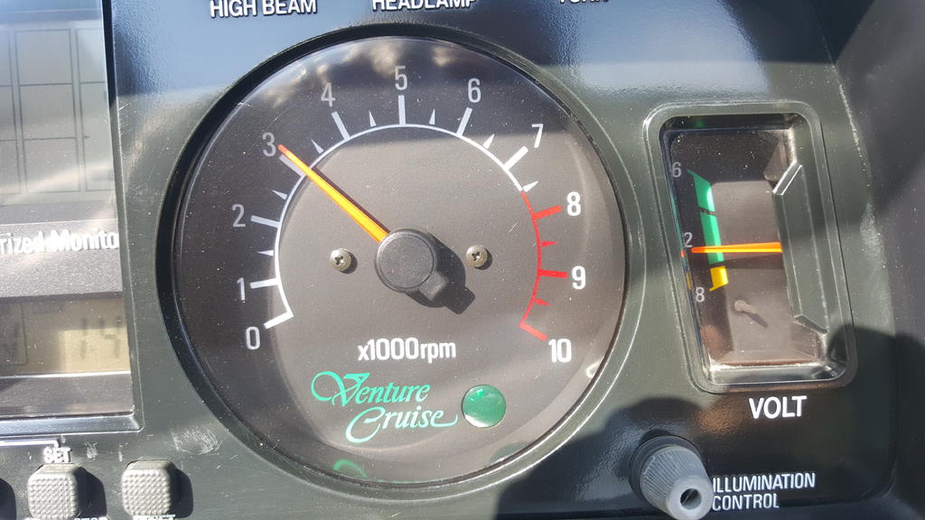

After a pleasant conversation with our friend Carl, a plan of action was determined. Here is what I did. Full battery charge with charger. Not the battery tender. Took stator voltage shortly after starting bike. 3000 rpm 56v AC on all three leads. Image one and two show first readings. Went for a 15 km spin. Voltage gauge reads charging the whole ride. It would dip when slowing for a stop, naturally, but climbed to fully charging when cruising at 80kph. I should note that the needle on the guage never SNAPPED back to fully charging. It slowly crept up. Maybe 15 secs to get there. Arrived home and immediately took voltage readings from stator output. Still 56v AC on all three leads at 3000 rpm. Yet needle shows not charging. Image three and four show readings upon return. Took voltage reading from R/R side of stator connector and get a reading of 12v AC. Output of the R/R was measured at 13.5v DC. Could the stator connector be my issue? Should I solder those wires together? Thanks for your help on this. It's greatly appreciated. Thomas -
