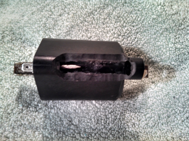

I ordered two new coils a week ago for #1 and #3. I just now got word that the #1 is on national back order until the 27th. Yamaha shows two different part numbers but both coils have the same Mitsubishi part number on them and the wires are the same length. Anyone know why I can use two of the same part that is NOT on national back order? I've already checked the coil by itself and it is the coil, not the wire so this won't help me but I used this method when I had my XS1100 to replace all of the plug wires. I've tried searching old posts but could not find where anyone said that you can replace the wires on a Gen2. Sorry if I just missed it. Here's a link to the XS1100 site tech article. I've already cut my bad coil to see if it is set up the same an it is. I thought this might help someone else if they wanted to try it. http://www.xs11.com/forum/showthread.php?t=137
