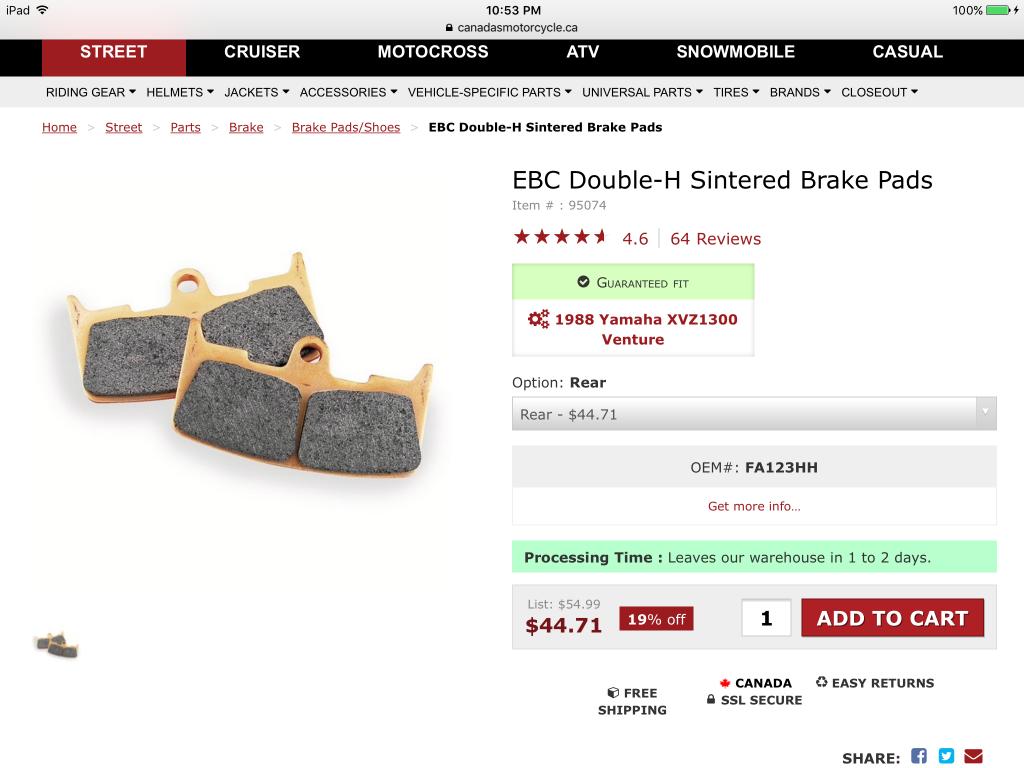

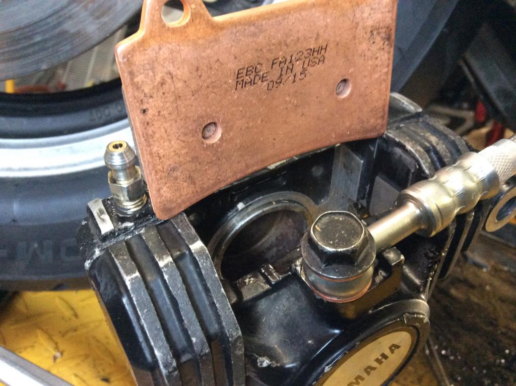

Makes me wonder if the back end of this bike got wiped out. MkI rear end and rear calipers. -

yes thanks Rick. seeing as these rear calipers only have 2 Pistons they have to be off a mkI??? -

So is the "EBC FA123HH" designation the size of brake pad or part number or is that a material designation that is common to other size pads? you can see in the pic that it shows rear pads but the same OEM number. My order showed that I did order the rear pad. -

Ummmm Thanks Eck....I think Didn't come close to answering my question but now we all know we have to order 2 sets for the front of whatever bike:smile5: -
According to everything I've read these pads are the right ones for my bike BUT THEY ARE TOO WIDE! EBC FA123HH I was told I have a Mk I rear end in my 88...so it makes me wonder .... The rear caliper looks the same as on my 84 parts bike... is the Mk I rear caliper different from a mkII ? I already threw out the old pads so I don't have them to compare these pads for sure don't fit!

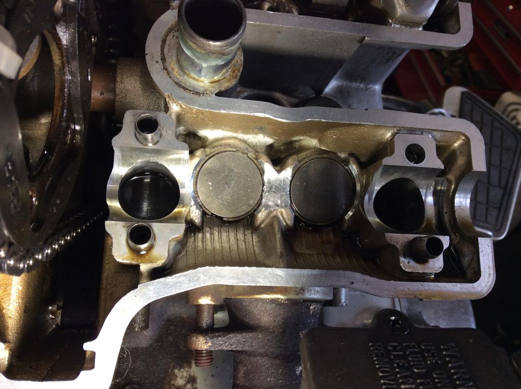

I have to pull both heads. I have 2 stuck exhaust valves on both cyl #2 and #3 and nothing I've tried so far has released them. So...other than head gaskets, what other gaskets or seals or whatever do I have to order? Forget V-max heads...not in the budget. Once the heads are off and I get the valves released what should I be doing while I have it open. This has turned into a marathon and Summer's coming!!!

Well...I tried stuffing the cyl. with cotton rope to use the piston to press the valves back in place. No joy. I tried tapping and looked for any burrs that might be stopping it...still nothing. so unless anybody has any ideas I think I have to pull the heads. Good grief...this all started just chasing a fuel line leak...and I end up going deeper and deeper! So I'm sure that will create a million more questions! If I end up pulling the heads should I be doing anything else while I'm at it?

I looked at it closer today and it seems both valve shim buckets for the exhaust on #2 and#3 cyl are not returning to full height. I can't check the compression until I can borrow a tester with a longer stem. Mine won't reach. It makes me wonder if Flyinfool has the right idea. The exhaust valve stems or springs might be crudded up so much it caused them to bind because the valve tool compressed the valves more than the normal range and corrosion or crud jammed them I use sea foam pretty regularly but I can't think of any other reason. So....how do I get them loose without tearing the heads off? google provided 2 possible answers... 1) stuff a firm cotton rope in the cyl. thru the spark plug hole and crank the engine by hand. I guess the rope is supposed to push the valve up 2) basically the same idea using grease....making a fitting and filling the cyl and forcing grease up the valve stem of the open valves and lubing it. So...what do you think?

Anybody got a shim tool I can borrow or buy? Mother (Scott) came up for a day to help me with my bike....got the clutch sorted out. We had to open the bleeder while we tightened the clutch springs. Every time we tried to put it together the push rod would end up too far out and the clutch would be frozen. Pushed in the rod but by the time we got it together it wouild be extended again. Finally we put it together and opened the bleeder while I tightened the spring. I had a shim tool here but it had been broken and rewelded and it broke on us. One thing that we can't understand....the # 2 and #3 exhaust gap are both over 50mm!!!!! How couid they get that loose?
