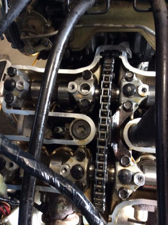

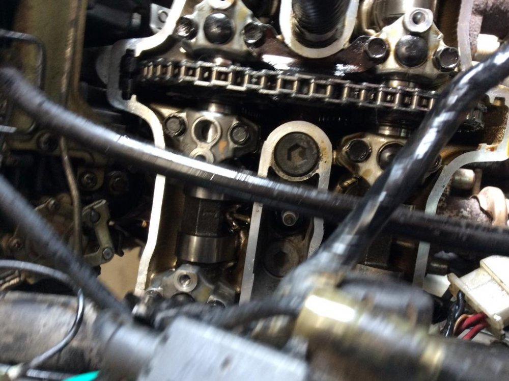

Sorry Pucster No joy in Traderville you were right...something black...the side cover rubber bungee still hanging on the clip
That's what I'm starting to believe. Hard to believe the cover would pull the cap off...it would be difficult to hook onto the smooth dome of the cap. Even if it did....The action of pulling off the cover would pull the cap OUTBOUND...not towards the center cam chain channel. PLUS...the plug looks big enough that even if it fell into that channel, it should have been hung up on the chain or lower gear????? But I though without the plug the bike would not have proper oil pressure. So how would it survive so long???

Hmmm. Imgine that! the bike had 65,000 miles on it when I bought on ebay. No idea of previous history at all.
You can see them at 9&3 o'clock to hex bolt 9:o'clock is gone Pretty sure they are plastic or rubber

I recently posted how our titles of threads should be specific....this one is! I removedthe valve covers....first thing on the list? Make sure oil caps are in place. NOPE! One is missing. I looked EVERYWHERE! If it fell down beside the cam chain then it went right down...not wedged anywhere I can see. I literally spent over an hour looking in every nook and cranny on the bike, on the floor, on top of the collector, top of shock....EVERYWHERE!! so like I said...OH CRAP my dumb question of the day....can I leave it? If it did fall into the guts will it just get ground up and end up in the filter? I can see a concern of blocking any oil ports....but I don't know what to do! HELP!!!!!!! 2nd question.....save me tearing into my parts bike engine.....does anyone have one open where they can send me one?
