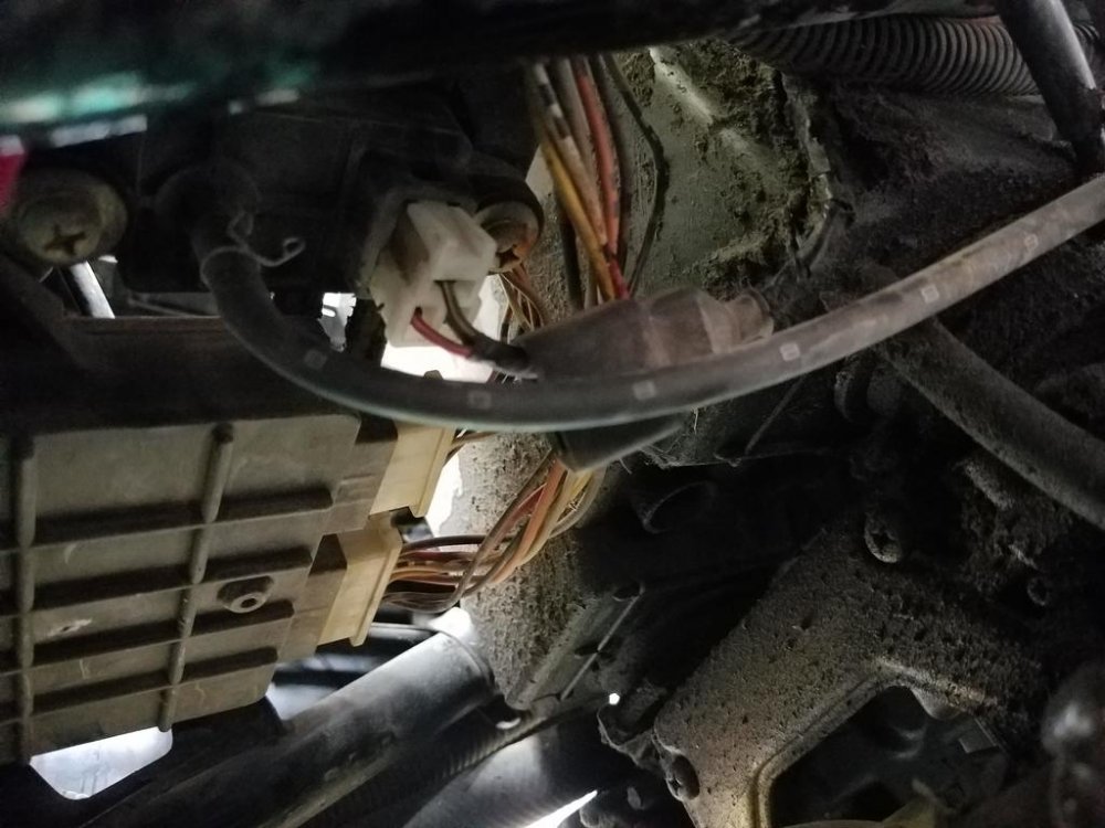

@luvmy40 that is great advice, but I've got the battery and everything out at the moment. Cleaning stuff up and wiring up the new fuse box. I couldn't get it off because the screws were froze on but managed to with a friend test the sensor on the bike and everything checked out there. The TCI spades definitely looked dry, but not corroded. Ill pick up a file and clean it out and spray a little lithium in the plugs before putting it all back together.

Thanks guys! While I'm this far into the bike i aim to check third voltage while not running. The manual shows taking it out and jumpering it with a battery and testing the voltage out of the signal wire. According to my manual it should read 2 volts. I should be able to test it by slipping a pin through the plug on the sensor wire and be able to test it right on the bike right?
Hey guys, got the bike pulled down pretty far so I'd like to pull the plugs at the TCI and give em a good look over and a cleaning. Underneath I can see the TCI and the two plugs that go to it, but whats this thing beside it? I'd like to pull the plug on that too and clean it. Just curious It looks like it might be the MAP sensor?
