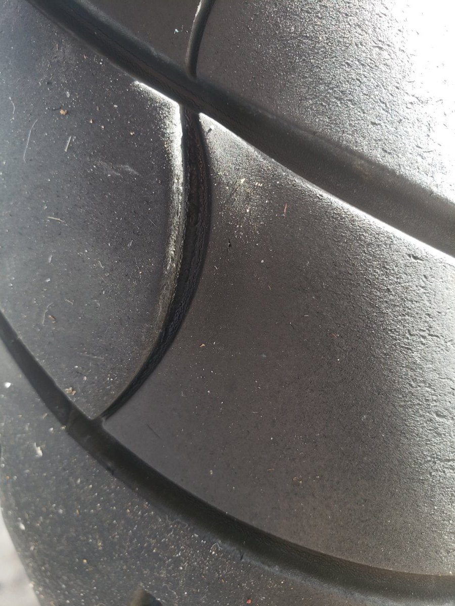

I live outside of Houston Texas and I ride all year long. I have been noticing the cupping and could feel it buzzing in the handlebars. It just happened that the bad spot was right in plain view at the perfect angle for it to really catch my eye yesterday morning after I got off the bike. Now I'm going to fill y'all in on something here, I run darkside as I have a 15" Nexen car tire on the back of my RSV. I've been running it for about 2 years. Now I know some of you are shaking your heads as you would never think of doing it, and that's cool, I just wanted to run one for myself for an extended period as a lot of my riding these days is 1 up and on the freeway. I'm fairly confident that running the car tire on the back should not have made any difference on this tire. I still get into the twisties, and even though my chicken strips aren't to the complete edge of the tire, I still ride it how I want to. The only thing I wonder about is the Shinko on the front is a bias tire and the back is a radial, I've heard about not mixing the 2, but not sure what the "side effects" are with running it this way.

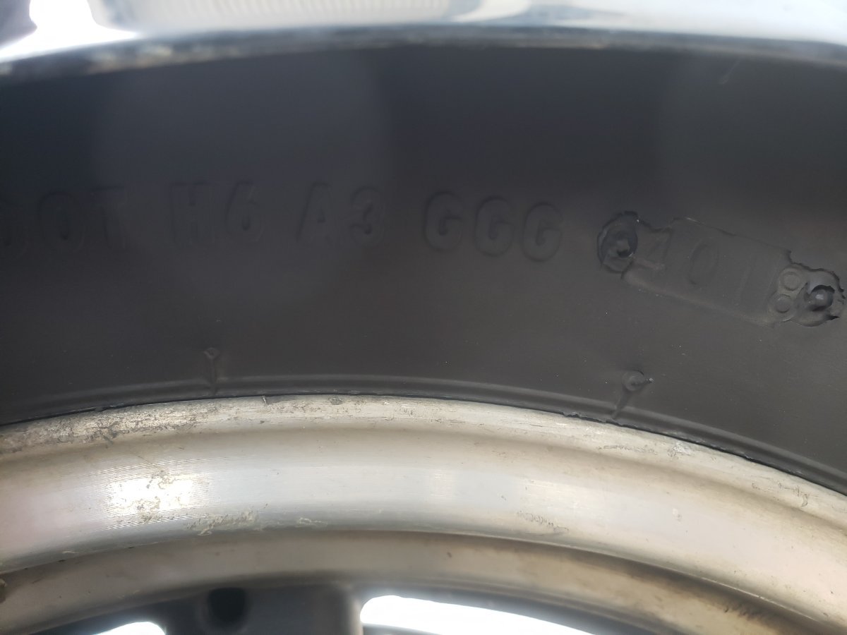

Ok, Here's the skinny, I did receive an emailed response back from Shinko, which was fairly quick. This is what they had to say... Hello Brad Thank you for reaching out to Shinko Tires USA. All possible warranties begin with the original selling dealer. Please reach out to the point of purchase and they will work with us to get the proper information and inspections done. Please let us know if you have any further questions! Thanks! Aly Clark Support Specialist –Tire & Wheel Division I purchased the tire online, from I believe Dennis Kirk, I would have to try and research that out. I had my local Yamaha dealer install and balance it. So unfortunately it appears that I have to do a lot of legwork and time to get it to the point where they will look at it and determine if it's a warranty issue. I'm not sure I'm going to waste my time to do this on a $100 tire. I believe that I'm just going to try a different brand, perhaps something that I haven't tried before like a Pirelli. If i do decide to spend the time jumping through the hoops, I'll let y'all know what becomes of it.

I don't necessarily disagree with you Ben, I just remember the Metzler debacle and them ultimately blowing many people off. I will get a batch number for y'all so we can see if they did indeed have a bad run.
Hey Folks, I wanted to come on here and tell you about something I discovered this morning on my RSV. I have been a big proponent of the Shinko tires, I've ran a few sets on various bikes. I looked at my front tire this morning after I got to work and saw it cupping badly, at closer inspection, as seen in the 1st picture, the tire is separating. This tire has somewhere between 7 and 9K miles on it and has a lot of tread depth left. I'm obviously going to replace this tire, and also not purchase anymore Shinkos. It's unfortunate as I've had pretty good luck with running them, but I will not promote this brand any longer. Some of you will remember when the Metzler 880's were doing this, this reminds me exactly of that. Just wanted to give y'all a heads up so you can make better informed decisions when ordering tires for your bikes.
