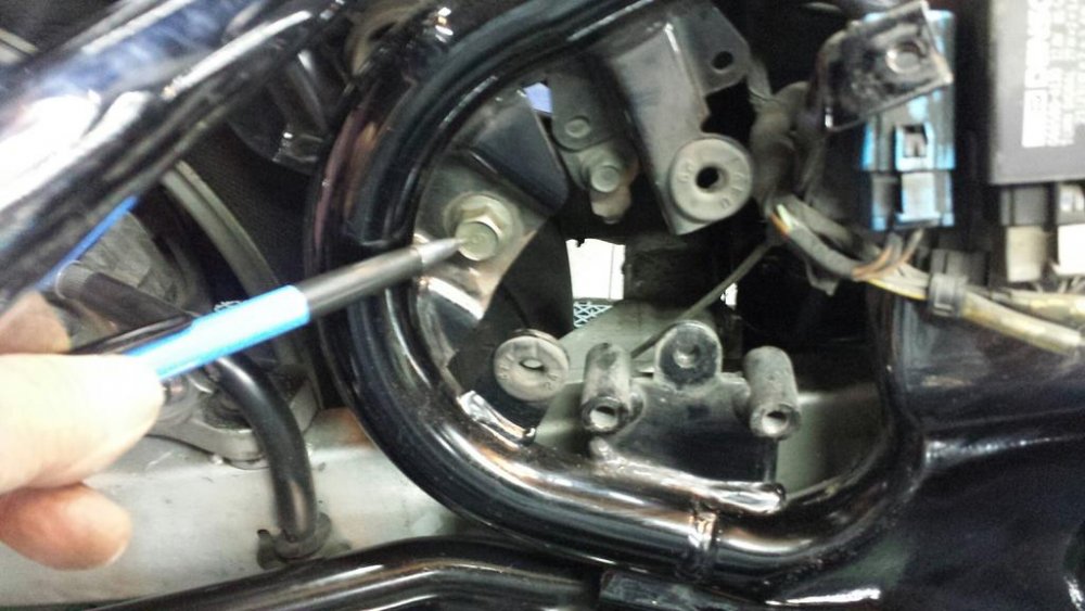

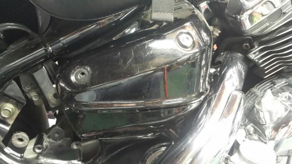

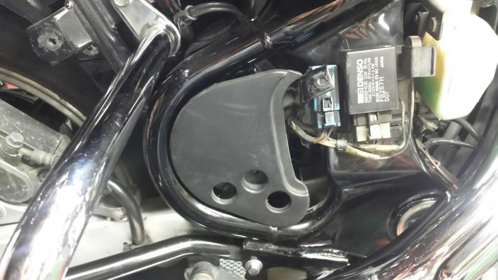

	2nd Generation Venture. Mine is an 04 with 85,000 miles on it. "BOLTS WERE LOOSE" You have to take off side covers from both sides & passenger foot rests. Take off Plastic Cover to see these bolts that the ink pin is pointing to. My right side was out all the way. Only the plastic cover kept it from falling off onto the road. The left side was very loose. I could turn it with my fingers. I removed both bolts and put removable LocTite and torqued to 80 ft lbs. That just felt like a good feel. I could not find the torque specs on this bolt. How many bolts are loose out there running on the roads?
	Tonight I was going to adjust the rear shock so I was taking off the panels on the right side to get to the top nut on the shock. You have to take the right side passenger foot pad off and take the plastic cover off. Pic #2 Pic #3 with the 14 mm bolt shown with the ink pen pointing to it was out all the way. The only thing holding it from falling off on the hwy. was the plastic cover. I put Loctite on it and tightened to 80 ft. lbs. That seemed like a good feel. Thought to myself. Better check the other side. Sure enough that bolt was very loose but not out all the way out. Just thought ya might want to check yours sometime. They are good size bolts. So, that's what I did. Adjust the shock and tighten two bolts that I didn't know was loose.
