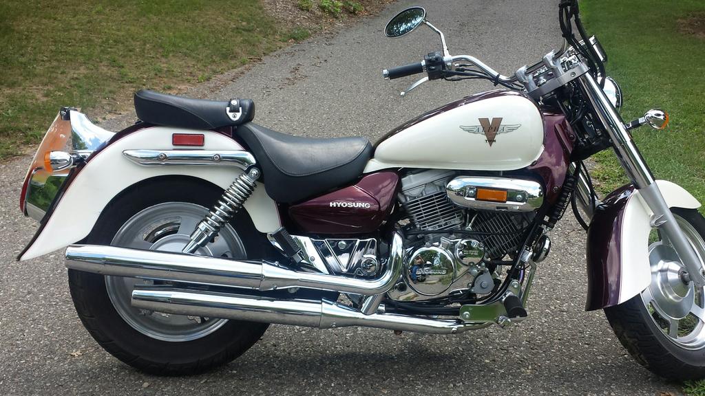

  18. 2004 Hyosung Alpha Twin for sale. 6000 miles $1700.00 I have never heard of one let alone take a picture with my phone before. A lady came out and told me all about it. It was her bike and she bought it brand new. 250cc weighs 300 lbs. and a Suzuki engine. She had foot surgery and does not want to ride any more. Not a bad looking bike. She has the soft saddle bags for it also.

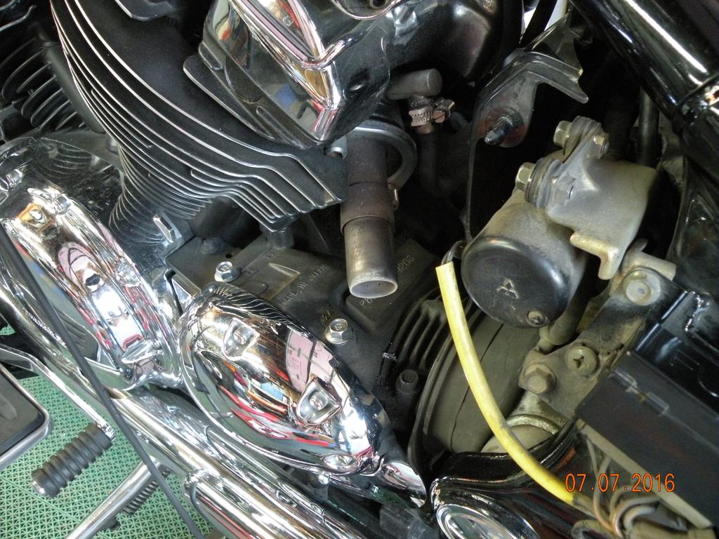

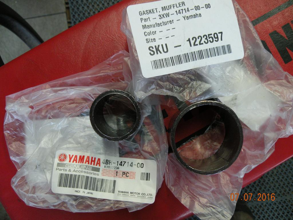

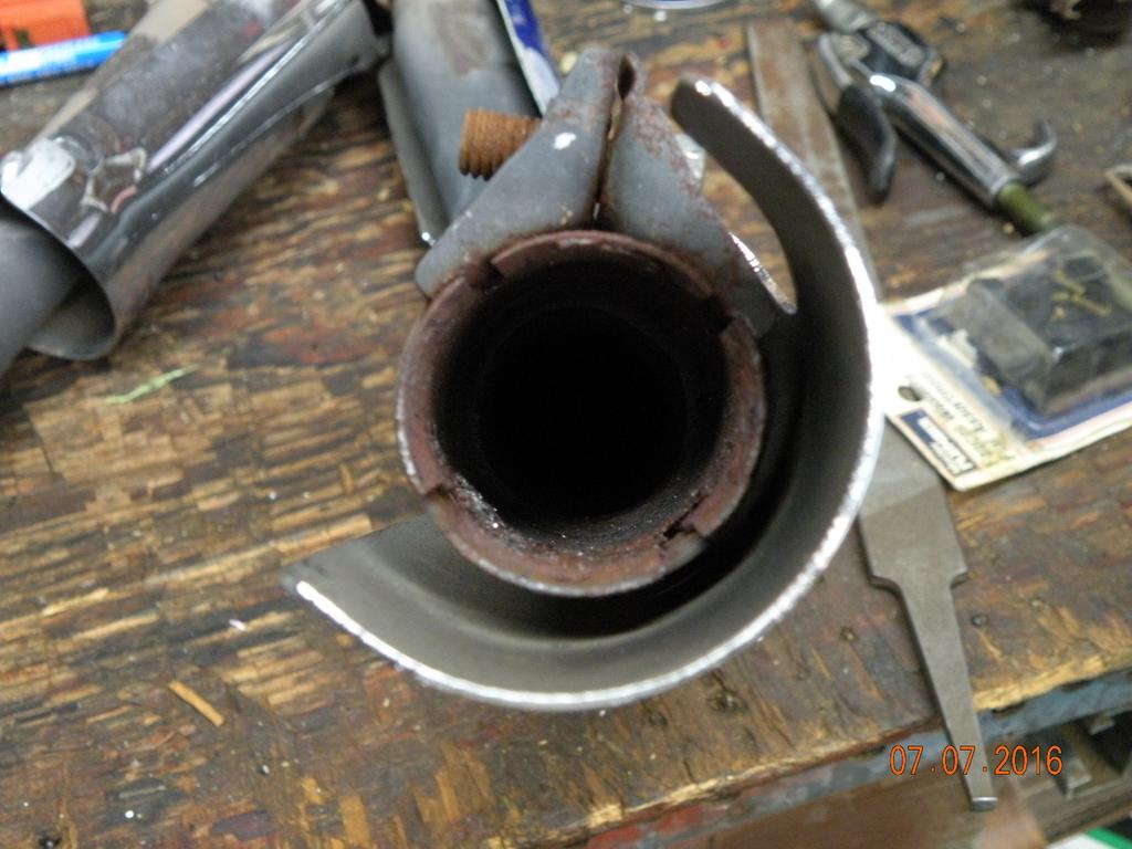

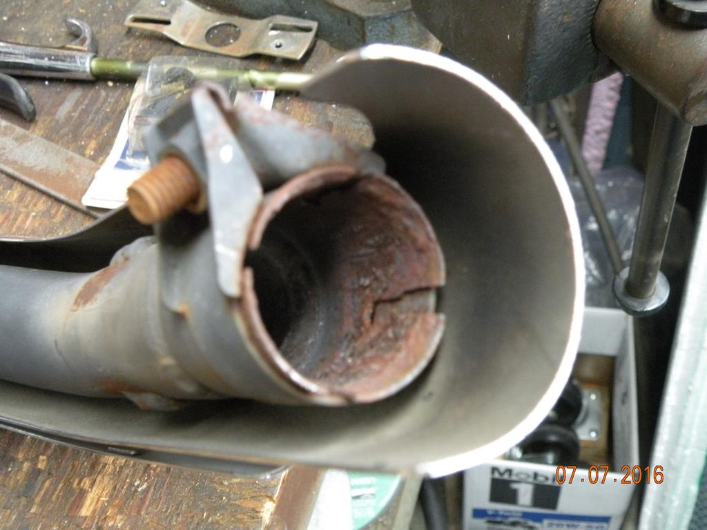

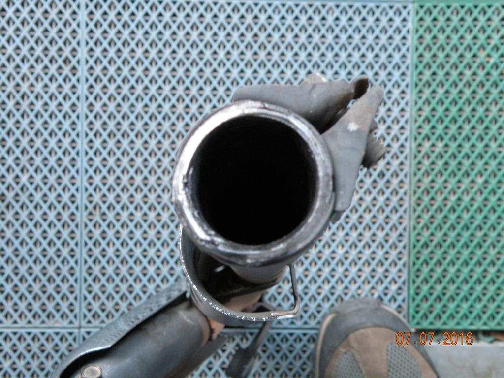

  19. I had been having backfires going on for about two years. Had Don sync the carbs at M-Day this year like never before. He did a fine job for sure. Puk had mentioned before M-Day that maybe Gaskets were leaking. I tightened everything before M-Day but still backfired on the way down and still got it on the way back home after M-Day. Anyway I changed out six of the Gaskets. Three on each side and now I am Backfire Free.:happy65:Here are a few pics. I really had to clean out the old gaskets before replacing with new. I used a drum sander to do it. The backfire was really annoying after awhile. I am very happy with the outcome.
