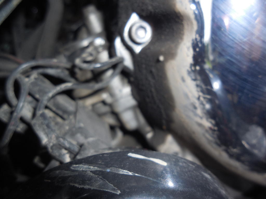

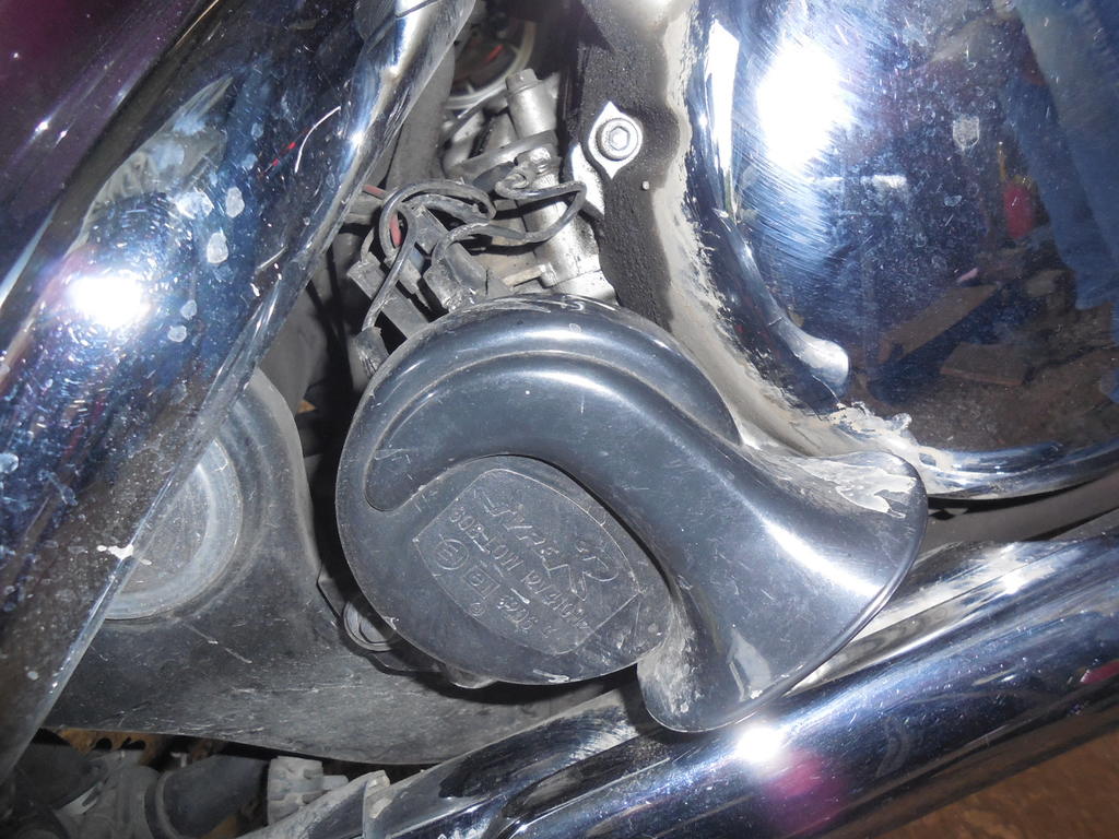

Let's see if this pic shows it better... It could be something else, thought it was a leak from the clutch cover, smell a bit of gas now and then, usually only when she's tipped on the side stand pretty far. All 4 float valves and bowl gaskets replaced fuel float height checked and tested under fuel pump pressure. Antifreeze is up to level in the bottle, haven't messed with it at all.

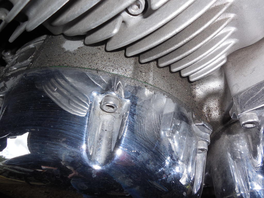

Anyone else get this? was cleaned well just before a 2500 mile road trip. I have a new gasket on hand was wondering if there are any "secret" issues I should know about there. I have not done any clutch mods, and so far clutch is working fine. I ride mostly solo, long distance (other bikes for town riding) and have a pretty well educated clutch hand. Mostly unrelated; bought bike last August with 10.8K, it had a plugged relief port in the clutch MC got that unplugged, and bled,now at 20K during last weeks road trip I had a non op clutch after it had been parked overnight at a pretty good angle, fluid was very low, got it working with lots of lever pumping added DOT 3 (only thing available at a tiny nearby town) and came home with no problem but had to add a bit more fluid, I see a leaky slave is not uncommon how hard is the R&R? Have not seen any leaks at MC.
