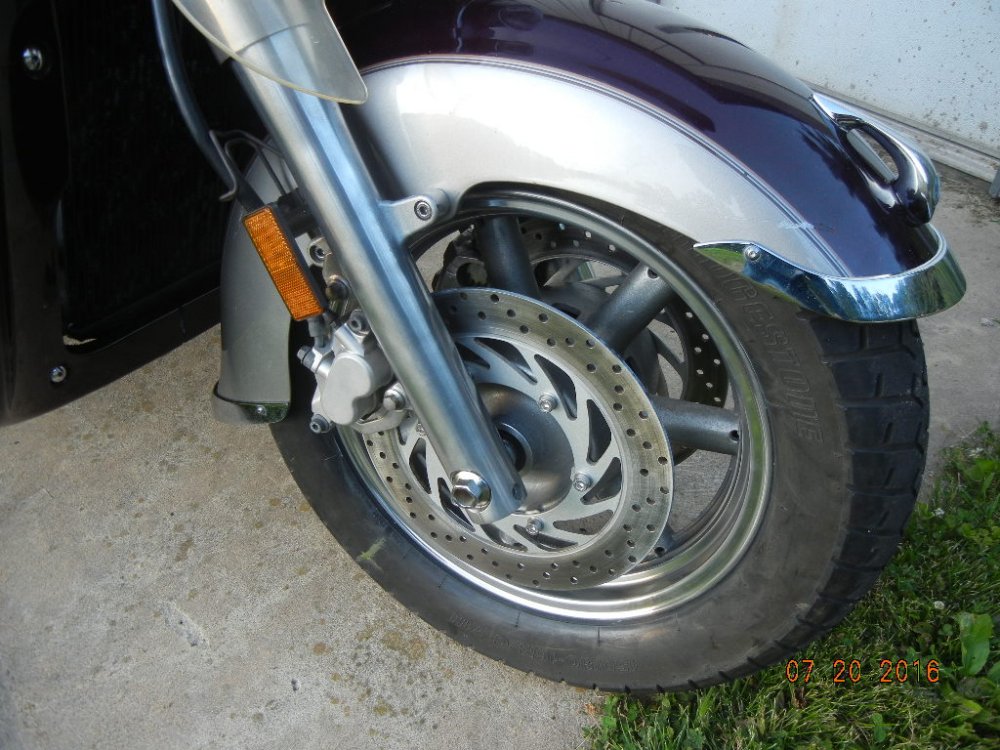

It's back together naked now. It appears the PO had the wheel on backward but now I need to check and see if the tire is on backward. I had the rotors off, is it just my bike or is one rotor on "backwards" on all of them? -

My weight was mounted on the left. but the tire had been changed before my recent purchase of the bike (2005 date code, yeah I know, but no cracks, may just run it off.) I see no difference side to side on the wheel? IE is there a left or right side to the wheel? I did mark it, but who knows if the last guy did..... I'm pretty sure the chrome is staying off on mine. Just stripped the flaking clear coat from rim and fork legs. -

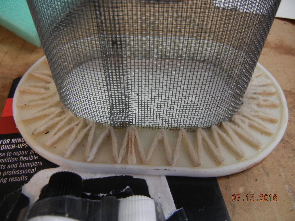

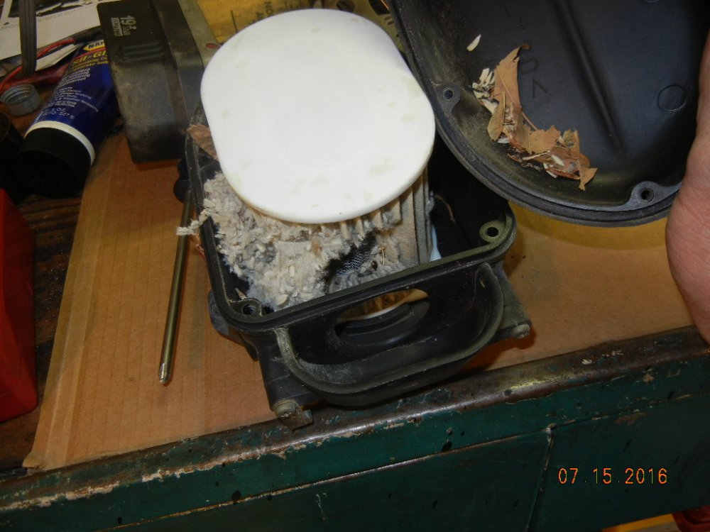

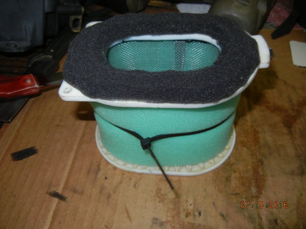

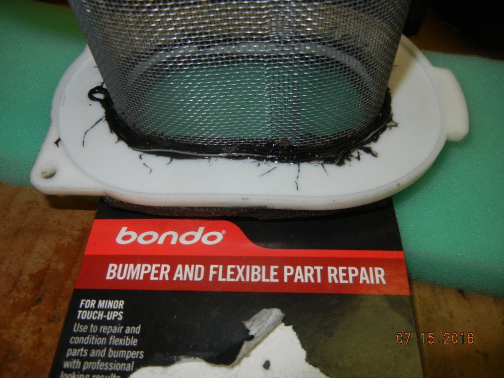

Just did this on my RSV when I found mr. mouse had been busy. I use a zip tie to secure the foam and remove it to clean and reoil. The foam is a tight enough fit I'm not worried about air dirt getting around the edges. The paper was separating from the end with the hole so I finished the job and glued the screen to the cap with flexible bumper epoxy (handy stuff) I have been doing similar on my XS650's for years. One sheet cut in half the long way then trimmed down a little more does both filters on the RSV only one seam per filter. Not shown but I bent up some soda can aluminum to keep the seam airtight. I also replaced the mushy foam seal with some black UNI foam. Note Uni sells several different foams from coarse to fine hole size. 42 MPG on the first tank run this way.

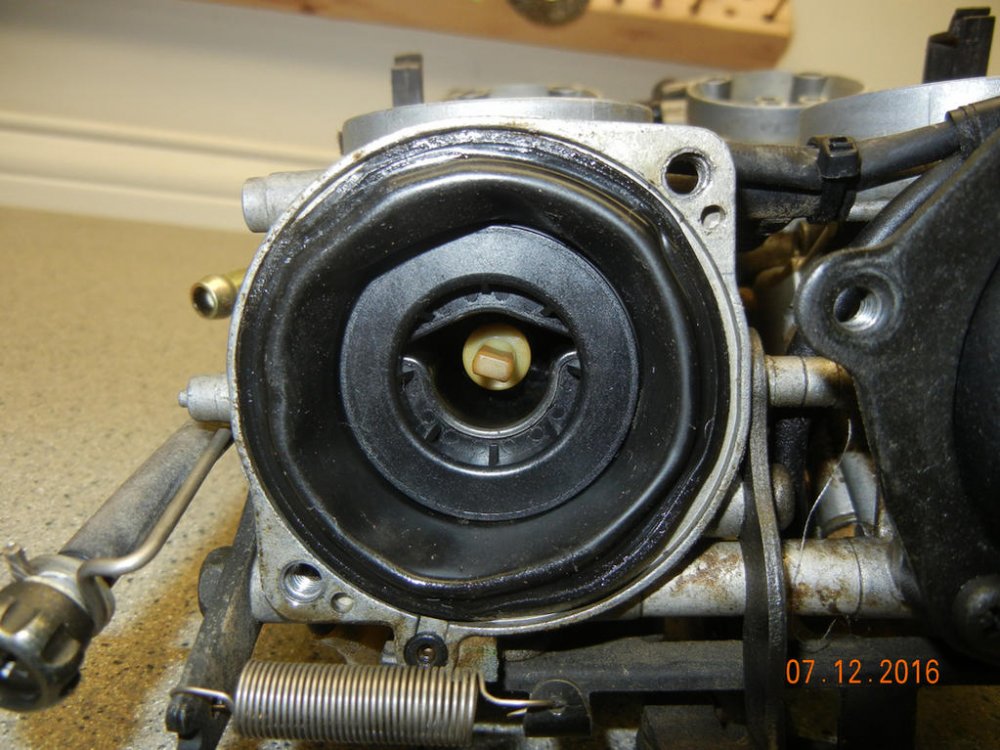

Hadn't been into set of venture carbs for a while, but a new to me 99RSV had been fuggled by a "motorcycle shop". Gas was dripping, pouring out of the carbs, couple things I found; \\ three out of four rose.......... Turns out "mr cycle shop" wasn't the sharpest pencil, but he only charged the PO a few hundred for his carb "services" after lubing with a bit of dielectric silicone grease I gently stretched the diaphragm over a spray can for a few minutes, this let me get it in the body groove and get the cover back on, rechecked with compressed air, all FOUR slides now rise as they should. The adventure continues, pulled the float valve on that body, o-ring and float tip look good screen was clean. Will go through all four, checking all jets, orifices, will set floats (thanks Goose). Gonna kill me to have wait for bowl seals to arrive. Anyone got a down and dirty seal swelling trick that won't stretch it out? I'm hoping to get this beast in shape and do a camping Lake Superior circle tour in August!
