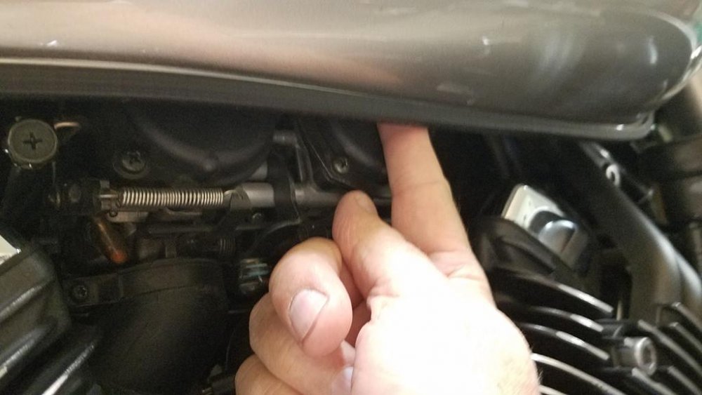

Jeff, If you do want to offer this kit to the masses (us)...then you need to take into account the 2nd gen gas tank partially covers the diaphrams on the carbs....IE... need a right angle injector or plenum for each carb. Wonder if this might be a good time to mention two injectors on a throttle body deep in the "V" where the carbs now sit, feeding 2 carbs each, may be a lot easier...or whatever it takes for our V4's. But thinking vertical here... Here is a pic of my finger stuck in the small space between the carb cover and the bottom edge of the gas tank.

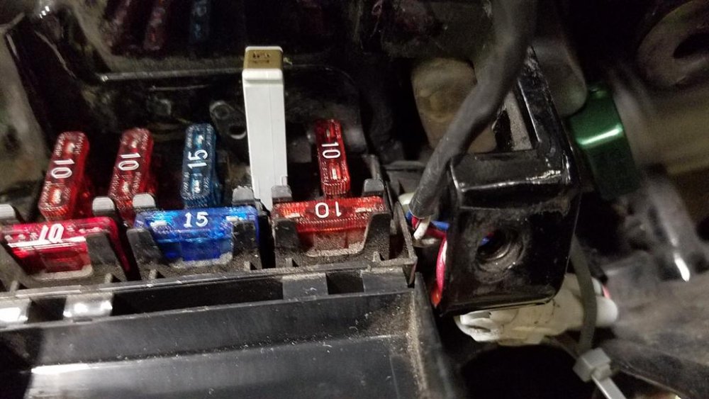

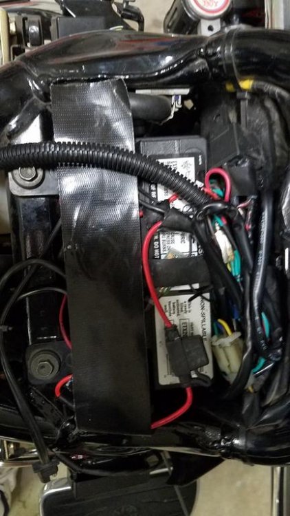

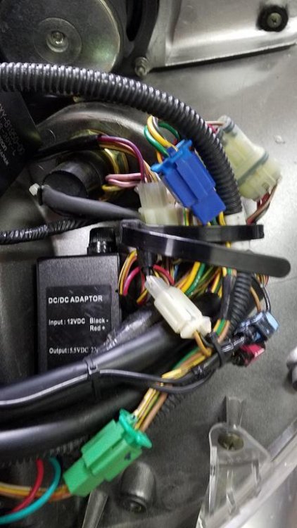

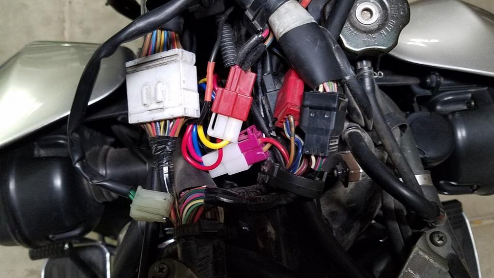

Final report, hopefully. She runs. Have no clue what I did yesterday in my taping up everything I could find that might cause a problem. But I must have caught the culprit. Ran 20 miles this morning. On the access roads that are really bumpy to the freeway at 75 with cruise. No hiccups. So, apologies...I can't say what was causing the problem. Nothing really stood out for shorts, crimped or broken insulation at any wires. There were some questionable but if I didn't have the problem, I wouldn't have taped them to begin with. Crossing fingers this problem is history.... Now off to store to buy some fast curing JB Weld. Seems I broke a speaker lead off the speaker in the left front while I was pushing, shoving and yanking on wires yesterday. Little phenolic board broke right off speaker frame. Makes me wonder what else I did? Grins! Guess I WILL find out! -

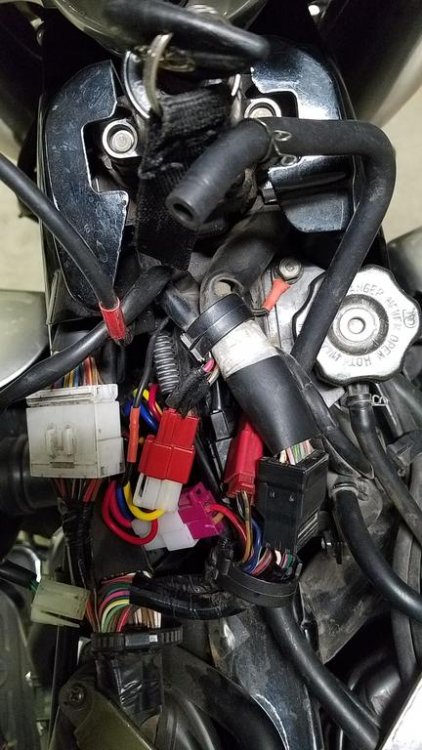

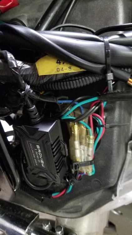

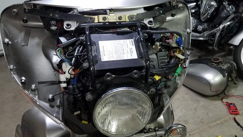

Gary, I thought I did. I'll go back out and look around again! Thanks. Update: Went out and looked over the neck area again. Nothing stands out as looking like it's rubbing. Did another walk through everything from front to back. Found one little wire from LED right side rear...marker light conversion...that "might" have been crimped by the right side panel covering the relays. I put some tape around it...taped it again along it's length then put some epoxy/tape on edge of panel. Since this is the lower end that I can't see, I'm ok with that as it's a tight fit between the edge of the panel and the wires. And the edge of the panel isn't dull by any means. It is now for about an inch! I also taped the wires hanging down from where I bypassed the right side horn to trigger the relay for the Stebel. The bunch were to close to the exhaust cover...and that's metal and hot. So they are tie tied up and taped. Bottom line: She's back together. As soon as sun goes down...I'll take a ride around neighborhood. We shall see....at least I got a chance to clean the insides better and check on nuts and bolts. Always a good reason to poke around on a scoot. OH...found my long lost seat bolt. It just fell out while I was taping the horn wires. Funny how far away that bolt was from the seat and never fell out in hundreds of miles of roads!! Maybe putting a lanyard on those bolts is a good idea afterall!! -

Update: Nothing. Nada. No joy. Can't for the life of me repeat yesterdays tracing that blew the signal fuse and the main fuse. I bought 2 circuit breakers, 15amp and 30 amp to replace the fuses so I could continue to trace. They self set after a few seconds when short goes away. Kinda cool actually. Saves me the time and trouble to sit my butt down and replace fuses.... So starting at the front: Checked out everything around the headlight where I was fumbling around with my hands installing the LED bulb. Even checked the speedo area...nothing. Then... checked the adapters to make sure I didn't screw that up while playing around with the headlight. All looks good here. Then... Checked the wiring around the 12 volt accessory outlet where PO had done some stuff. That was good as well as my power supply for XM. So... Moved on under the tank. Pulled out the ignition switch bypass relay and wiring. Looks good there too. But went ahead and taped wherever the brown wire went. Next...moved down to the battery area where I connected up the LED reflector lights and set myself up for towing a trailer with extra connectors...maybe someday. I also checked the battery connections, cleaned and tightened them up while I was there. Pulled everything out....taped up anything that even looked strange....but nothing blew the breakers despite my wiggling. This is where I was beating up yesterday and blew both fuses. Maybe I fixed that problem. Who knows? So moved on to the rear end... Looked everywhere. Checked my LED wiring, the LED tail strip, the bulbs in the tail signals, the brake light, the HD bracket run/stop lights. Nothing would short out the signal system. During all these tests, I left the ignition on with the emergency blinkers on to load up the signal system so I would know when the fuse blew. So came back to the main fuse area.... You can see the light colored circuit breaker in the signal fuse slot and to the right, the green thingie is the main circuit breaker in the main fuse slot. Wiggled and moved everything, including PO's wiring underneath and my plug and play wiring for the speedo correction circuit board...nothing. Frustrated as the signal system seems to be intact with no shorts. I really don't want to put her back together and go for a ride, only to have the signal fuse blow again...meaning I haven't found anything. Right now she runs for a long time in the garage with no fuse issues....just like when I was on the road. It was only when I got back on the road did the fuse blow. BUT...I've wiggled, jiggled and yanked on anything and everything I can see...including the horns down below. The only thing I haven't done is take apart the switches on the handlebars. I really don't think that's the problem as I only read about one person, after all these years, having a factory wire pinched in the handlebars.... so that is such a long shot....I'm leaving that out for now... So I'm asking the collective great minds....what have I missed? TIA... david -

Update: The above didn't fix the blowing fuse issue but did fix the LED marker light not working properly! Back in town and will dig in some more. Last week, I did retrace lots of connections, finding nothing. So guess I'll take the fairing off and start all over. I'm getting to be an expert at removing the front fairing....guess that's a good thing. Maybe I should add some driving lights too while I'm in there! I'll follow up when I get this sorted out.... -

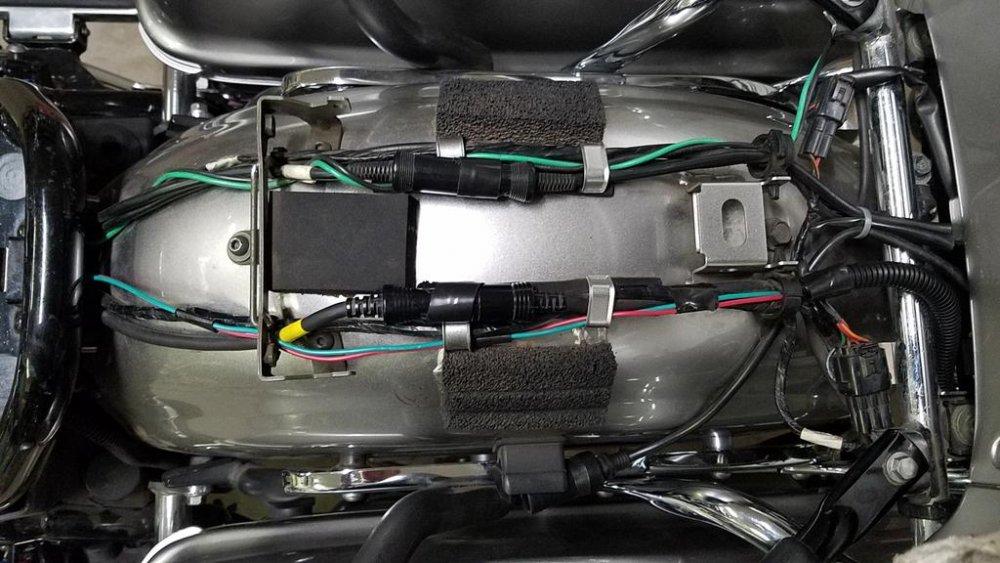

Update: Finally got home today. Took the seats off and looked at the adapters/connectors and such that was under them. I ordered the connectors from Steve here on the site and added them to the rear in case I ever add a hitch and then in the front as well under the fairing where I wired in the LED reflector lights as running/turn lights. Everything fine there... The left front LED reflector light wasn't working so I took the fairing off and was poking around and found one connector had pulled out and it was the hot lead for the led reflector light!! Crossing fingers that was it, I plugged it back in, tie-tied it in place just in case it comes out again, and fired up the bike. Ran for about 5 minutes, testing turn signals, brakes front and rear and all together. Fuse didn't blow. Decided to rebuild a tab on the plastic chrome strip for the windshield....so tomorrow I'll test again and then put back together. Maybe grab a quick ride before it gets to hot just to make sure that was the problem. Thankfully...it was a little thing! (hopefully) -
