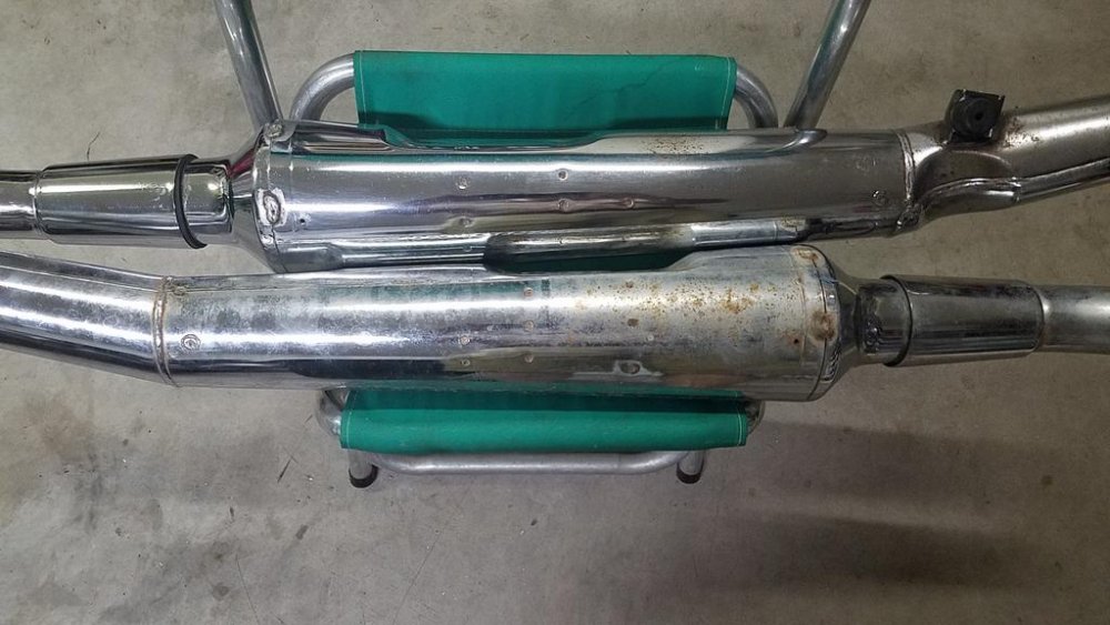

  18. UPDATE: Last week, I got a clutch MC from KIC.....he also gave me two pipes for my 89 as one of mine is seriously rusted out near the rear of the muffler tip. (BTW, thank you Bill!), I took them home and went out to clean them up. Well, here I am...sitting on the garage floor...hand scraping with aluminum foil and the Boss comes out with some goop. She says: "Try this...will work much easier". I try it. Grab a clean handful of foil and go to work. Oh my....rust and discoloration comes right off! Needless to say...it worked. So here is the secret formula. Permission from the Boss. She did say it didn't work quite as good as a shower cleaner...but even she was impressed with how it took off the grease, grime and rust! and the results...on one pipe. Just sayin....
