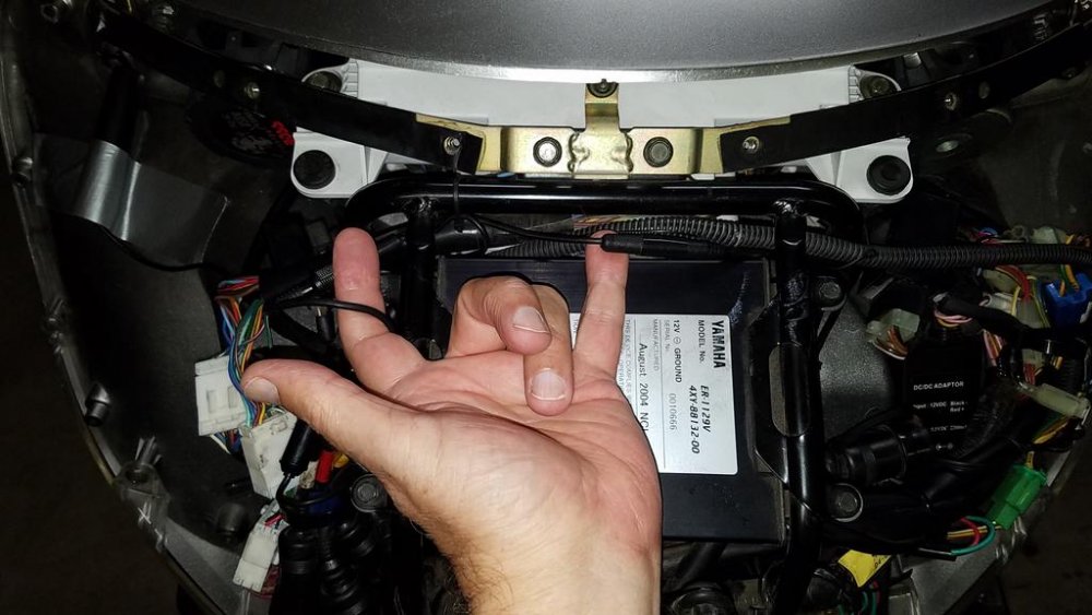

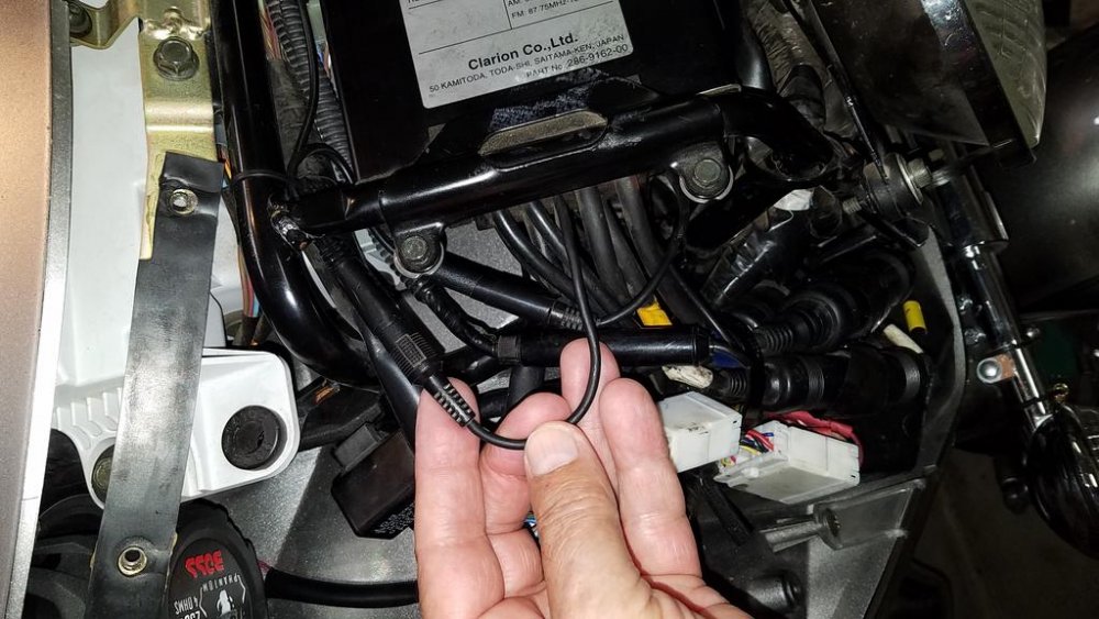

That is correct. My XM is sitting on that connector. Leaving me the Aux connector by the cassette to use....if I ever need it.
Easy answer, with no ignition noise, the audio will be clear as a bell. You are right....grounding or wiring. See you when you get back...be safe
Have to say, John, you've come up with a good one. Unless the aux input cable coming into the amp is bad....oh...there is a connector between the two. Dam....just remembered. The aux jack by the cassette door wire runs about 6 inches or so to a female connector that is the wire from the amp. The connector is located about midway between the two. Did you see that and check it? Regardless...see you when you revisit this after your trip. Have a good one and be safe! My pinkie is touching the aux connector that goes from the amp to the aux plug by cassette.

More thoughts: 1: Make sure the audio amp ground is good. IE, take it off, use a wire brush to clean both the wire contact and the frame area, put back together. 2: Using an ohm meter, check to see if the signal ground is also the chassis ground. On the OHM setting, put the meter leads on a good known chassis ground, then use like a spare mini plug without wires, or one with a broken off wire (headphones) and check for resistance between the chassis ground and the shield ground...usually the part of the plug closest to the wire end (3rd contact area closest to wire). Do so with the system off. The tip and ring are for left/right signal. Today, and since the beginning of transistorized circuits, some manufacturers tie the signal and chassis grounds together....while others "float" the signal grounds. The latter solution isn't really kosher but works well for the most part. On Motorcycles, where ignition systems/wires run very close to audio, this really isn't a good idea. However, due to circuit design on the amps, etc., you probably shouldn't try to tie the systems together as damage may occur. We simply have no idea how the amp is designed...and no schematics so we could check it out. If we could, the solution could be simple. Most noise on an unbalanced audio input...ie...the aux circuit on the RSV...is coming/traveling along the shield of the cable and not being grounded before it enters the amp system. The problem is how to stop the noise or at least lower the noise floor so the signal is loud enough to be heard without the noise being a bother. Cranking your GPS volume up would work if you could do that. You added a choke to the power of the GPS, so we know that's not the whole problem. If you have an adapter system that adds the GPS signal to the 5 pin cable, then the noise problem is within the adapter as the 5 pin system seems to be pretty well built/routed/shielded. Within the adapter is going to be the circuit that mates the two signals and supposedly does so with the proper impedance (level matching) as well as filters the audio from the GPS AND is a grounded/shielded box to protect from stray RF from getting into the adapter circuit board. That's as far as I can go for now. Awaiting your responses. david
John, From your description, you've been through about everything I would check for. Questions: 1: Is the GPS connected through the aux circuit? 2: cuts in and out? Power or signal? 3: Choke in power wire. Good. But. Did you also look into the signal wire? The aux circuit is an unbalanced circuit, so it will pass ignition noise on through the circuit. Thought: Did you look into re-routing some of the wires or wrapping them with aluminum foil or a metal mesh that you can ground>

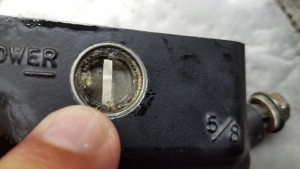

OK...got a chance to go out to work on the 89 this morning. Went to try and get the old sight glass out of the spare clutch MC that I took off a parts bike that @KIC and I picked up from a generous couple who own a VR Trike. They donated their parts bike to us for our use. The glass/plastic(?) crunched out in pieces, yea it was that far gone. But is this all there is? Is there a ring or something holding it in? Or just glued? I did order the replacement kit @Prairiehammer posted a while back and some crystal lenses that were posted as working as well (just in case). TIA
