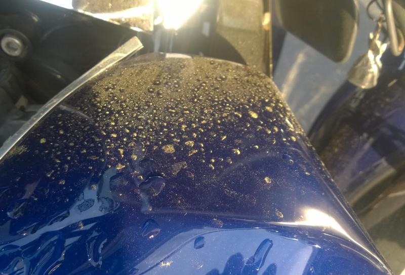

	Well a bunch of Life smacked me in the face since the layoff! My Girlfriends is having heart problems and complications from diabetes, so me being out of work has helped a bit, I can take her to Doc and help ask the right questions. My little Dog slipped his leash ran across the street and bit some snobby ladies little dog, I offered to pay vet bill, she called the cops now I got to deal with that. Had to cancel my trip to Bikeweek. The Oak tree pollen has turned by beautiful Galaxy Blue venture kind of yellow green the day after I detailed it!!!!! The house I used to own with the almost Ex may close this week, can't wait to see what the wright off is and if I get to pay taxes on the short sale. Parts I ordered for the kids bike were backordered so its still on my back porch making my neighbors real happy! But I look on the bright side, I got an interview with both Home Depot and CARQUEST this week, my brothers company is thinking of starting a new division, the problem is they didn't have the right guy to run it (till now) so that may come into being this month!

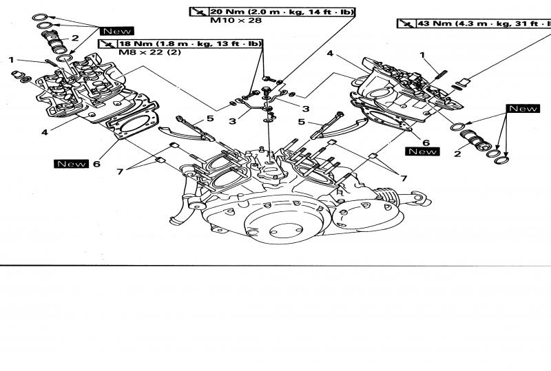

	okay checked the decks and the head for warpage both are in tolerance. the chain , cam sprockets and other top end parts look good. very minor carbon build up. So I beginning reassembly. Now I did it on this bike 5 years ago.. but then I had a shop a lift lights on stand air tools assemble tables parts washer bead blaster and a place to leave everything out for a few days. Now I have a few hours a day, before the light goes and the neighbors get cranky and I have to put every thing away. no compressor but I do have a lift. I know I went through this before, but the shop manual is kind of iffy on some details, and my memory is contradicting the manual any way. does any one have a better sequence of drawing or pictures of the assemble process? I'm stuck with the timing chain dampers!! according to the manual the two piece dampers (*see 5 in pic) are on the carb side of both heads. and the single piece chain guide is on the outside or exhaust end of the head. however the cam tensior adjusters are both on the rear edge of the head or on the rear head under the exhaust on the front head under the carbs. that just doesn't make sense to me, and my memory is foggy enough that i'm not sure any more, the polish marks from the plastic tensioner in the head would seem to agree with me. But the issue is I can't get enough slack in the chain to install the cams now, so do I pull the head off again and move the tensioner or am I missing something?

Update and question if I may. So got rocking on the job. the front head gasket (not the one I replaced before) seems to be the problem. This is the issue the gaskets is 3 metal layers and 5 paper layers from the factory kinda like a club sandwhich, paper metal paper metal paper metal paper. All the paper is gone POOF no remnents at all! Just the three metal leaves. I pulled the radiator and hooked up the garden hose and tighted a clamp, when i turned on the water it puked out about 1 or 1 1/2 cups of whitish yellow pulp then some rust then clear water. what would make the gasket behave in this mannner? -

okay so the bike starts and runs! yea!!!! Oil is oozing not pouring out of the gap between the head and the jug. I've had the heads of this beast years ago. I even have a dealer head gasket in the tool box! If I remember correctly the only bear was timing it. There is/was a footnote on the one page of the service manual, saying that I had to rotate the crank or something when timing the rear cylinder, but that line wasn't in the main text. well waiting for the flatbed to arrive here. I guess my weekend project is all set! gonna do a cooling system flush and replace all the hoses while its torn down, and maybe take a stab at the neutral/side stand interlock (bike wont run in neutral with the kick stand down anymore) may even do the J -mod while I have the carbs off
