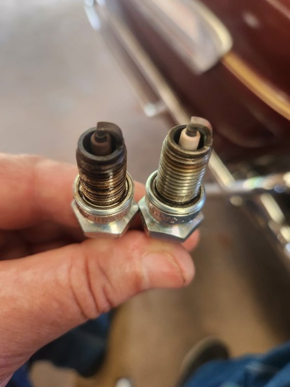

dmoffitt Posted August 13, 2023 Author Share #9 Posted August 13, 2023 I'm back with new numbers. I pulled the plugs and did a compression test, all cylinders were 120 to 125 PSI, Reinstalled the plugs and checked carb balance. All carbs indicated within 1 inch of each other at both idle and ~2500 RPMs. Although the readings were even, they were all lower than I would expect to see @ 10-11 inches at idle. Vacuum would increase to 15-18 inches at 2500 RPMs, deceleration vacuum would jump to 20-25 inches then settle back to 10 inches. The only other thing I see, take a look at the pic. Both cylinders 1 & 2 look like the plug on the left, cylinders 3 & 4 look like the plug on the right. This is after about 400 miles since install. Link to comment Share on other sites More sharing options...
Marcarl Posted August 13, 2023 Share #10 Posted August 13, 2023 In MHO the left ones are running rich or not getting a complete burn. The ones on the right look good. So that could be part of the issue, but I think there is more hamburger in the pattie, somewhere. Link to comment Share on other sites More sharing options...

saddlebum Posted August 14, 2023 Share #13 Posted August 14, 2023 #1 did you remove the air cleaner #2 Did you make sure throttles are wide open #3 Make sure you have optimum cranking power add a boost battey or good charger Manual states 216 psi @ 175 rpm. This is for a fairly new engine and will reduce as the engine ages. Most used engines run between 110 and 130 PSI and no more than 20% between highest and lowest cylinder. Last time I checked mine they were 98- 120 psi and the engine runs like a dream. In any case I would not loose sleep over the readings you are getting and look more into fuel control for your rich fuel conditions. Link to comment Share on other sites More sharing options...
videoarizona Posted August 14, 2023 Share #14 Posted August 14, 2023 (edited) I'd take the carbs off and check the floats. Left side is real rich and that can easily be float settings on left side carbs. To add to that, the float seats may be dirty from sitting and allowing to much fuel into bowl. Or not allowing float to move properly. Regardless, go over 2 left carbs with a fine toothed comb ( so to speak) Edited August 14, 2023 by videoarizona Link to comment Share on other sites More sharing options...
