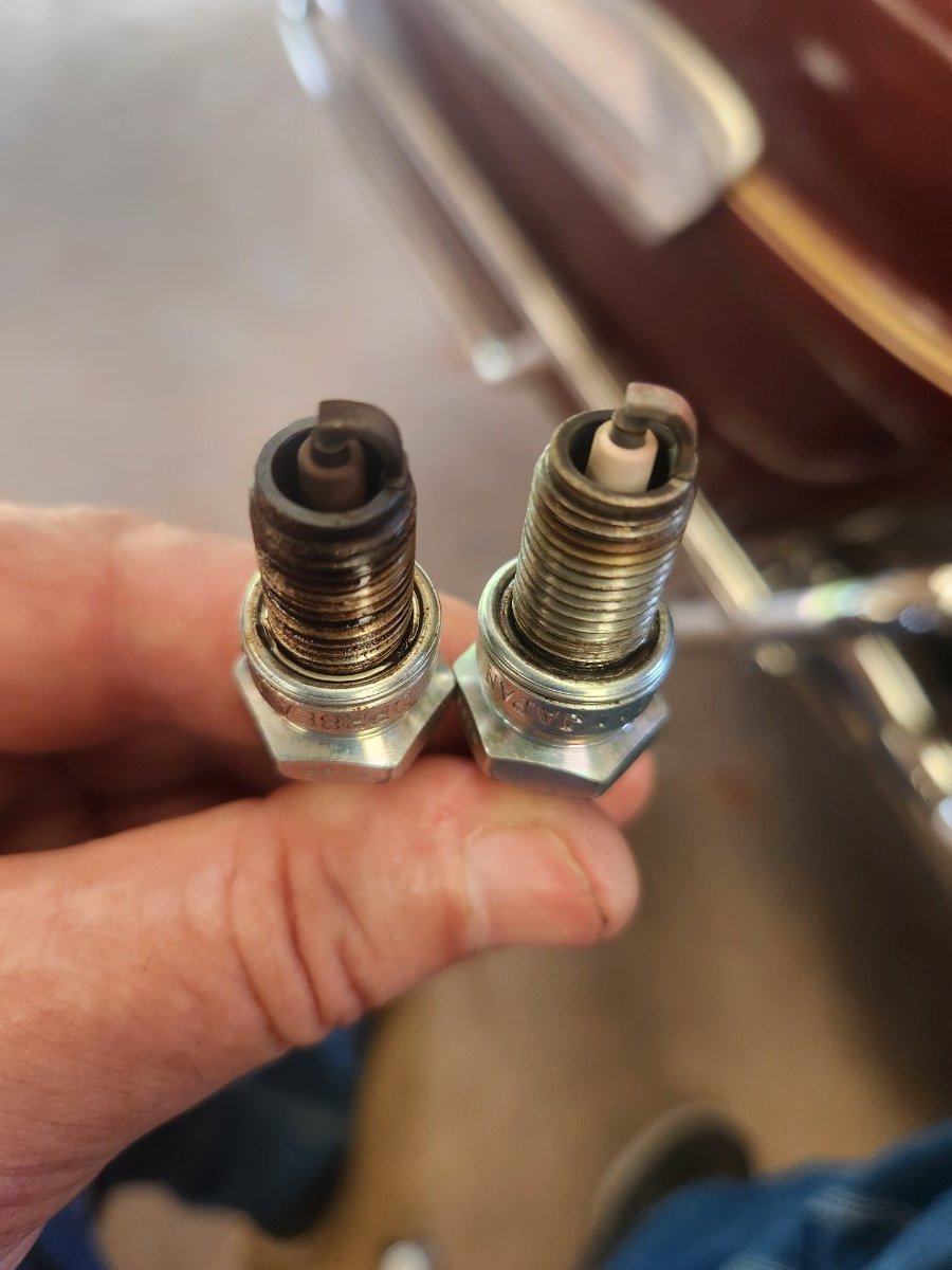

  4. I'm back with new numbers. I pulled the plugs and did a compression test, all cylinders were 120 to 125 PSI, Reinstalled the plugs and checked carb balance. All carbs indicated within 1 inch of each other at both idle and ~2500 RPMs. Although the readings were even, they were all lower than I would expect to see @ 10-11 inches at idle. Vacuum would increase to 15-18 inches at 2500 RPMs, deceleration vacuum would jump to 20-25 inches then settle back to 10 inches. The only other thing I see, take a look at the pic. Both cylinders 1 & 2 look like the plug on the left, cylinders 3 & 4 look like the plug on the right. This is after about 400 miles since install.

  6. I just went out and checked to see if it was firing on all four cylinders by taking a temp reading on each cylinder. I removed the dog-bones and took the measurement from the head, next to the spark plug. At idle, all cylinders read within 10 degrees of each other up through 180 degrees as near as I can tell. I tried raising the RPMs but getting accurate readings while holding the throttle open was problematic at best. But I'm pretty sure it's hitting on all fours.
