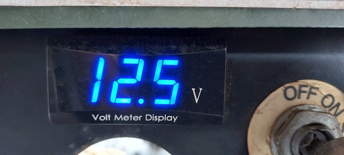

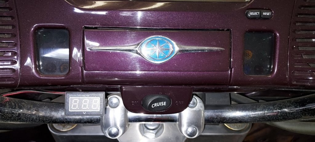

Heartbeat Posted May 3, 2022 Posted May 3, 2022 (edited) Here are small weatherproof voltmeters that I have found on ebay and/or Amazon. On my Venture, I used one that is more of a box shape and used doubled faced molding tape to attach it to the underside of the dash and put a plug on it to plug into the cigar lighter. I plan to wire it direct the next time that I have the fairing apart. The second picture is one I have found since that is more of a flat design. I like Woody's solution as well. Edited May 3, 2022 by Heartbeat 1
YamahaLarry Posted May 3, 2022 Author Posted May 3, 2022 6 hours ago, Heartbeat said: Here are small weatherproof voltmeters that I have found on ebay and/or Amazon. On my Venture, I used one that is more of a box shape and used doubled faced molding tape to attach it to the underside of the dash and put a plug on it to plug into the cigar lighter. I plan to wire it direct the next time that I have the fairing apart. The second picture is one I have found since that is more of a flat design. I like Woody's solution as well. I saw several on eBay last night that looked just about like that. Measurements on most of them were just under 30mm in height. Was gonna take a quick glance at lower portion of dash today to see how much room I have but you've answered that for me. Yes, I like @Woody solution as well, but when I lead my charity bike rides I plug my GPS into that socket. I've had issues trying to use a USB charging cable with my Garmin in the past, but I haven't tried it in the past few years. Thanks!!!
