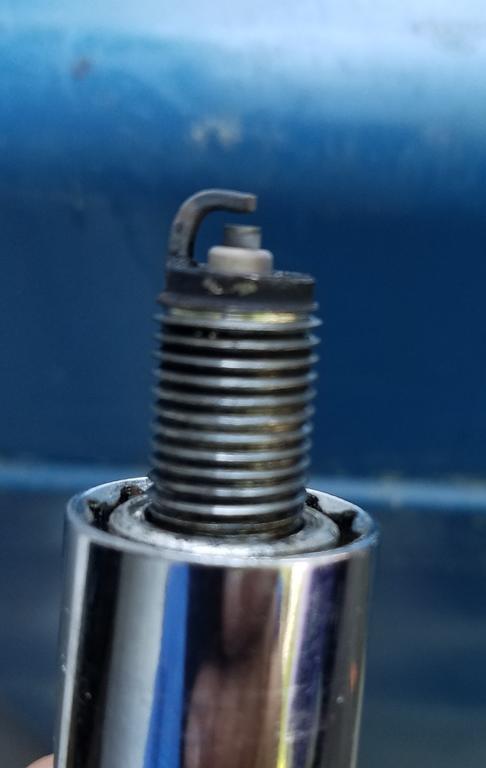

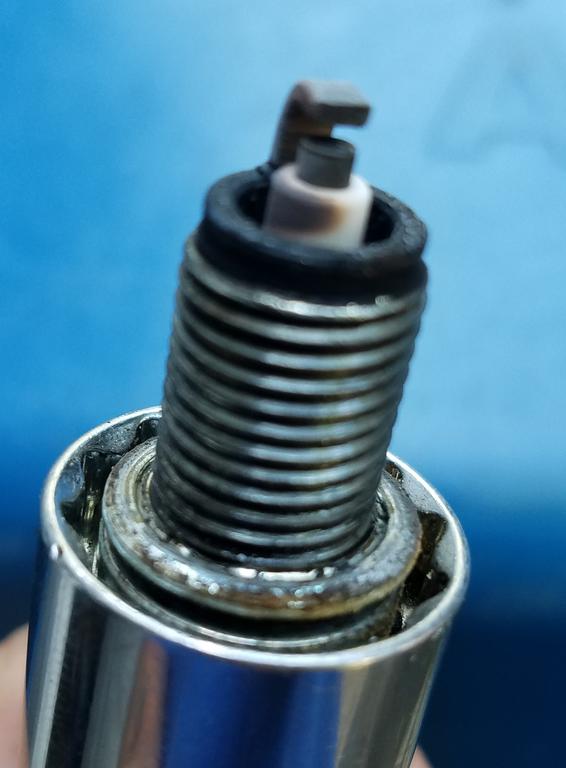

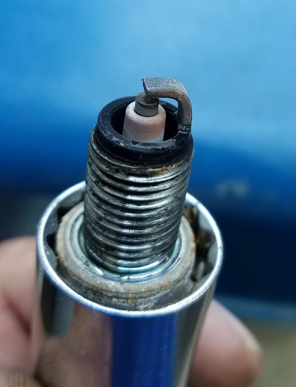

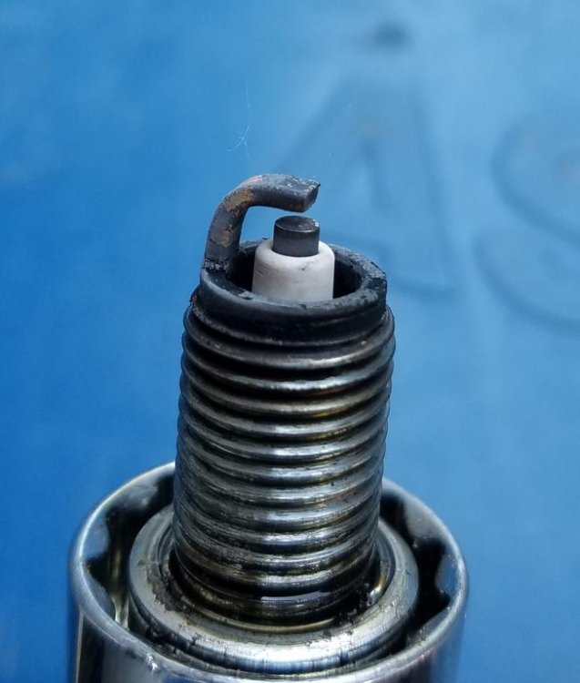

luvmy40 Posted June 29, 2018 Author Posted June 29, 2018 I got some pics of the spark plugs and I decided to play around and do some vid clips. The popping and stumble doesn't come through in the audio as well as I'd like but here goes. The plugs all look way lean to me. N0.1 No.2 No.3 N0.4 I re tuned the pilot mix to best highest vac and ended up enriching all 4 cylinders a good bit. After bI got them tweaked to the highest vac. I opened them up 1/4 turn further, Then synchronized. Here's the result.

Patch Posted June 30, 2018 Posted June 30, 2018 So Luv I'm not hearing crisp acceleration. Not impressed by the plugs. I'm not sure how you are trying to adjust, pilot screw by vacuum, although I think I get what you are saying, vacuum is a result of jug and throttle plate position. 1st thing we need to know compression numbers. The idle circuit needs the compression for heat. can you put together an unclolorful list of all changes to the carbs. Are there any vacuum leaks at the intakes, you read how I check.. When checking is there ever any back pressure up the intake. even though you have mentioned popping at the carbs. What checks did you do to the coasting enrichment circuit times 4?

Patch Posted June 30, 2018 Posted June 30, 2018 OK Luv;) So your tests read high and this is going to present a challenge. Not having them right in front of me I remember pairs of 190. Why do you think they are up so high? I think I know. The 1300 limits at 192. Look at the 1st pic what is different about it? After see the numbers 1st I would deal with that, but move away from setting pilot with vacuum _ we know they are going to be different. The vacuum will also mislead when you jump over to the next circuit because of drag (another conversation) use a tach. Let me know after you look up the compression specs if you want to try and lower psi

cowpuc Posted June 30, 2018 Posted June 30, 2018 IMHO,,, Go down and buy new plugs - NGK DPR8EA-9's, get 4 of them and gap them at 32 thou so they have room to expand to grow into high spec, look at your plug caps carefully for carbon tracking and ohm em out/do a resistance check, clip 1/4 inch off the end of each plug wire and screw it back on the caps if they are good. I am far from any form of an expert in the stuff but to my untrained eye looking at the blackened edge of those plugs,,, I am gonna guess that at some time or another they got a good over choking... Plugs are cheap,,, dont bother trying to clean em,,, opt for new IMHO... That may help a lot in your bikes stumbling. I am with MiCarl and Cha,, look that exhaust system over very carefully for holes and leakin gaskets - a tiny little bit of air leak can cause a lot of snortin!!!!
