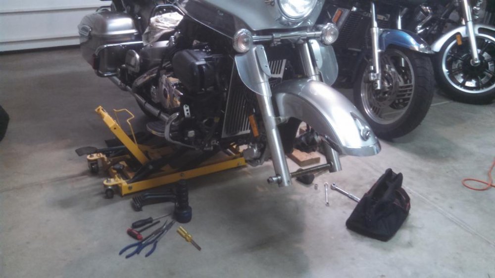

videoarizona Posted May 16, 2018 #4 Posted May 16, 2018 (edited) The only way I know with a motor cycle floor jack is Carbon One's lift adapter. It gets you above the motor and frame members that get in the way... RD's idea sounds cool.... I ran Pirelli Routes on my 2nd gen...and couldn't wait to get rid of them. They were great at first...but after 4K miles, they nibbled on every imperfection on the road. I kept the tires at 40-42 rear and 38-40 front. Edited May 16, 2018 by videoarizona add

videoarizona Posted May 16, 2018 #7 Posted May 16, 2018 Still need a center stand...like on the 1st gens....or some wood blocks....but then you have to get it up to get rid of the blocks.... I simply bought the darn motorcycle jack and Carbons adapter. It works...

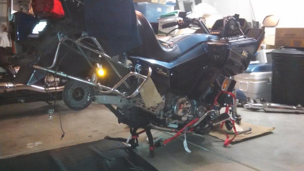

videoarizona Posted May 16, 2018 #19 Posted May 16, 2018 BTW, In addition to all above...I've used rachet tie downs to lock the center stand of the 1st gen to the engine guard. That way even when I have her kneeling, I know the stand won't fold up on me. On the 2nd gen, I always use 2 tie downs, front and rear, if I'm going to be doing some serious wrenching. Like torqueing a rear axle. That way I don't have to worry about weight shift....so far so good! Here is my 89 kneeling down while I grease the rear end and get a new tire!
VentureFar Posted May 16, 2018 Author #20 Posted May 16, 2018 videoarizona said: BTW, In addition to all above...I've used rachet tie downs to lock the center stand of the 1st gen to the engine guard. That way even when I have her kneeling, I know the stand won't fold up on me. On the 2nd gen, I always use 2 tie downs, front and rear, if I'm going to be doing some serious wrenching. Like torqueing a rear axle. That way I don't have to worry about weight shift....so far so good! Here is my 89 kneeling down while I grease the rear end and get a new tire! http://www.venturerider.org/forum/attachment.php?attachmentid=112560 Would be $90 for the two if off the bike and $140 on. I am still convinced to pay the $140. A tip over can cost me that in lights and mirror replacement.... Sent from my iPhone using Tapatalk

videoarizona Posted May 16, 2018 #23 Posted May 16, 2018 VentureFar said: Would be $90 for the two if off the bike and $140 on. I am still convinced to pay the $140. A tip over can cost me that in lights and mirror replacement.... Sent from my iPhone using Tapatalk Agreed. But as Puc mentions....you can always use the lift and adapter on your 2nd Gen. I do all the time. Even when I don't really need to lift the bike...but to hold it upright. I can check oil level, fluid levels all while not worrying about leveling the bike. It also comes in handy to level the bike when you are working inside the fairing. Lift it up enough to get the front wheel just barely off the ground, then you can easily swing the front left or right as you work. I got mine at Harbor Freight. Now, after 3 years, it does leak down, so if I'm only up a bit...I put a small wood block under kickstand so if it goes all the way down...the bike will rest easy. If I'm changing tires or have the bike up high for some reason, then I use the built in lock to lock the bike up high. Regardless....your choice. I just wanted to point out different options for you. BTW, are you heading East to MD? If so....we can meet up. I'm leaving around the 23rd or 24th...depending upon the weather around Tornado Alley. $79 at HF. They go on sale cheaper.

Sylvester Posted May 16, 2018 #25 Posted May 16, 2018 Many pluses on the Carbon One lift adapter. Don't remember what it cost years ago but it works for tires, rear end service, oil change, and detail cleanup plus much more. I never ratchet mine down since on level floor it never moves. If you remove both tires, then I block the front first and remove the rear. Then remove the front. I use my Sears bike lift I purchased in 2006 for $69.00. And I have my own bike tire changer that makes all much easier.
