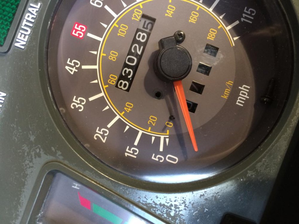

KIC Posted January 14, 2018 Posted January 14, 2018 Hi guys, I am in the process of (sadly) selling my beloved 89. As a quick background I am buying a friends Stratoliner and had planned on keeping my 89 and actually have time to work on it and really try to get to all those "little" things .. Since I just "inherited" my son-in-laws 86 Venture, I can't keep all 3 bikes and my daughter can't part with his 86 right now. So I am going to fix his up and ride the Strat for now. Anyway, I was trying to do the right thing and get the bike ready for a new owner...and was starting to get that winter "speedo whine" again. I pulled out the lil greaser adapter that Golf & Venture had developed and greased the speedo as I have done before. Anyway, now my speedo is acting weird. At first it would not work, so I reinstalled the cable and checked it so that it was seated properly. Now after several tries, when I take it for a spin it flips very quickly all the way around and stays pegged on the wrong side of that little pin. If I disconnect it from the bottom and spin it with my fingers, it will return to the correct side of the pin, but after reassembly and test ride it spin back around. I have 3 people interested i seeing the bike and really need to get this corrected....HELP !! Any ideas ?
Marcarl Posted January 14, 2018 Posted January 14, 2018 Of hand I would remove the whole issue and check for a break or kink in the jacket. It could be that the cable is hanging up on a kink and then releasing. In the process I would remove the cable, clean it with brake cleaner, clean the jacket as well and then lube the cable as it gets reinserted. Once it's in the jacket and completely inserted, I would pull it back out and lube it again. Be careful in the lube you use, ordinary grease will actually restrict the cable rather than help it turn. I would use a very light lubricant, such as Fluid Film or white grease, no axle grease or wheel bearing grease.
bongobobny Posted January 14, 2018 Posted January 14, 2018 You might also want to disassemble the speedometer and make sure it didn't get too much grease in it. Basically, the speedometer is in actuality a voltmeter and the cable drives a voltage generator. The faster the cable spins, the more voltage is produced. There was/is an issue with the odometer part of the speedometer assembly where the gears driving the odometer get messed up and then it jams. Eventually the odometer drive breaks and the speedometer functions again...

KIC Posted January 14, 2018 Author Posted January 14, 2018 (edited) Okay..so I cleaned the cable and I think I found the problem which was a kinked cable housing. So I pulled and other on off of a parts bike and cleaned that one. Now the needle is "stuck" under the pin. Won't move in any direction. Next step ??? Do I have to pull the whole console out and take it apart ? I actually have a guy driving from Phoenix to look at it and was hoping to have this fixed .. No good deed goes unpunished.. I should have left it alone and sold it as is... UPDATE: Just took it for a spin and the odometer is working but the speedo is not ....;. Edited January 14, 2018 by KIC
Marcarl Posted January 14, 2018 Posted January 14, 2018 Better minds than me would have to answer this truthfully. For my part, if it were here in my garage, I would look to see what it takes to open it up and get to the meat of things. It seems daunting, confusing, impossible, but keep in mind that sometime, some years ago, somebody, somewhere done all the work for you. They designed it, put it together and made it work,, all you have to do is fix it. If they could do all they did,, you can do the rest. Go for it!!! all you got to loose is a broken speedo, what you have to gain is one that works.
MiCarl Posted January 15, 2018 Posted January 15, 2018 Unfortunately you're going to have to remove the speedometer from the cluster and see what's going on in there. A speedometer is a fairly delicate instrument, that's why I've never been a fan of tackling a bearing howl with a grease gun. I suspect you've pushed the shaft out of the bearing and the rotor is hitting the cup.

videoarizona Posted January 15, 2018 Posted January 15, 2018 Bill, Don't know if you got her fixed....but I found this older post.. ++++++++++++++++ MiCarl: Normally when the speed indicator breaks it thrashes around instead of just laying there. Since the odometers are down stream from the speed indicator their working tells you all the drive gears are ok. I'm willing to bet that the needle is stuck because it's been a bit gummed up and the cooler temps locked it or something decided to spend the winter in there. So, it's probably just cleaning and a bit of light lube on the gems in the movement. You'll have to pull the cluster to get to it: - Remove the CMS box from the back of the cluster - it's got a light pipe on it that requires you to rotate it out. - Remove the brightness control knob (there is a philips screw down in the hole holding it to the shaft). - There are about eight phillips screws in the back of the cluster that hold the bezel on. Remove them and pull off the bezel. - Remove the temp gauge from the cluster. This is the worst part because it has 3 little nuts, washers and wires holding it in. The back of the case is marked with the wire colors so you don't have to worry about forgetting where they go. - Now you can remove the two Philips screws that hold the speedometer in the cluster. Now you can see the workings of the speedometer. At the back is a worm gear that drives the odometers. On the front of that gear is a bar that spins inside an aluminum cup. The aluminum cup is attached to the same shaft as the speedometer needle. There is also a spring to return the needle to 0. Looking at the speedometer from the back, the metal cup should turn freely counter clockwise, with light resistance from the spring. It should snap back when released so the needle rests on the stop. I bet it either has some resistance or a nest built on it. If you decide to remove the needle you need to make some witness marks so you don't loose your calibration. With the needle resting on the 0 stop mark a line on the cup and speedometerframe adjacent to it. Now you know where the cup is positioned at 0 MPH. By holding the cup so it doesn't turn you can gently twist the needle and pull it off the shaft. When you put it back together twist the needle until the witness marks line up with the needle resting on the stop. This might all sound scary or confusing, but it's all pretty obvious when you see it.
