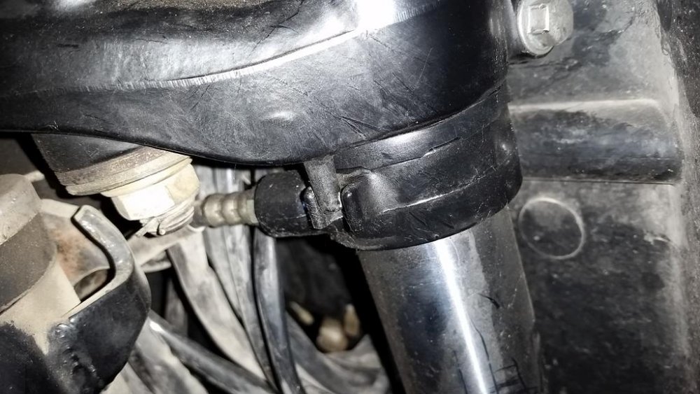

CaseyJ955 Posted September 21, 2016 Posted September 21, 2016 (edited) I've read everything on fluid levels from 5.5" to 6", I see the inlay that came with the springs says 5.5" so thats what I'm going with. Unless I'm way off here I dont think the amount of fluid will change fork behavior unless its full enough to blow through the seals or too low to offer damping through it's full travel range. Since I had progressives in it before I started I'm guessing the horribly cupped/feathered tire and shot neck bearings were responsible for the crappy ride. I cant see how to post in classifieds but if anyone here has a parts bike or any bits/pieces laying around I really could use the fork air line that supplies the left air collar, it looks like a knuckle buster to replace with the bike together so I'm sort of waiting until I can find one to complete reassembly. Edited September 21, 2016 by CaseyJ955
