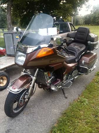

VanRiver Posted July 13, 2015 Posted July 13, 2015 She looks real pretty!!!! Thanks for sending pictures....if your have any more that is even more helpful. I personally love the 1986 brown color scheme...The idle issue should be easily cleared up with some minor carb cleaning and Seafoam. Sorry to ask...but are you sure it is 18,000 original miles and not 118,000 miles instead? It is very rare to find a 30 year old highway cruiser that has such low milage. Also, speedometers have a tendency to wear out and get replaced on these bike and therefore don't always tell the truth (and sellers sometimes don't tell the truth either). I would check the brake rotors...if they have a large lip or ridge outside of where the brake pad touches due to ware then it might be a 118,000 machine...they should be smooth like a brand new bike if it only has 18,000 on her.

volmann Posted July 13, 2015 Author Posted July 13, 2015 yes im sure its 18k..the guy is selling for his neighbor that moved down from ohio ......it was rode down from ohio 7 months ago...the old man got sick and didn't ride it. he is in the VA hospital now...said i could go there and speak with him...and its never sat outside
VanRiver Posted July 13, 2015 Posted July 13, 2015 yes im sure its 18k..the guy is selling for his neighbor that moved down from ohio ......it was rode down from ohio 7 months ago...the old man got sick and didn't ride it. he is in the VA hospital now...said i could go there and speak with him...and its never sat outside Sounds like it is time to stop asking questions and time to pull the trigger and buy the bike before someone beats you to it! Also pay the $12 to become a full member here (best investment you will ever make)!
