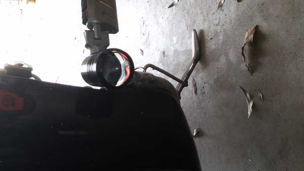

Actually mine are just above. They are LED of ebay about 30 bucks. I forget the lumines, but have hi and low beams and a modulating function.

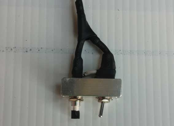

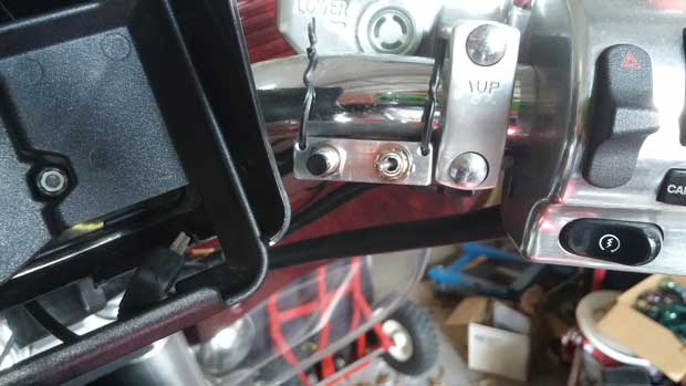

Does it have a switch for changing from Hi / lo / modulating?
Got pictures of switch and where you mounted it?
Switch-web.jpgSwitch-Location-web.jpgI used a piece of channel alum I had that the micro toggle switch (from radio shack) and momentary off button would fit inside. So switch on lights are on. You have to look at them to see if on hi low or flash. but then push button to cycle thru to where you want them. The alum bracket once I was ready a couple small holes and zip tied around handlebar.

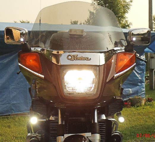

With a 12" strip of white 5630 LED's on each side of my fairing, a 1 watt LED on each mirror, my PIAA 100 watt equivalent Halogen headlamp,and this set of running / driving lights no one has pulled left in front of me lately. Some just stare at the front of my bike now. That's kinda cool.

GEDV0003.JPGThis pic doesn't do justice to the bright "eye impact" these lights make. The brightness is a bit over the top.
By comparison to the head light and the lighting in he picture they seem bright. There are so many options like size and intensity to choose from. Makes the decision difficult without seeing them in person.
Yea and pattern is big too. They dont exactly allways say its a pencil beam or a wide beam etc. And I dont know about you, but lumins other than bigger is better theroy..........
