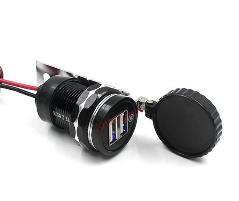

syscrusher Posted February 23, 2015 Posted February 23, 2015 Buy Snagglestuds from Bob Meyers. Ask him if he'll quote drilling & tapping 1/4-20 in center of ends for you. Buy Ram ball mounts that screw in to 1/4-20 and some other linkage like a GPS mount, a ball for the rear of that and an arm that grips a ball on either end. For power I would consider a cigarette lighter USB converter and your USB cable that came with the GPS. Or I would replace the cig lighter with a wired-in USB Charging port with a watertight pop-off cover. You can wire in a charging cable but it has to convert 12v to 5v and you need a place for it to be when it's not being used. The other solutions for power that I gave solve that and are less expensive.

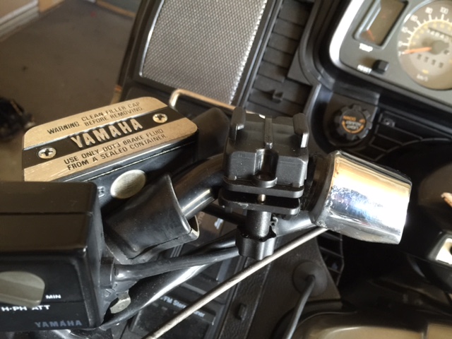

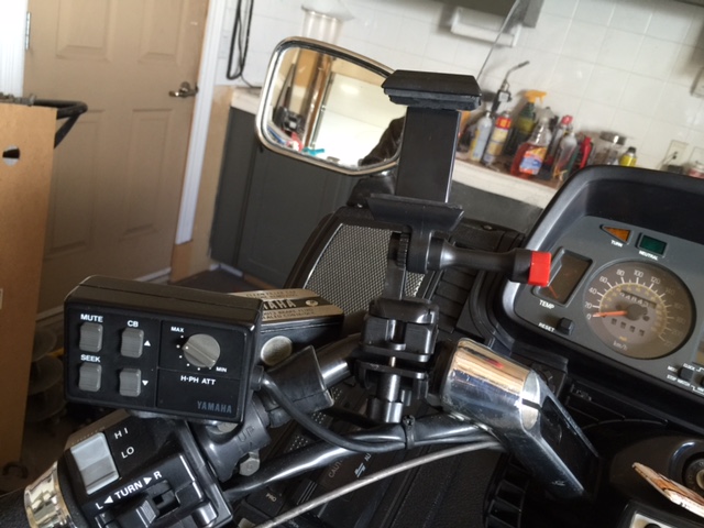

VanRiver Posted February 23, 2015 Posted February 23, 2015 (edited) @Donvito, I use a product called a "Velocity clip" on both my 86 Venture and 84 Goldwing to hold my GPS or Phones. I located it on my left handle bar and it is tall enough to clear the audio control on the Venture. It is a universal mount so your not just restricted to a single application, I hold my GPS, big iPhone 6plus, camera's etc.. I picked it up on Ebay directly from the manufacturer for around $40. Here is a picture and link to the manufacturer: Link to Manufacturer website: Velocity Clip Link to Ebay auction (they were flexible on price when I bought mine by using the "make Offer" button): velocityclip | eBay Pic of the mount: As for wiring....I don't like movable accessories hardwired into my bike.....so I picked up a waterproof USB jack off of eBay and installed that on my Venture....right where a previous owner had installed a cigarette lighter. Most electronics use USB to power them now a days so I can have universal power to all my phones, GPS, or to charge my Sena Bluetooth helmet system. As the guys said no matter what you do, please wire it to the ACC on your bike so it will be switched power and not constant to prevent battery drain. Edited February 23, 2015 by VanRiver

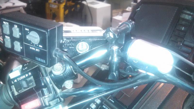

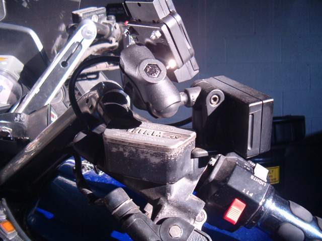

MiCarl Posted February 23, 2015 Posted February 23, 2015 Ok, I remembered this when I got to the shop. My mount is a little different than the one I linked earlier. The type mount I have they don't seem to have outside their complete kits. Still, I think the one I showed you should work with the correct arm. Here are a couple pictures of my mount:

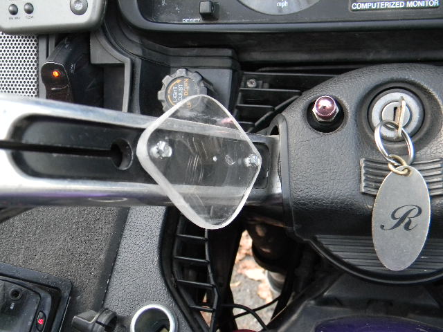

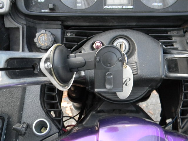

videoarizona Posted February 23, 2015 Posted February 23, 2015 (edited) Vito, I use a simple GoPro clamp mount on the left handle bar at the junction of the 2nd bar. Right around the rubber covering. I can put my GoPro or my Waterproof covered case that will hold my phone or GPS. Right now...I only have the bottom mount on..rest is in trunk. Doesn't interfere with anything and is easy to see at a glance when in GPS mode. I also have a universal clamp mount that fits many type bars and that works on either side as well. I like the GoPro on left...so may put universal on right and use that for the GPS/Phone. Not sure yet. Regarding power. The phone and GPS will require power so I as thinking of putting a DC outlet on the right side "damper" then thread power cord internally on first bar up to the mount at the junction. My concern is making sure the power cable leaves plenty of play for turns yet doesn't snag on anything. Still thinking that through... This is my universal mount.... Me 04B WPCS Universal Motorcycle Bike Handlebar Mount Holder for 4 3" Screen GPS | eBay NOTE: Bought my case from another supplier...under $25. But can't find info... Hope this helps david Edited February 23, 2015 by videoarizona Added note/link changed!
VanRiver Posted February 23, 2015 Posted February 23, 2015 Here is a pic of my "Velocity Clip" on my bike.....it has a quick release so you can detach it and lock it in the truck without needing to take the device out of the holder. The other pic is the bracket that stays behind on the handle bar. But I also really like @videoarizona idea of the go pro mount which seems to be becoming a standard platform now in the market for many cases and gadgets.

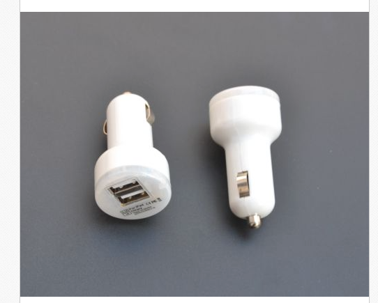

VanRiver Posted February 23, 2015 Posted February 23, 2015 Hi @Donvito, I believe most current GPS units support charging via the USB port...but to be honest I'm not certain about your particular model. How do you charge your GPS in the car currently? Did it come with a special cable for the car? If you already have a cigarette lighter installed on your bike, then you could simply get a converter to plug into that rather then removing it and needing to buy a special unit like I did. These converters are very cheap now a days.....even your local dollar store might sell them: I'm not sure if a USB power supply will work with my Garmin. When I plug it into my car's USB port it doesn't start. Mine has the power supply through the cradle but it also has a mini usb port. If I use my wife's Garmin plug from her GPS to the mini usb jack on my unit, it will start up. I think it needs 5 volts. Do you know if it will work for my unit? If it does, it would be great because I also have a cigarette lighter on my bike that I could remove and install this power supply. I like having another usb for charging a phone or mp3 player. Thanks.

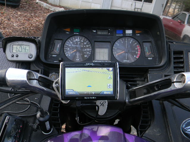

Venturous Randy Posted February 25, 2015 Posted February 25, 2015 On my 1st gen, I made a plate I attached to the left handlebar that I put the GPS suction cup to. I originally did this because I used the GPS in different vehicles, but now it just stays on the bike. I also converted to the plugin in the cigarette lighter with the USB port and that cleaned up my wiring a lot. Randy
