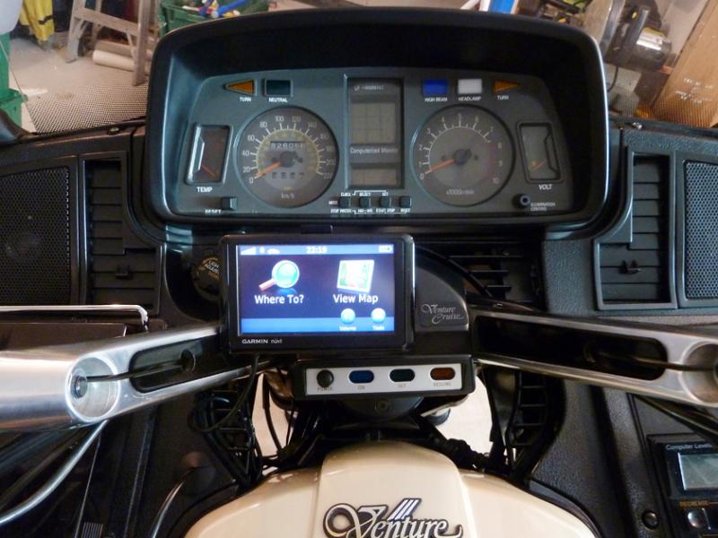

Max Posted February 25, 2015 Posted February 25, 2015 I just purchased a used Garmin 765 and looking for some ideas and advice as to location and mounting method. I intend to wire it in to the electrical system also so if anyone has a preference as to which wiring system is better I would appreciate that also. Thanks. I used the stick-on disc with suction cup going on 4 years. Works ok and doesn't interfere with gauge vis. Issues over that time, had to replace defective power cable once and the suction cup came loose twice. Probably separated because I let the rubber cups dry out over 2-3 months. Lucky that the power cable kept the GPS from totally disconnecting both times for inevitable road kill.

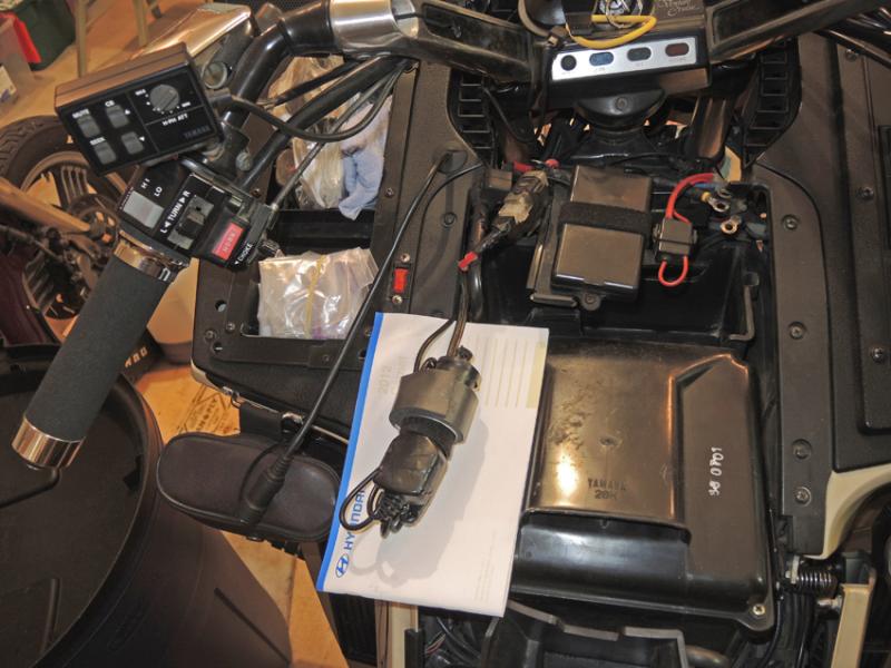

Max Posted February 26, 2015 Posted February 26, 2015 Don, can't attach pic to pm replies. The wiring harness is bundled and rests on the left side of the airbox. The foam wrap buffers vibration and keeps everything in place for the most part. It looks a little bulky in the pic but it's actually an easy fit. Bob's suggestion to wire to acc panel is probably better than my wiring directly to battery with an inline fuse.

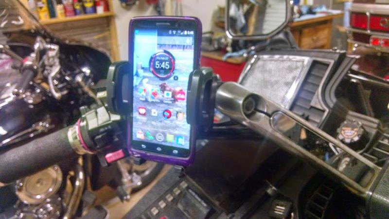

yamagrl Posted February 28, 2015 Posted February 28, 2015 I found this for about 5 bucks on ebay. Works amazingly well. Fits on the handle bar right by the clutch or front brake master. It holds the phone tightly but I still add additional security by wrapping a ponytail-er (rubber band) and a a small ziplock in the rain. Motorcycle Bicycle Bike Cell Phone GPS Support Handlebar Mount Holder Universal | eBay

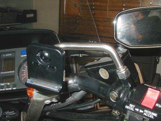

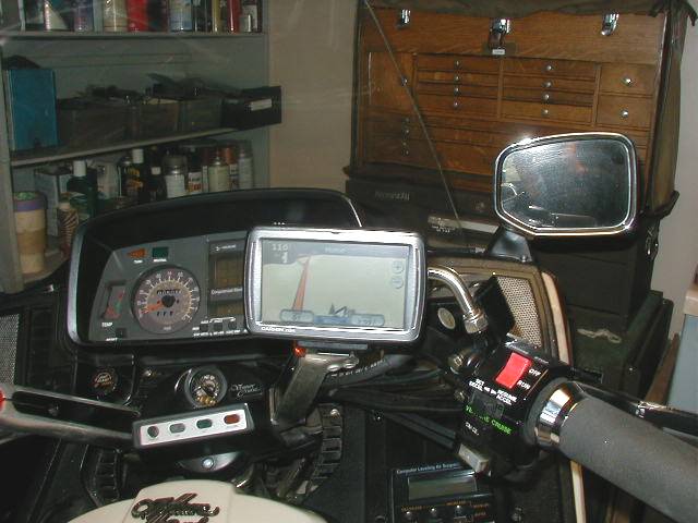

skydoc_17 Posted March 1, 2015 Posted March 1, 2015 Hey Don, I used the right side mirror perch that is not used on the handlebars because of the mirrors being mounted on the fairing. The mount is polished S.S. and I bent it using a torch. I attached a delrin ball to the end of the S.S. stem.This mount is clean looking, and works perfectly. Here are some pics of the mount:
Donvito Posted March 1, 2015 Author Posted March 1, 2015 Hey Don, I used the right side mirror perch that is not used on the handlebars because of the mirrors being mounted on the fairing. The mount is polished S.S. and I bent it using a torch. I attached a delrin ball to the end of the S.S. stem.This mount is clean looking, and works perfectly.[ATTACH=CONFIG]97860[/ATTACH][ATTACH=CONFIG]97861[/ATTACH] Here are some pics of the mount: I've owned the bike for over 25 years and I never knew that was there. Thanks for that info. I think Ram has something that will screw into that. That's a neat set up. Nice job!!

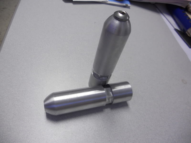

Bob Myers Posted March 1, 2015 Posted March 1, 2015 I just purchased a used Garmin 765 and looking for some ideas and advice as to location and mounting method. I intend to wire it in to the electrical system also so if anyone has a preference as to which wiring system is better I would appreciate that also. Thanks. These are the snagglestuds that were referred to earlier. Remove the nut that secures the upper handlebar and replace with this. One is drilled and tapped for ¼-20 if you so desire
