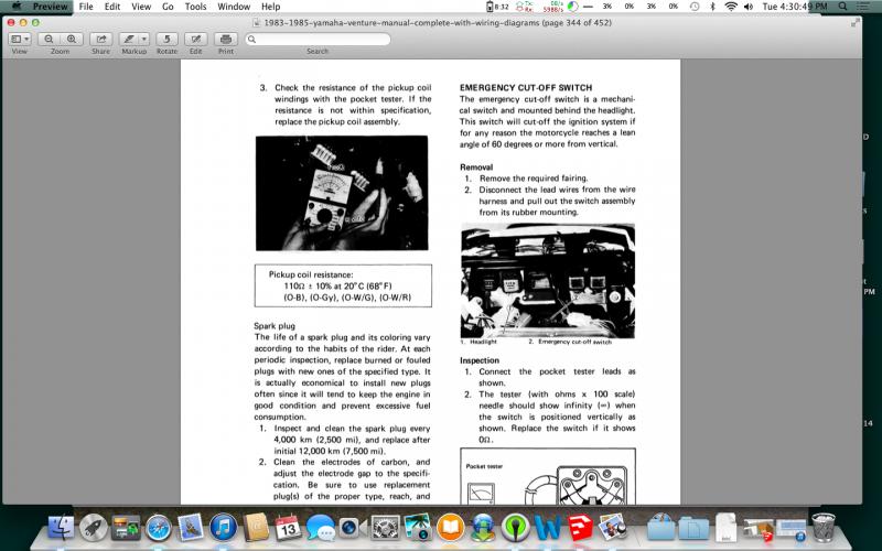

Also went back and checked the pickup coils for the ignition. The Book shows "O" orange as the ground, but the schematic clearly shows black as the ground. They all checked out at around 120Ω. Just going back over this because of the bad readings I had before.

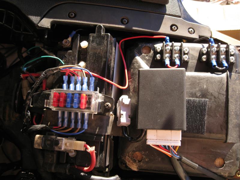

Well, got the fuse panel replaced - thanks to skydoc_17 for the kit - and wires on the six- and eight-pin plugs replaced. I'm also going to convert to COPs as soon as the Vmax guy gets the harnesses done. I know the coils took a lot of water so I'm getting rid of them, hopefully that cures the farting the engine does at idle (although in bike years it's twice as old as me, which would cover the farting:backinmyday:).
About a year ago I went through a problem with low voltage. There was insufficient voltage getting to the fuel pump relay so the relay would not activate and engage the pump causing the bike not to start and to stall.
In addition to replacing the fuse box, I cleaned every contact behind the headlight and also the run/stop switch on the handlebar. This fixed the fuel pump issue, but it also seemed to solve some other minor issues and now the bike is running great and the mpg is back to where it was when new.
Well, good news. Since the rewire and new fuse box, my voltage is now showing 14.05v at idle, and 13.95 at 3000 rpm and up, so much better. Let the bike run till the fan kicked on and never missed a beat. I'll put it all back together tomorrow and take it around the neighborhood a bunch of times before Venture -ing out for a real ride. If all goes well I'll let y'all know. Thanks to everyone for the assistance. Again.
