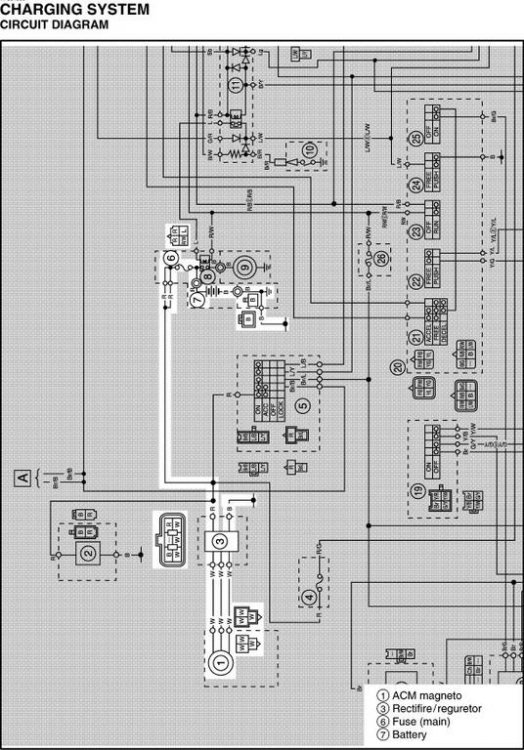

gggGary Posted July 31, 2017 Posted July 31, 2017 Great thorough set of tests. What I don't see, battery voltage after it's been shore charged, battery voltage 5 hours later, voltage at battery terminals; at idle at 2K rpm at 3K rpm check those voltages again with neg lead on a frame ground point. report. Will go look at the diagrams but if your tests indicate the battery and grounds are good and it's not charging, then there is a way to bypass the regulator function and make the stator put out full output, this should only be done for a minute or so and avoid revving motor to produce more than 15 volts. This would pretty much lay it at the door of a defective regulator.

gggGary Posted July 31, 2017 Posted July 31, 2017 No biggie either way, do the resting battery test then start the bike and do the voltage while running tests. or do the running tests then the resting battery test later. The charging diagram, really no way to "jumper" the regulator to force full charging.
