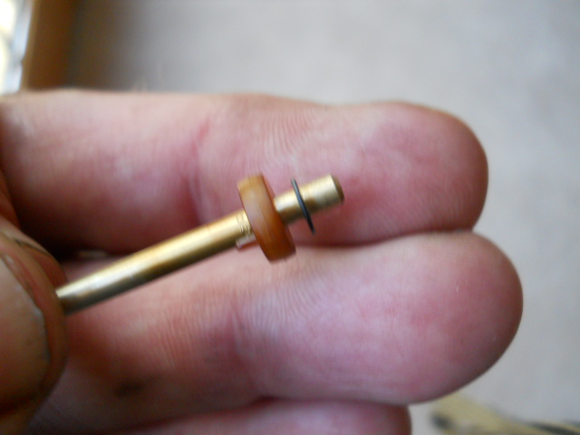

Old Tweeks (our 83) is well over 200k on her, getting her ready for headin west - carbs synced up nice, new plugs yada dee yada.. Dont have access to an exhaust sniffer but using my built in one (nose) I KNOW she is running rich and MPG is suffering.. Pulled the diaphrams (again) and noticing more fuel gathering on the slides than I like.. Not spot of drippage on the float overflows..
Anyway, because of her mileage (yea, ok,, maybe even a little abuse) I am suspecting that the slide metering rod orvices may be oblonged a little.. I know I read on here recently about dropping the metering rods down 1 mm to lean down a little.. Have done many many carb adjustments like this through the years and was expecting a typical multinotched metering rod for the circlip on this 83.. Found out this is not so on these carbs - see pic..
So,, how do ya adjust the needle depth on these puppies (see pic).. Use washer/shim rings from differnent needle set up??
Thanks in advance ya bunch a lop eared gearheads!!
Yeah, washer shims.
I think someone provided the proper washers on here. Maybe Skydoc or Dingy?:confused24:
Apparently the Canadian market Ventures came with the adjustable needles (with notches).
But, 1983 needles (left in picture) are different in profile from the 1300 needles (right in picture). So be careful what year you get the Canadian needles from.
http://www.venturers.org/Forum/download/file.php?id=10581

Puc,
First thing you should do is check the fuel level in the bowls. If those are spot on you can look at the needle jets/jet needles.
Skydoc17 sells a kit to lower the needles. My 89 was getting mpg in the low 30s. After ruling everything else out I put in Skydoc's kit. Last ride I got 40mpg.
When I lowered the needles I needed to richen the idle mixtures some.

Now I'll have to dig into my memory (I did this early spring). Numbers not guaranteed....
I had guessed I might need to drop them 20 - 40/1000". I asked a machinist I know to make me a set at -0.060" from stock. I've got a box of 0.020" washers that I figured I could use to richen it back up from the -60.
Then I decided to order Skydoc's kit to see what he was doing. I believe his shims measured at -0.060" from stock so I put them in and asked the machinist to not bother. I like my results (plugs look good) at -0.060" so I've left it there.
I did a full sync and set the mixtures. Unfortunately I did not pay attention to how much I backed them out.
BTW, 0.060" ~ 1.5mm.
It is definitely lean just off idle. Until it's good and warmed up it's got a bit of a flat spot. The days of starting it up and immediately turning the choke off are gone.
Does it run hotter? No - the thermostat still keeps the temp where it belongs. If I get into traffic where I'm not moving a lot of air it does seem like the needle climbs faster. Can't say for sure though.
Going by the plug color it's not lean in normal operation - they look like perfect wheat toast. My guess is it's just off idle where it is lean at all.

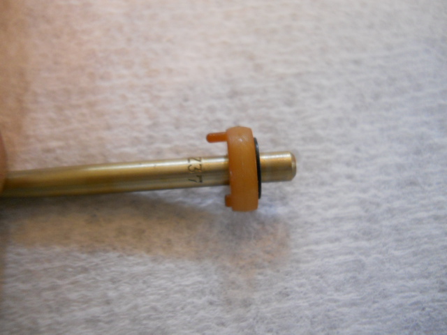

Ok,, here is what I am in the process of trying.. No money, very little time, and fairly easy to do..
If you look at the pics below notice the stock plastic shim on the needle.. It has a round, what I am gonna call a locating pin that sticks out of the bottom of the shim.. On the opposite side of the shim from the locating dowl/pin is a small protruding edge the sits internally on the surface of the slide.. Measuring the protrusion yeilded .024 (24 thou) of protrusion.. I took a razor knife and nocked that protusion off, dropping the needle 24 thou on all of them.. Its been raining here so I havent had a chance to do a mileage check on it but I did run it around the block, noticed a small 200 rpm change in my idle - no starvation lag coming off idle.. I have lots of xtra carb parts - I plan to take another set of the same stock shims, nock the protrusion off and file off another 20 thou from the top of the shims and test those too just for comparison.. Creeping my way to the edge of where Carl had to rejet the pilot but staying on this side of the line so I dont have to,, I love experimenting. It would be pretty cool if just nocking off the protusions showed gain in MPG - will let everyone know..
Looking at the protustion itself makes one wonder exactly why the Yamaha engineers put it there in the first place.. First thing that popped into my mind was I wonder if it had to do with emissions - maybe the California bikes had to be run leaner to pass emissions and this little nub is not present on their bikes.. Anyone have any thoughts or ever heard anything about it?? I am not refering to the locating pin here,, there is a line up hole in the slide bottom that you have to make sure you locate the pin into for that - the pin has a definite reason for being there.. The smaller nub,, not so much, it just sets on the inside bottom of the slide raising the needle 24 thou..
If this works it would be a VERY easy lazy mans way for pulling out some fatness.. Hey,, even a couple mile per gallon and I will be SMILING!!

The only possible reason I see for the pin is to orient the protrusion. They wanted that protrusion in a particular spot for some reason. The kit from Skydoc has neither the pin nor the protrusion.
Next time you pull them apart make sure the pin doesn't stick through the bottom of the slide. You don't want that guy stirring up the air flow.

It's been my understanding that the small 'post' was designed to cause the needle to be offset in the jet orofice...... 'kicking' the needle to the side of the jet so as to not run down the middle. Have no idea about the reasoning for this other than to prevent swirling of the fuel like water rushing down a drain.

I suspect that there really is a relationship between the pin and the locating tab on the diaphragms. I wonder if anyone has ever looked at this with an unmolested set of carbs and diaphragms. My suspicion is the pin would be on the bottom of the assembly to cause a slight lift on the end of the pin, maybe to center it a little and maybe reduce wear on the pin and jet. I have a set of carbs that appear to have the original diaphragms and if I can remember, I will check this out.
I did the shim thing on my carbs several years ago and played around with different thicknesses and worked through some hesitation and responsiveness until I got what I wanted. I used to be happy if I ever saw 40mpg and now I am wondering what is wrong. With being very careful with not lugging the bike, I have seen as good as 50mpg and this is without losing any power. This is also with not having the strong fuel smell with the bike idling in the garage for a few minutes.

Pete it sure makes sense that the post could/would do exactly that and be for exactly what your talking about - good point!!
On the other hand,, it sure seems like if that were the case the extra side pressure from the needle setting at slight angle would cause excessive wear on orifice and needle doesnt it?

May very well be right on that Randy.. This set of diaphrams are stock and never been off the slide - I will take a check on the locating post hole in the slide and see if thats correct - just to solve a mystery and out of curiosity.. Good point.. The only thing is it seems like .024 would create more than a slight lift,,,, hmmmm,, maybe the lift (or angle that Pete was talking about) is being controlled by the locating pin.. wierd little intreeeging design what ever its for.. It also still seems like any amount of side pressure created by that needle would produce extra wear - not eliminate it....

The reason I use the single Nylon shim instead of S.S. washers is (believe it or not) the stack of S.S. washers weighs three times what the Nylon washer of the right thickness does. This extra weight slows the movement of the Slider and Carb. Diaphragm. After trying about 20 different thicknesses of Nylon shims, the current set I offer gives you the best blend of performance and gas mileage. YOUR wrist action will have a direct effect on the gas mileage part!
