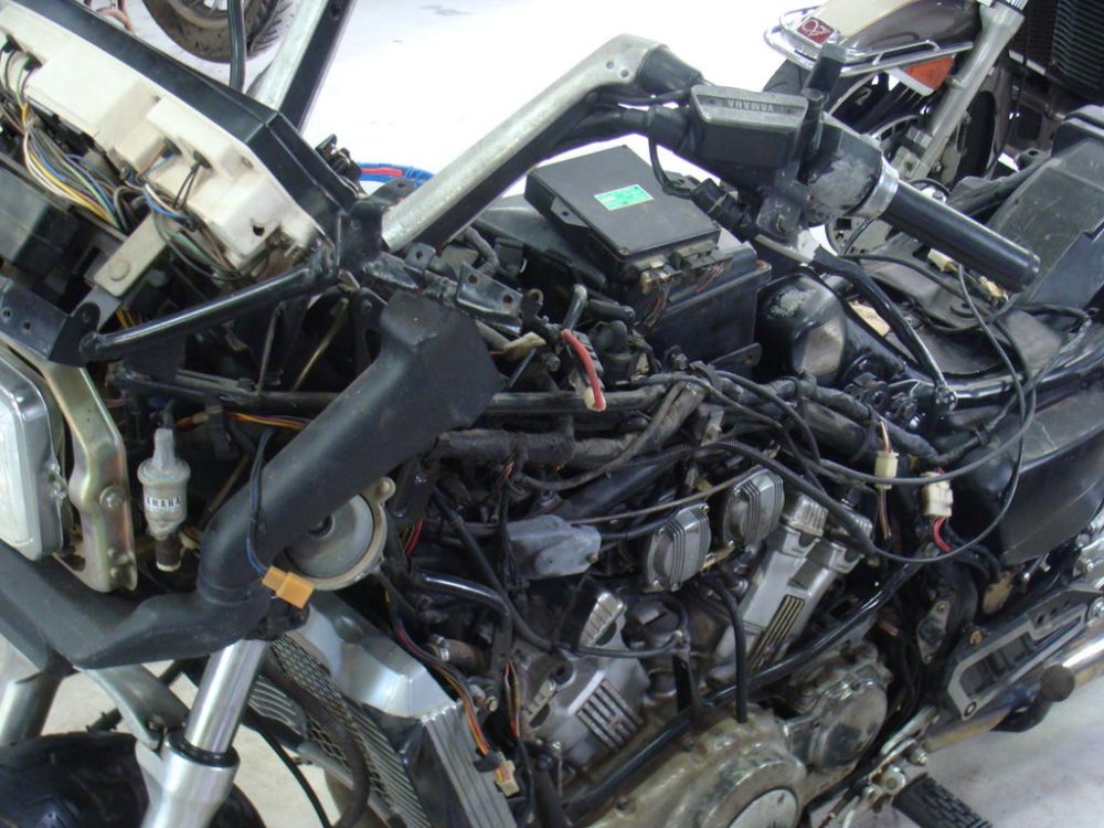

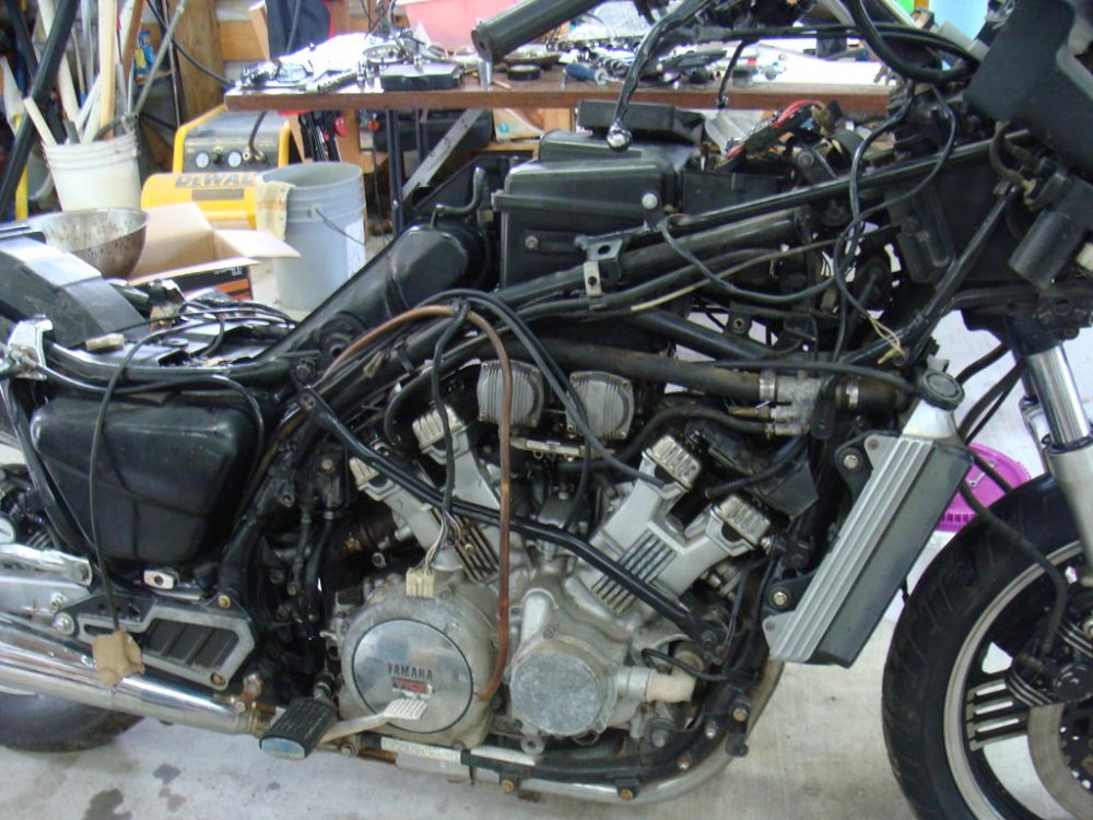

You were right, the rear bulbs were replaced with LEDS. Found short in the wiring for the rear running lights (PO) had pushed wire together and then used shrink wrap just before fuse connection. Throttle cable was frayed on the small pull cable to the carbs. Have one on order. I believe that was the problem with the cruise control too.
Had some health problems since starting this but finally got back on it in short periods. Finally found that the intake valves on number 2 cylinder were carboned up and not sealing. Had very low compression on that cylinder. Hooked up air line to the hose on the compression tester and had real good air flow back thru the carb. Pulled front head and lapped the valves and then treated the rings with some marvel mystery oil and the compression came much back up. I still was not getting heat on the exhaust pipe #2 , and very low vacuum when trying to sync carbs. So pulled carbs and cleaned (PO had them professionally cleaned) and I found two carbs had the idle jets plugged. While there I replaced the o rings under the intake boots. Runs much better now. Now I’ve got to work on the tail light indicator, comes on when I use the brakes. The cruise control won’t set and the CB turns on but I don’t hear it transmit, and the throttle doesn’t return as it should.
