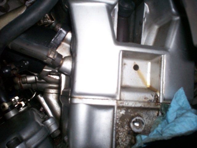

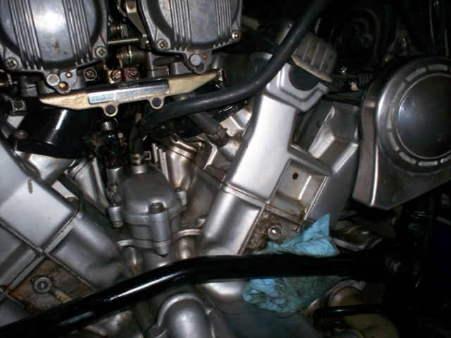

Thanks, the gasket on the valve cover has a rolled area in the ubend area but I did not see any large leak from there. I'll get her fixed. Thanks again. -
Got to put a few miles on the 85 Royale I'm renovating. Have an oil leak that shows up after it warmed up. It is under the retanglaur cover on the side of the engine that covers the plug for the water jacket to the cylinders. Don't believe it's suppose to leak here. It the front right cylinder. Was warmed up and checking the carb sync and noticed the oil leaking from here. Don't believe that right any ideas? Pulled the cover off the right rear cylinder and did not have the same problem.
