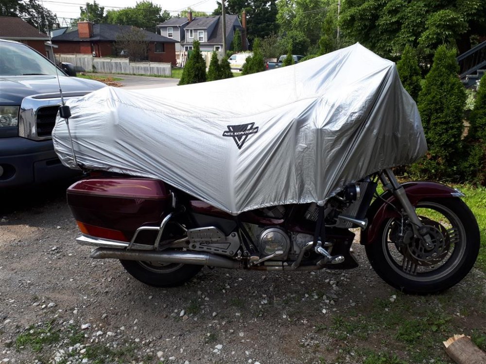

@luvmy40 I have had a few covers. My favorite out of the bunch so far has been the Nelson Rigg both in the full cover and Half cover. The X-Large Nelson Rigg UV-2000 half cover fits my Gen1, MK2 like it was custom fitted.
