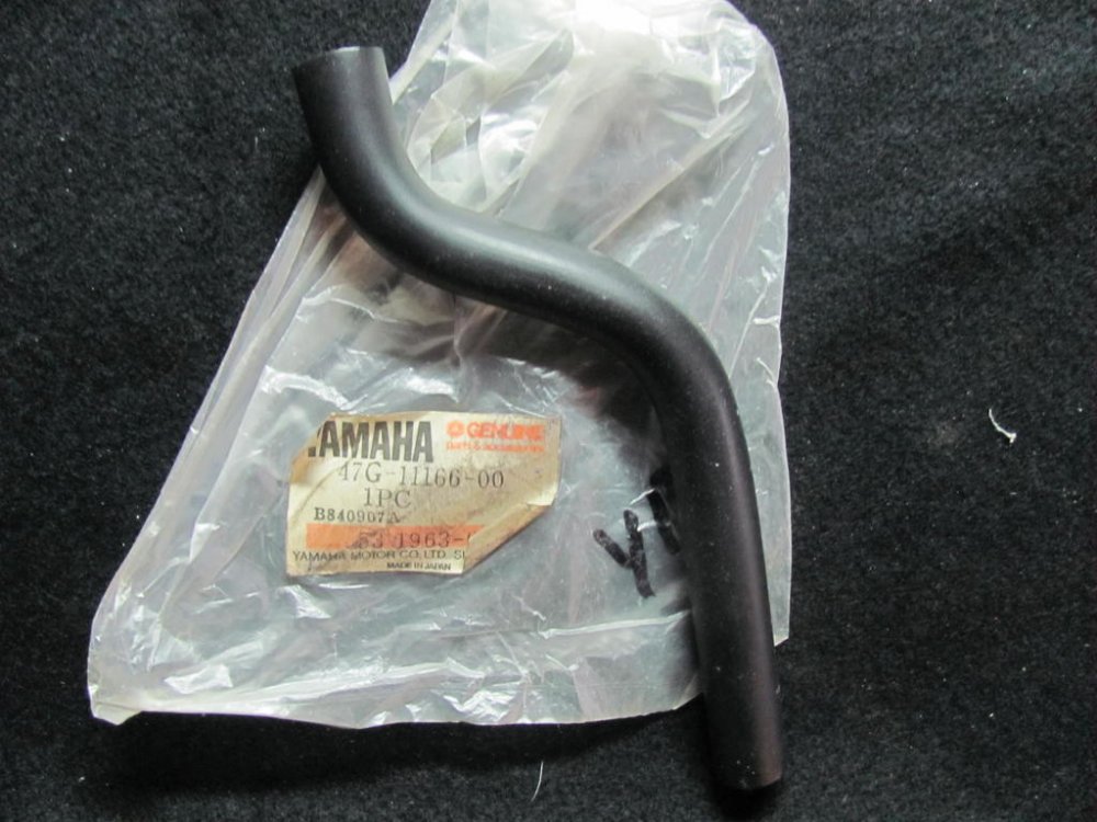

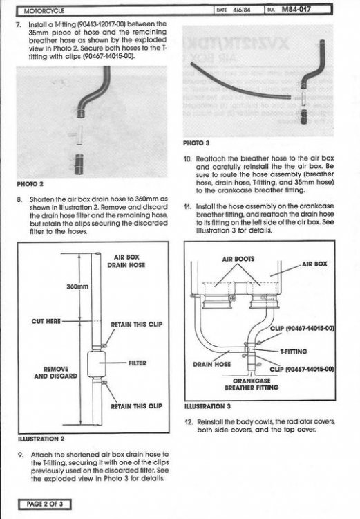

	If I understand correctly, you are looking for the hose that goes from a T fitting just above the twinkie to the larger nipple on the bottom of the air cleaner? That breather hose is part number 47G-11166-00. Apparently no longer available from Yamaha, although there are several NOS on eBay. https://www.ebay.com/itm/84-93-Yamaha-Venture-Breather-1-Pipe-47G-11166-00-00-NOS/231520523300?epid=1811796370&hash=item35e7b2d424:g:JewAAOSw-7RVGxjQ You said that the hose you needed was part number 90445-11699-00, however. That small diameter hose originally ran from the smaller nipple on the bottom of the air cleaner to an inline filter and then to atmosphere. This arrangement for the air cleaner oil drain was only on the 1983 and was subsequently scrapped on later models and in fact there is a Tech Bulletin outlining a modification to be made, that would eliminate the drain filter and route the hose to a T fitting on the twinkie. M84-017 Air Box Oil Leakage M84-017.pdf

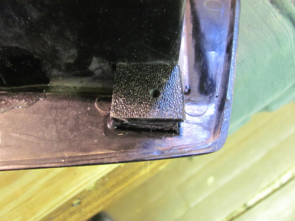

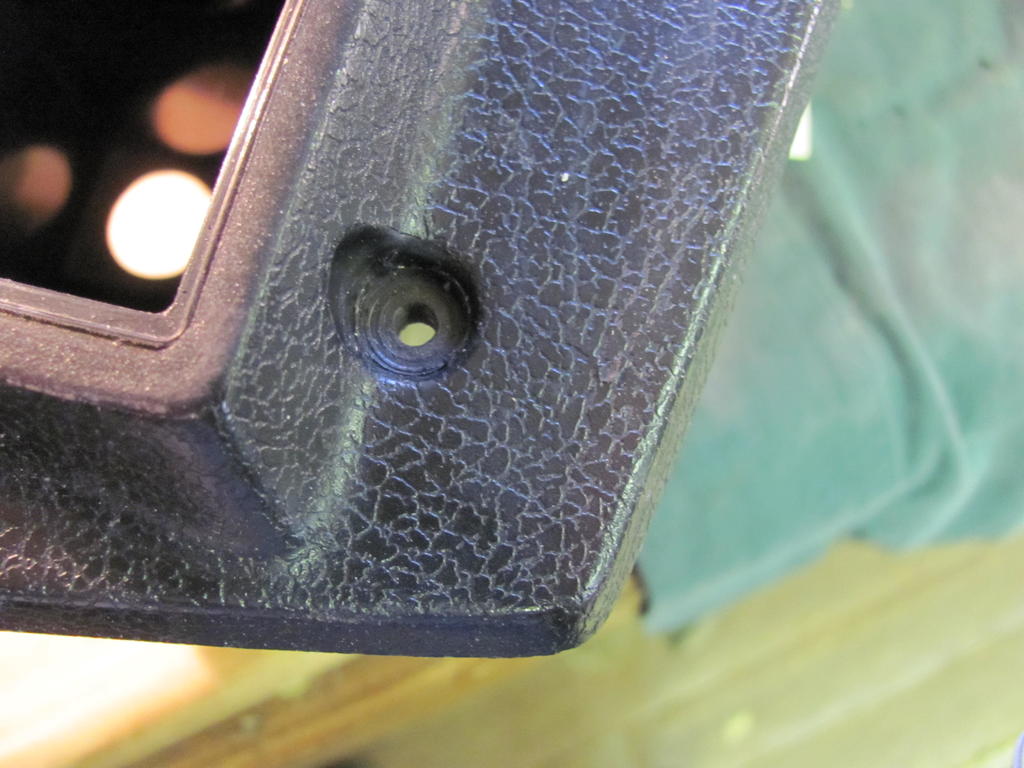

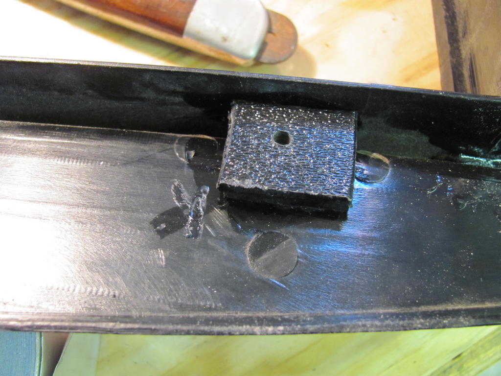

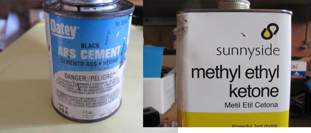

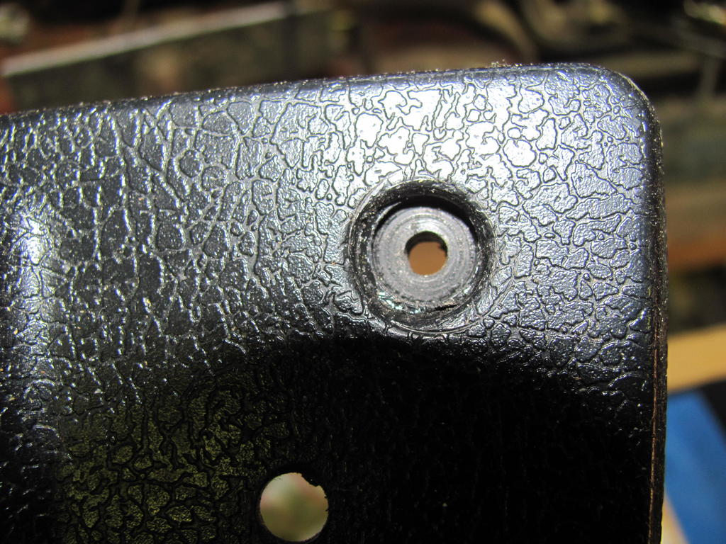

ABS cement along with MEK solvent will work very well for virtually any plastic on the Venture (all the plastic is ABS). Cracks without missing pieces can be repaired easily; the repair can be nearly invisible (if the cement and reinforcement is applied to the back side). On your terminal panel, I notice that all the recessed mounting holes are broken. Very common, but easily repaired to better than new. 1. Shave or grind down until flush the remnants of the broken out recessed bosses. 2. Cut a few squares of 1/8" thick ABS from a sheet of ABS. 3. Bond the squares of ABS to the leveled backside of the panel with ABS cement. Bond two layers of 1/8" ABS to equal approximately 1/4" build up. 4. Using a Forstner bit sized to fit within the recess, bore down through one layer of newly applied ABS. 5. Use a twist drill of a size appropriate for the 4mm recessed hex screw and drill a through hole. Some photos of my Terminal Panel repair: -

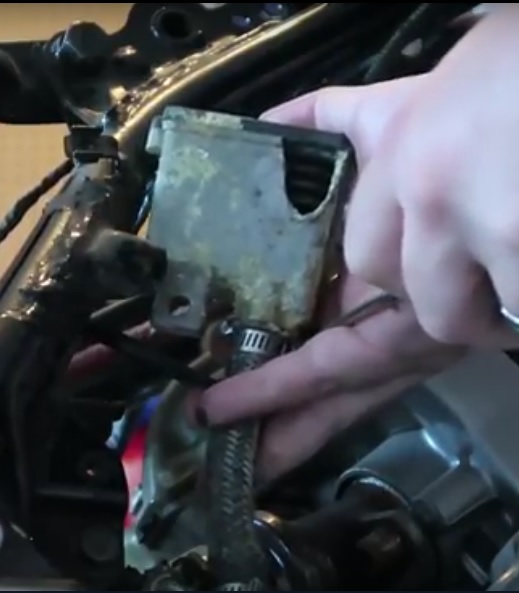

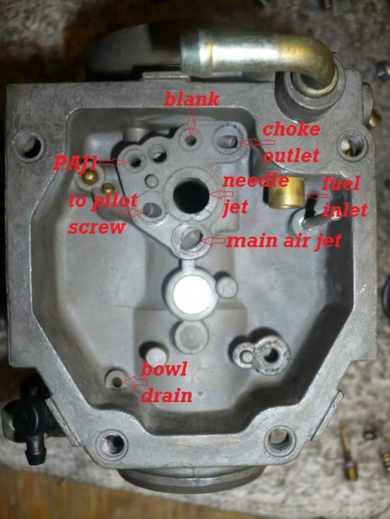

That plug is the cap for the float valve seat with net filter. The cap has an O-ring. Looking at the pic, it appears that the cap has been replaced (the original cap was staked into the carb body, but the new one has not been staked to secure it). -

	The purpose of this factory mod was to drain oil that accumulated in the airbox, back to the crankcase. On the 1983's the smaller tube from the airbox drained any accumulated oil to the ground under the left crankcase, through a small inline filter. The larger tube between the airbox and the "twinkie" was only for crankcase ventilation, (think PCV). If the crankcase was not overfilled with oil, there was usually no oil accumulating in the airbox. The trouble with oil in the airbox was that Yamaha specified an excessive amount of oil to be added to the crankcase after an oil and filter change. M84-017 Air Box Oil Leakage .pdf

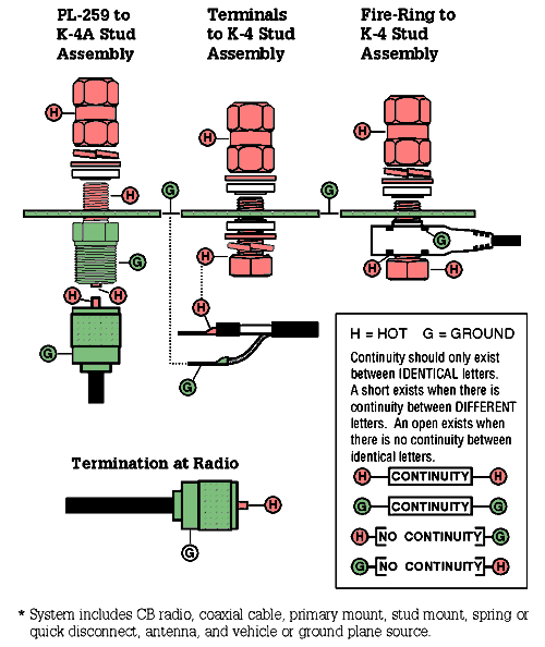

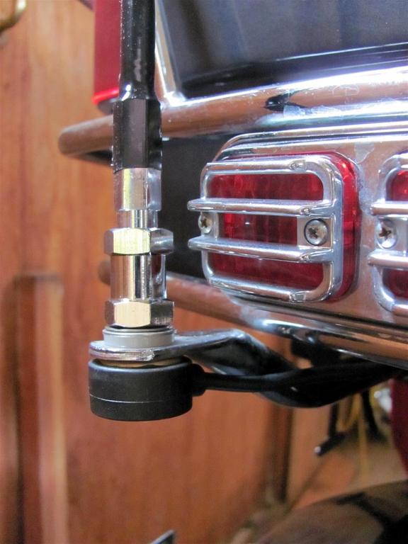

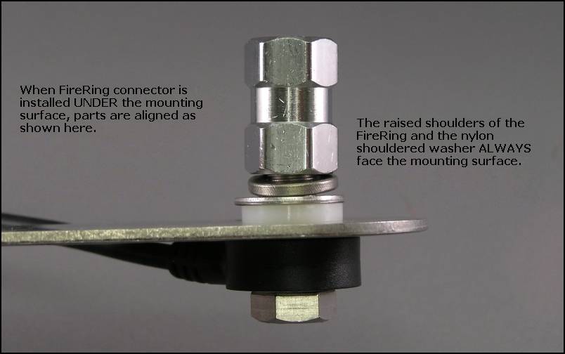

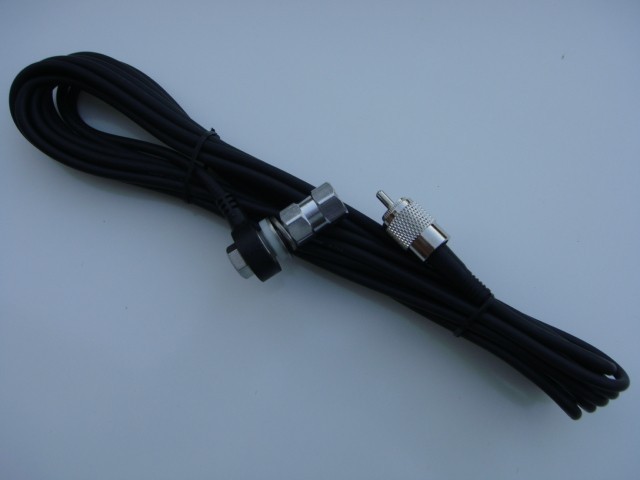

	There is a very compact CB antennae base that provides a 90° connection for the coax cable. It is called Firering. I used it in combination with a Firestick on my First Gen.
